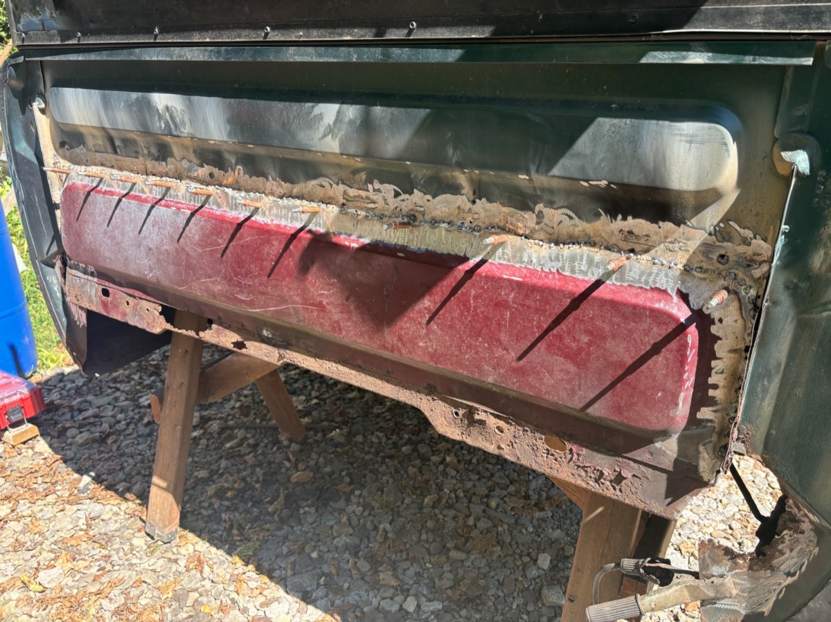

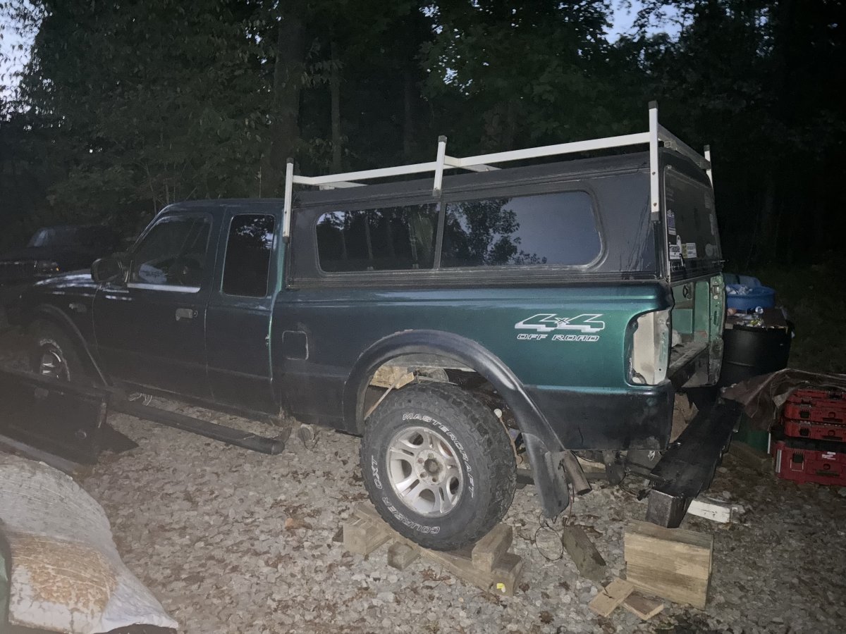

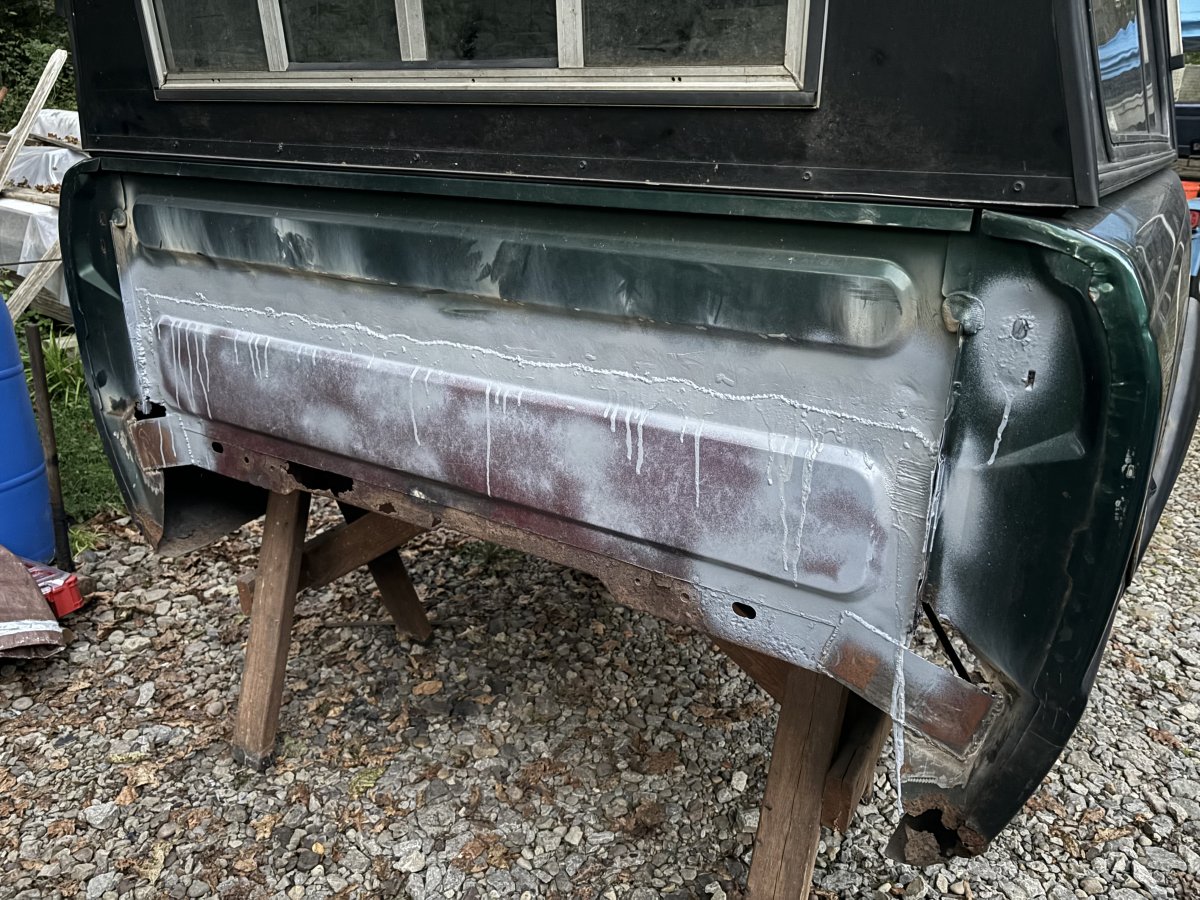

Yesterday I got a little more done on the green Ranger. Ended up having some help so the bed got fully set off and is mostly patched now. Or almost as much patching as I’m willing to do to a bed that’s nearly junk. Bumper is on wood blocks under the back of the Ranger, gotta get it adjusted, holes marked and drilled and then mounted. That’s today’s project because I can get help getting the bed back on later. Traction bars are on, I had to persuade the one with a sledgehammer to get it lined up. Wiring mostly just needs loomed and plugged in.
So, I was trying to get stuff ready to put the bed on and I was looking at the patch on the bed and it didn’t look right. It’s the front panel, and I had a simple idea that would work to line everything up by cutting the bed below the top of the lower bulge and cut the donor piece reverse of that, so the bulge could be used to locate the donor piece. Mr certified welder that “helped” yesterday managed to weld it up 3/4” out from one side to the other. So I got to undo everything he did and start to do it correctly.
Then dad decided to help so I had him drilling some holes for lights and stuff in the bumper and somehow he managed to drill them all at an angle. Not real thrilled about filling them with the welder and re-drilling, but that may have to happen.
Which means the Choptop most likely will not be making it to the 25th. I just don’t see having enough time to finish fixing the Ranger (the bed has to be on tomorrow or I lose all of my help), and fix both axles in the Choptop. Theoretically I could have the Ranger done tomorrow and fix the Choptop Wednesday and drive down Thursday. In theory, it’s possible. If nothing else goes wrong. I’m not sure where my magic wand wandered off to this time though.
The good news is that my Ranger should be in ok shape though. I’m interested in seeing what the traction bars and fixing my oxygen sensors being wired up backwards does for fuel economy and performance.
