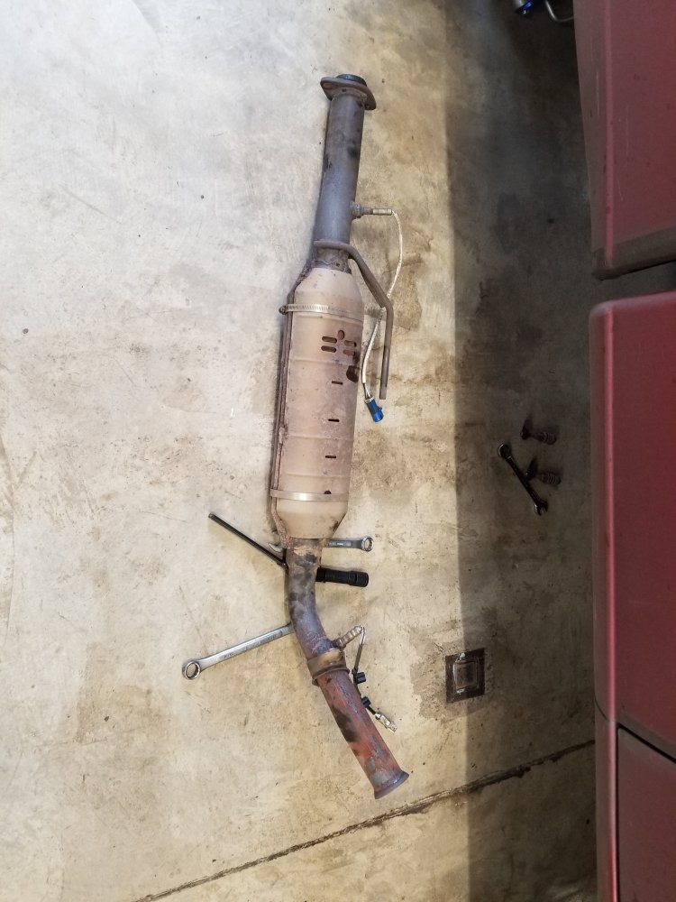

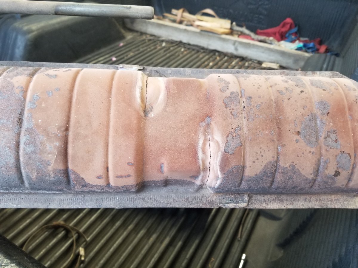

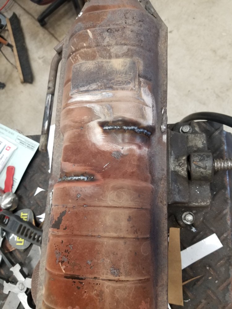

For me Ranger related I pulled the '97 into the shop to pull the exhaust to figure out the exhaust leak. Jacked up the passenger side and confirmed it was coming from the catalyst. Sprayed the 4 bolts with some lube then let it cool down for a little bit and went for taking it out, to my surprise after 215k and 25 years all 4 bolts came right out with no drama... Cut off the top heat shield and found two cracks, cleaned that and welded it up then welded the heat shield back on then cut the bottom shield off and found two more cracks, rinse and repeat... The welding was successful, it's back to being super quiet, I didn't take any chances and left the hose clamps around the heat shields even though I fixed the welds that were broken... The pic of the non fixed cracks is the top and the one of the welded cracks is the bottom... Could I have done it another way? Sure, would it have been more work and $$? Absolutely...

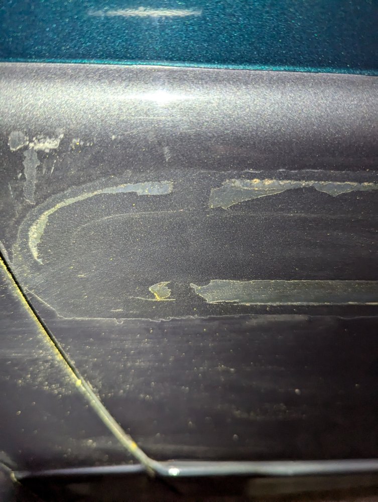

attempting to remove the brittle 30 yr old trim. it's a battle lol. made it about 1/4 through the driver's side panel

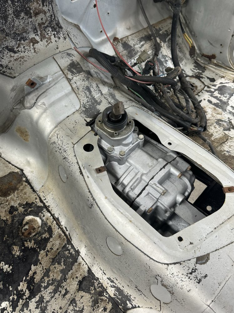

tomorrow i think i'm going to pull the interior out (again) so that i can replace the butyl tape on the rear window as well as install some heat shield under the carpet.

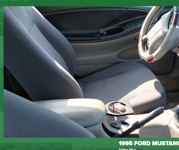

kicking myself b/c i did some more research for replacement seats and realized that the mustang i pulled the rear discs off of last week had PERFECT seats. I didn't realize at the time that they would work and didn't even open the door. 99.9% sure they are gone by now.. they look MINT in this photo

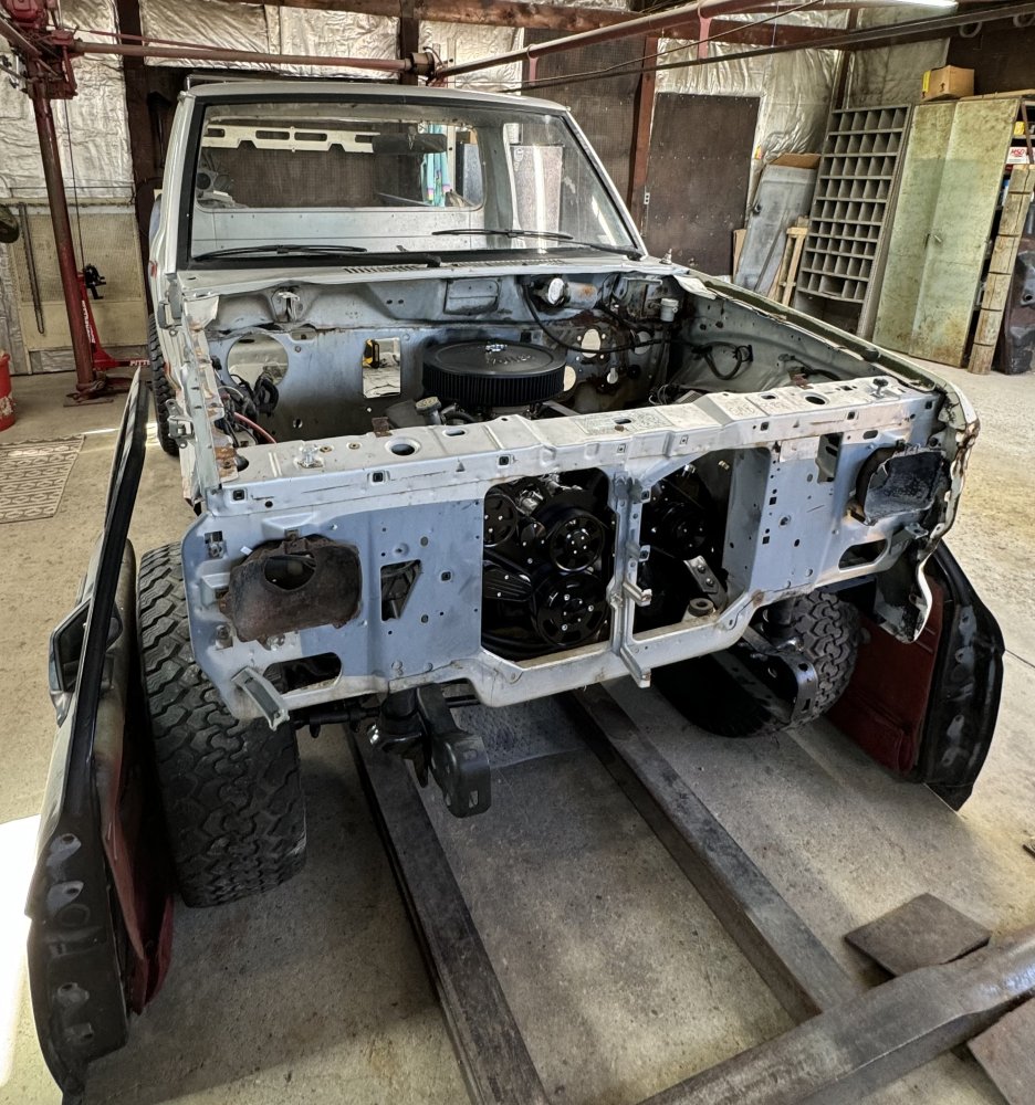

Little more progress on the truck today.
-Bought some cheapo rubber hangers (isolators?) from advance.. tried to get my bung-chaser but they were out of stock -__- so I ordered one of those as well as the last 45° elbow I need off scamazon.
-Post cat o2 bung got welded on.. no plug in it this time.. worked a charm 👍
-Also got the forward exhaust hanger rods welded to the frame & to the exhaust. The rear hanger will be welded to the bit of pipe downstream from the 45° elbow I just ordered.
Chaser & elbow should be here Friday.. so I should finally be able to call the exhaust completed next weekend 🤠 excited to fire it up and see what sort of raucous racket it makes while bouncing off the limiter 👍

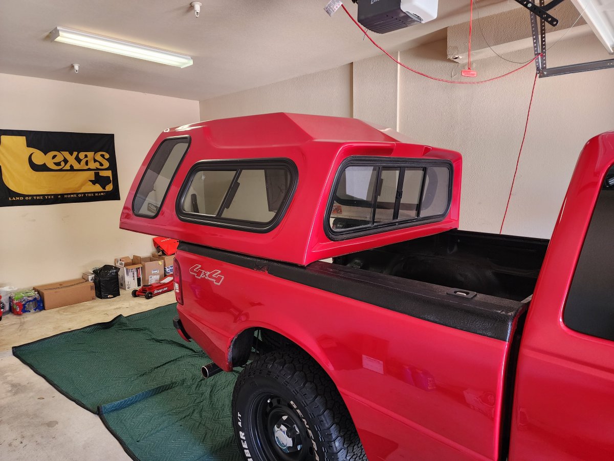

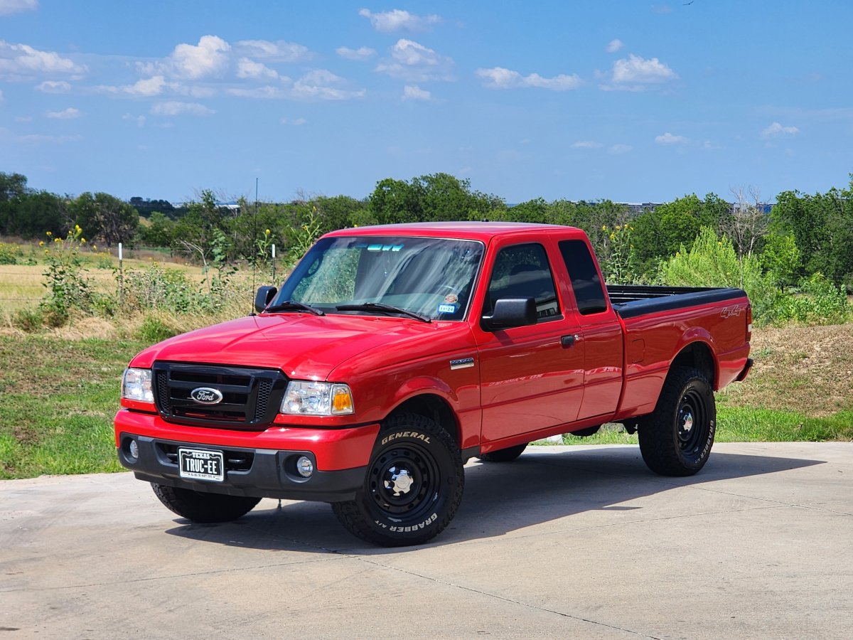

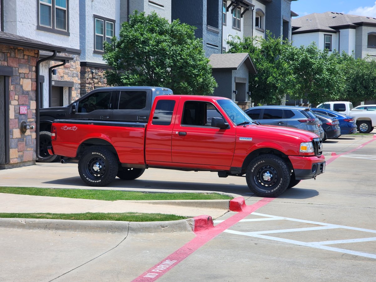

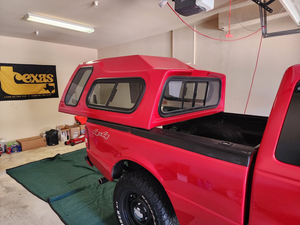

I finally pulled the camper shell off my 2008. I've been on the fence about it for a while but I prefer the real pickup feel of a Ranger.
Not sure what to do with it now. 🤷
View attachment 112578View attachment 112579
I would take but i still have to find a straight bed thats red. I like having both beds so i can swap them as needed.
A stepside camper in red is apparently unobtainable anymore. And finding a stepside camper in any color is just one atep down
