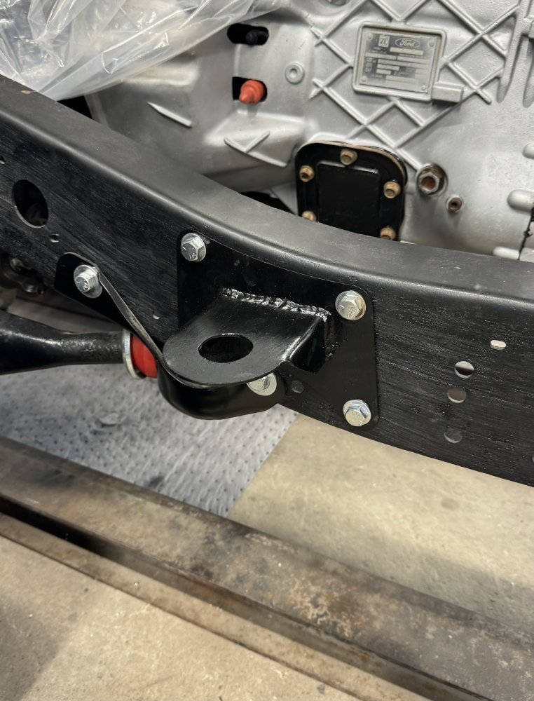

Fabbed and painted my front cab mounts. Fuel filler neck shows up today and I’ve got the bed on standby to be set soon after filler neck is installed. Just need to get a case of beer and a few buddy’s to help set it in place. Aiming to be driving test trials by Labor Day.

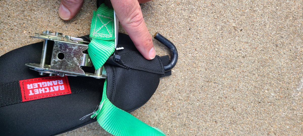

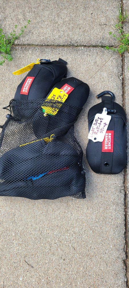

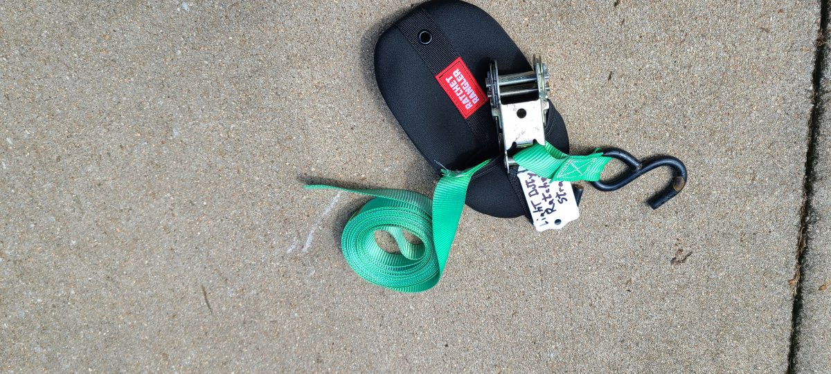

At the Moore Expo, I found these little pouches called Ratchet Ranglers. They keep your ratchet straps from becoming a tangled mess in the vehicle. I bought some at the Expo and ordered a bunch more later. Still need a few to finish all my straps. The pictures should explain it pretty well. But I think there's a video on their website. $20 for a set of 3. I ordered the plastic label tags from Amazon so I could label them since I'm using some to contain rollercam straps and I also have some pouches designated for motorcycle tie-down stuff.
One complete ratchet strap assembly fits in a pouch.
The hook for the strap can poke through a hole at the top. This helps maintain control of the hook.

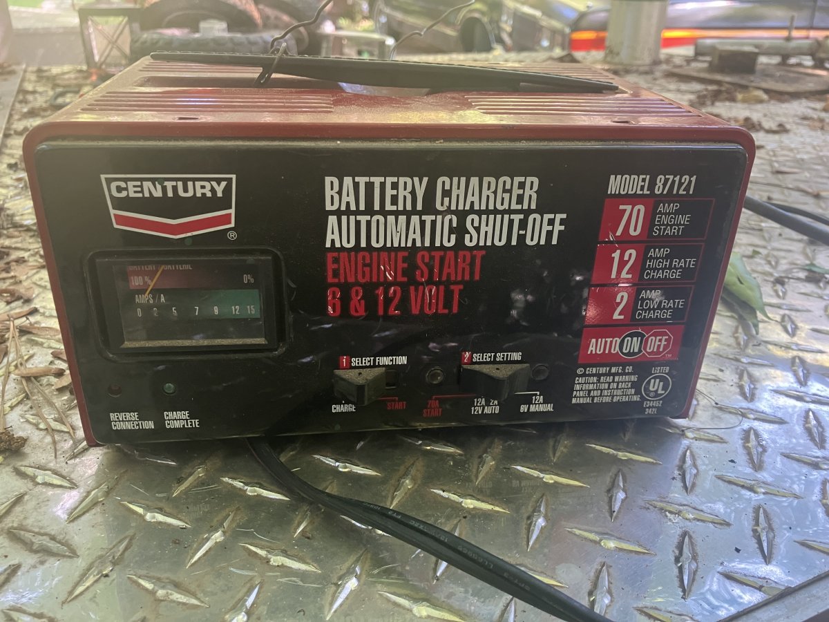

I mentioned the really good diehard gold battery charger I bought a few years ago. It’s really great, but it’s also $200 out the door.
I have a Sears style 2/12/jump starter that I’ve had for 40 years. It still works great, but it shuts down once the battery is topped off, and if you leave it alone, the battery may go dead again. You have to disconnected and reconnected and then it will charge again. It’s not really smart, and won’t maintain a trickle. But when I have to do a quick charge, and I set it on the 12 amp setting, it really does a great job in a few hours.

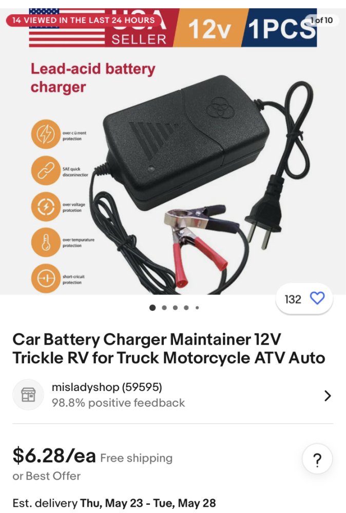

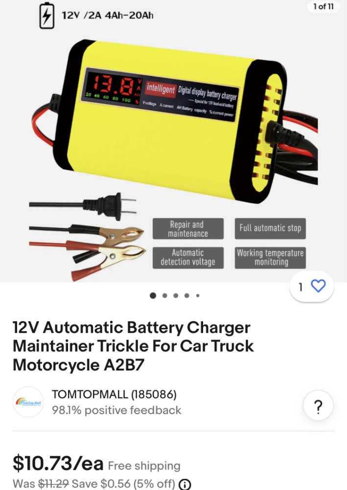

Day to day I use these two for trickle chargers
The black one is only six or seven dollars, and I’ve never had it fail maintaining charge on a decent battery. I’ve had four or five of them, and I’m using two or three all the time. It’s a maintainer, not a charger.
The yellow one is like 10 or $12, but it shows you the voltage of the battery, the voltage of the charge when it’s connected, and also shows you the percent charged. It will actually charge a dead battery, but it takes twice as long as a “real” battery charger. I have three of these right now that I use regularly.
The only issue with the two of them is they work great until they don’t work. They die out of the blue, but I’ve never had one die in less than a year or two.
I highly recommend both for a trickle charging duty. You can also buy both in sets of four or five, and get an even better price. I got mine off eBay.

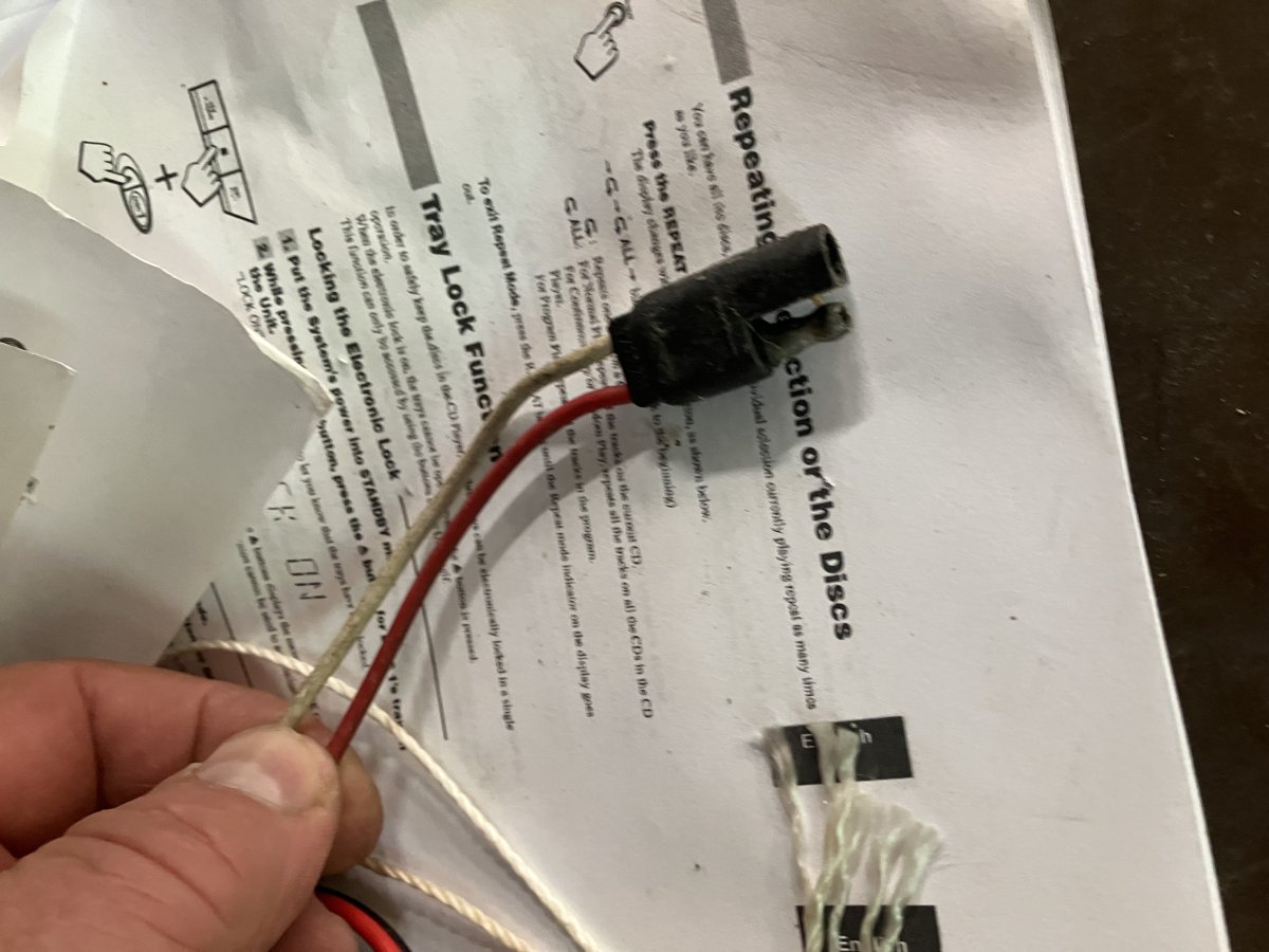

One last thought, after I check them out for a few days, I clip the clamps off and put one of these connectors in the middle
I put the matching connector on the clamps, but all my vehicles have one of these hanging off the battery as a pigtail, underneath the grill or somewhere easy to get at. So, when I park something, I don’t even have to pop the hood to put it on the trickle.
As always, hope it helps
EDIT: when I clip the clamps off and put the two pin connector on, I also add six or 8 feet of length. That way I can easily connect it, but I can put the charger as software. It’s easy to see and/or out of the weather.

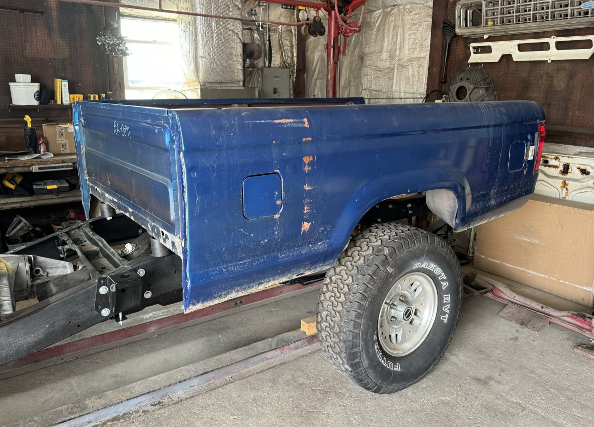

Set my bed. Using a 3” body lift to clear my trans resulting in fuel filler neck being short of the gas door by 2”. Any solutions for this? I can make a drop flange if need be
