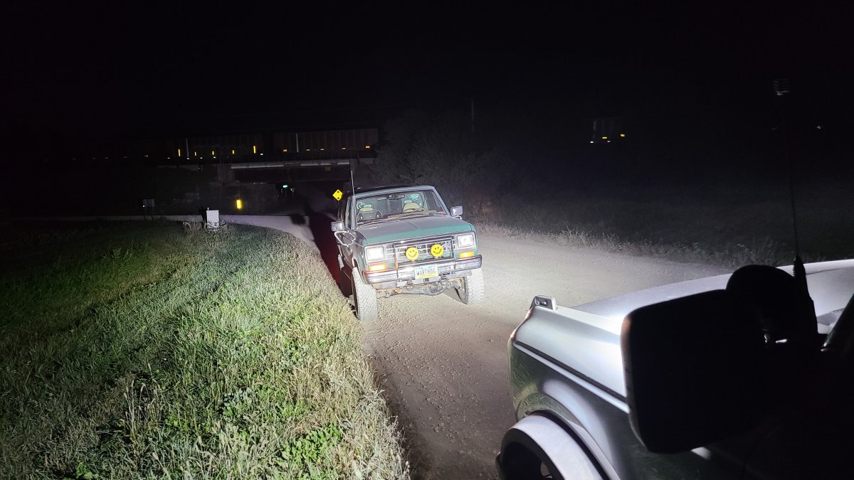

Last night's adventure coming back from my brother's bachelor part...
Lost key 12v to the ignition module. Wiring issue in the rad support somewhere. Called in the calvary, got it running with a jumper wire and slowly sneaked it home. Tonight I tear into it...

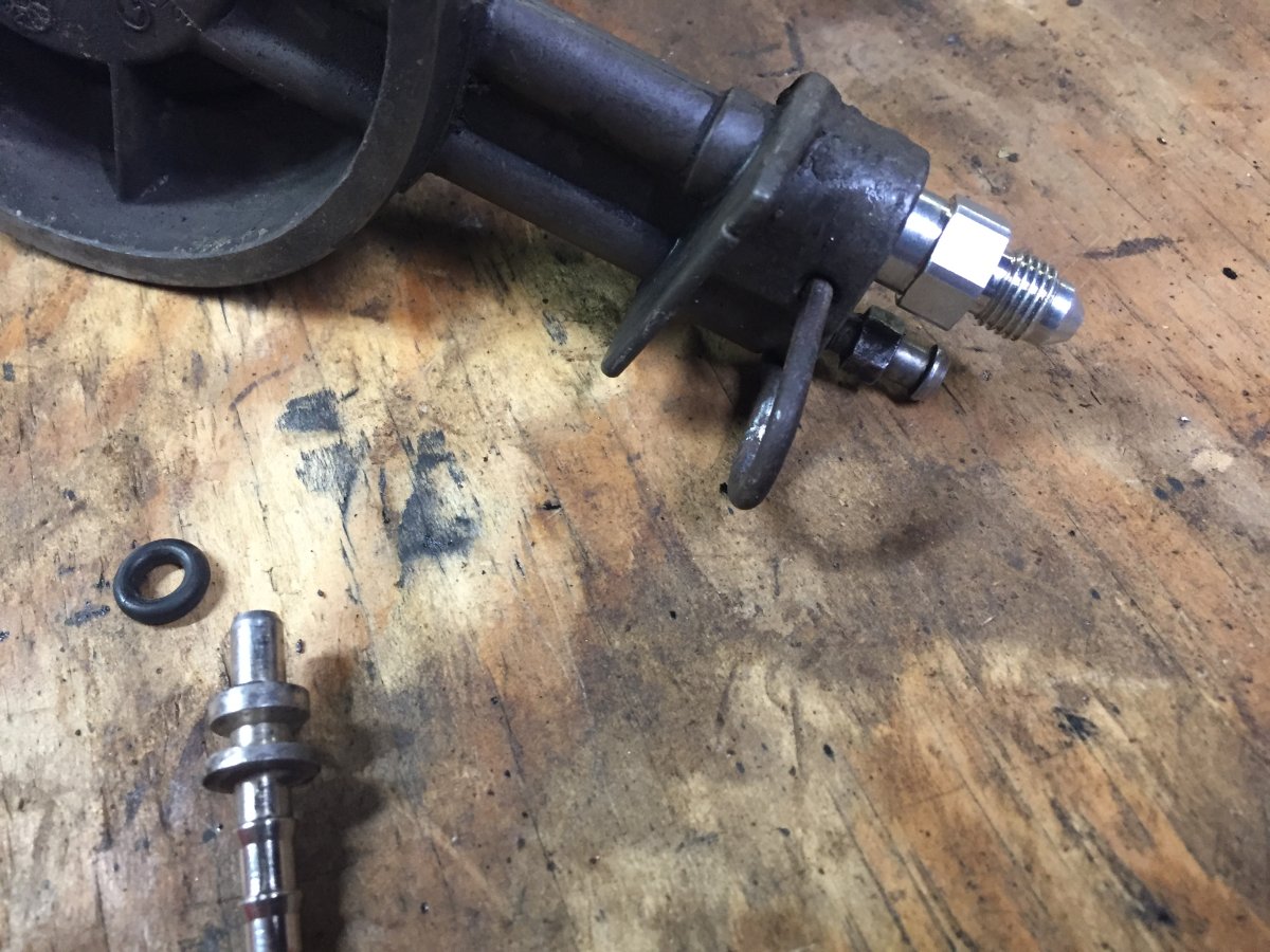

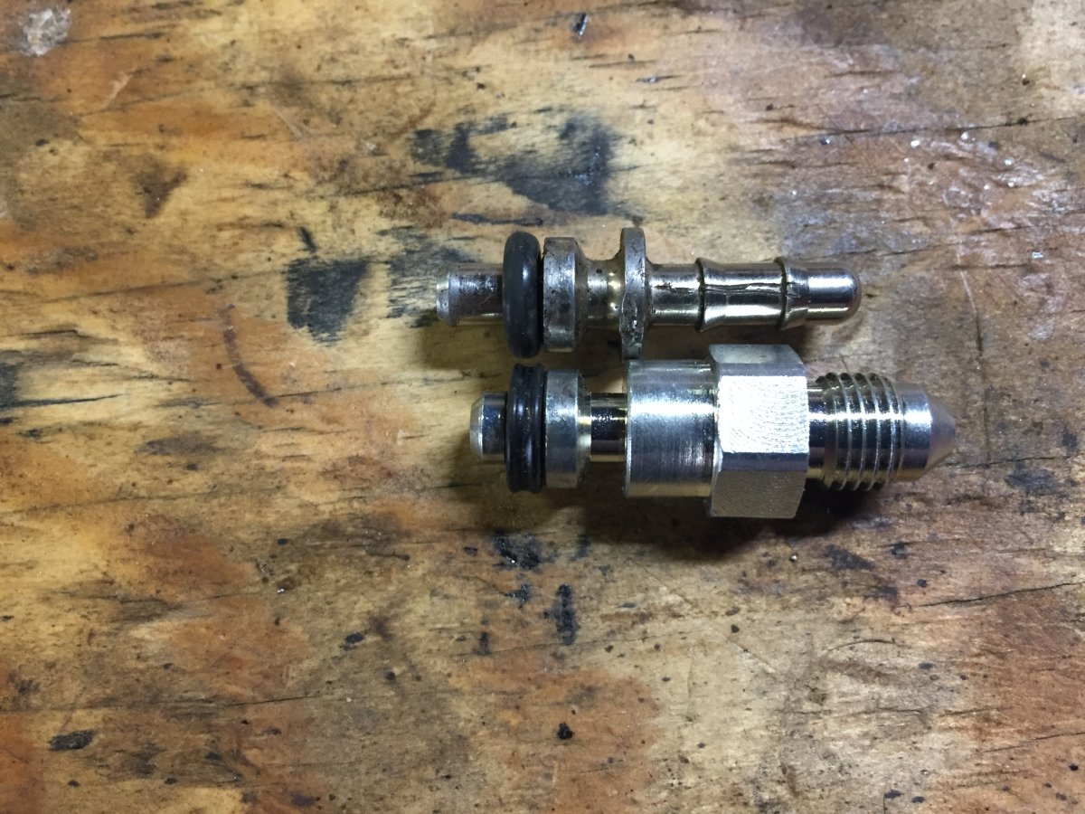

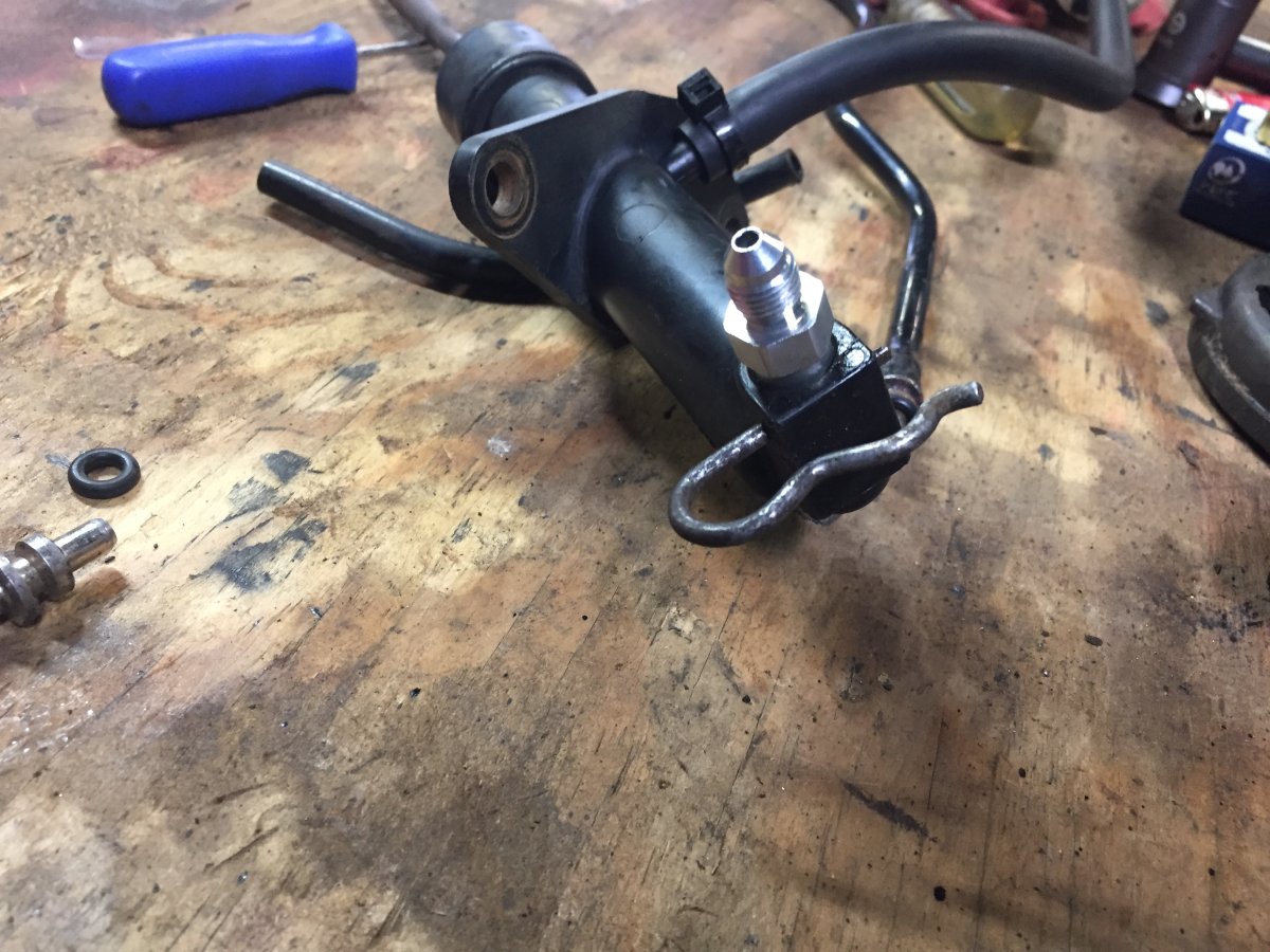

Clutch lines. I have an FM145 with a broken plastic clutch line and the part is N/A. The slave is an internal with the bleeder and line port on top. Big hitch pin secures the line fitting. The line fitting is identical to the master end. No check valve. I have had no luck finding a supplier and have resorted to finding a work around. I want to install adapters on both the slave and master that will allow quick connect with a custom line.

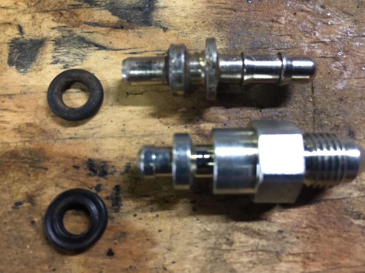

Here’s my mess. Old broken line and fittings. Clutch fitting adapters. Found basically two types by a couple suppliers. The closest match has a shorter nipple and the nipple has a flare on the end

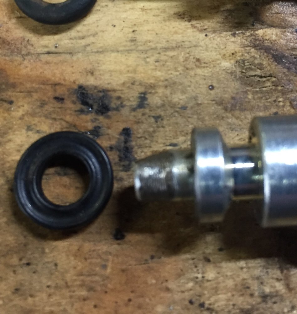

That slight flare on the end prevents it from going into the port
I grabbed a file but man was that gonna be an all day job. So I went to the grinder. I may have gotten a little carried away removing material, we’ll see how it goes.
The seals on the new adapters are a double lip vs the old round ones. They fit nice and snug as do the adapters. Im anxious to order the flexible hydraulic hose to see how this turns out. I know the nipple went past the seal so I’m expecting success

Clutch lines. I have an FM145 with a broken plastic clutch line and the part is N/A. The slave is an internal with the bleeder and line port on top. Big hitch pin secures the line fitting. The line fitting is identical to the master end. No check valve. I have had no luck finding a supplier and have resorted to finding a work around. I want to install adapters on both the slave and master that will allow quick connect with a custom line. View attachment 99457
Here’s my mess. Old broken line and fittings. Clutch fitting adapters. Found basically two types by a couple suppliers. The closest match has a shorter nipple and the nipple has a flare on the endView attachment 99458View attachment 99459
That slight flare on the end prevents it from going into the port View attachment 99460
I grabbed a file but man was that gonna be an all day job. So I went to the grinder. I may have gotten a little carried away removing material, we’ll see how it goes. View attachment 99461
The seals on the new adapters are a double lip vs the old round ones. They fit nice and snug as do the adapters. Im anxious to order the flexible hydraulic hose to see how this turns out. I know the nipple went past the seal so I’m expecting success View attachment 99462View attachment 99463
For grinding round things, if it fits in a drill chuck I do that then run against a grinding wheel. It keeps it round... Also easier to sneak up on size.

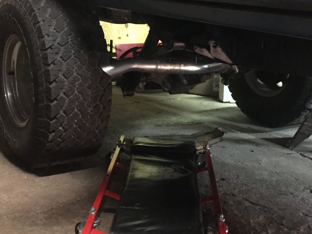

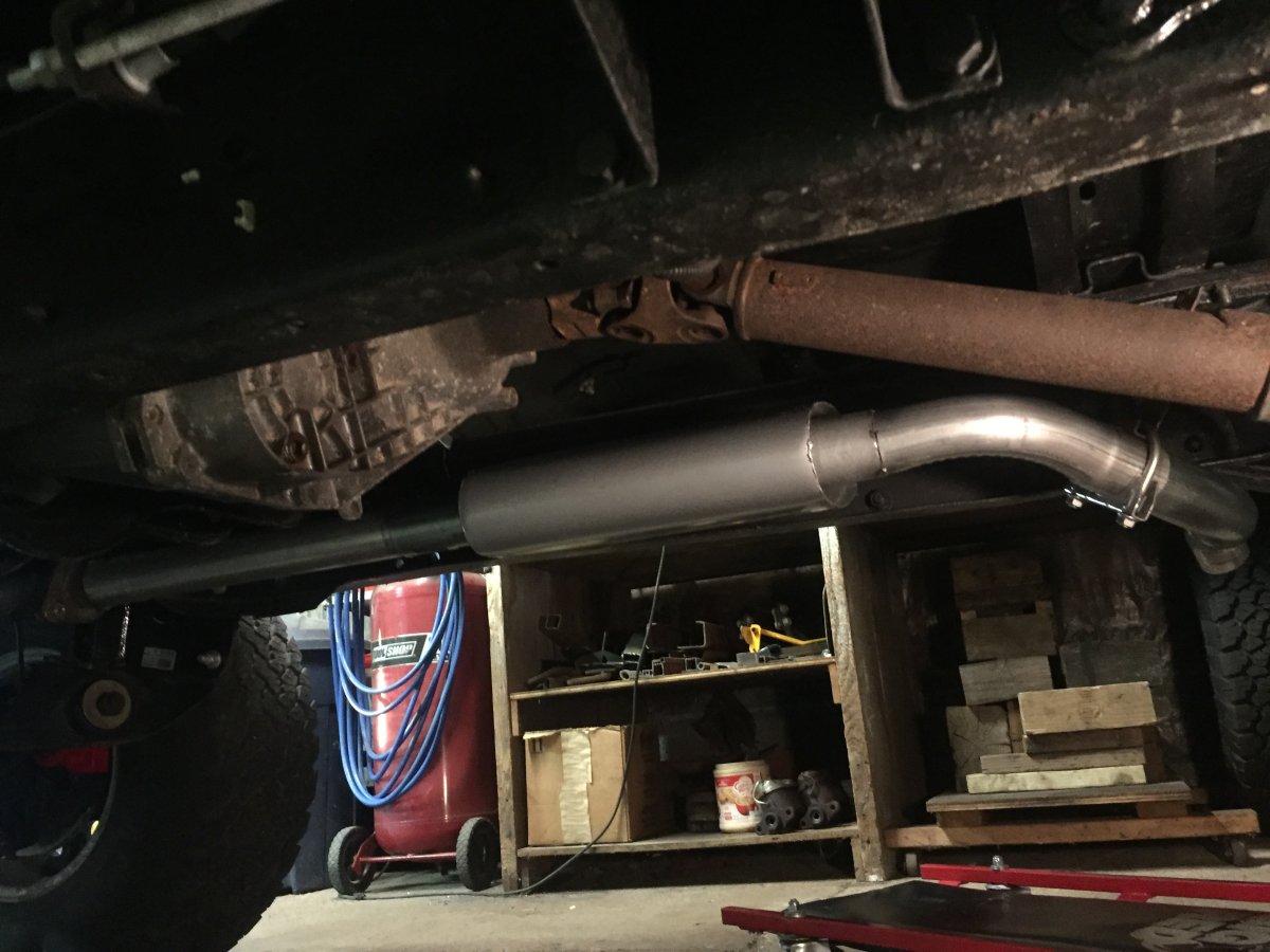

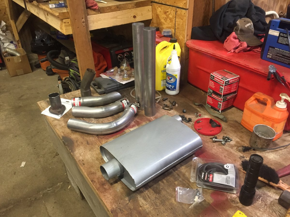

Red neck, old school exhaust. Want to drive my rig around and test all the new equipment but she’s way to loud. Bought a muffler and some pipe from the local auto parts store and spend the day fitting it all together. Exiting if front of the tire, no cat, just a little rumble from the 2.8. 🤣. It’s all tacked together. Tomorrow I’ll give it my best crap welding job and take her for a cruise around the block.
