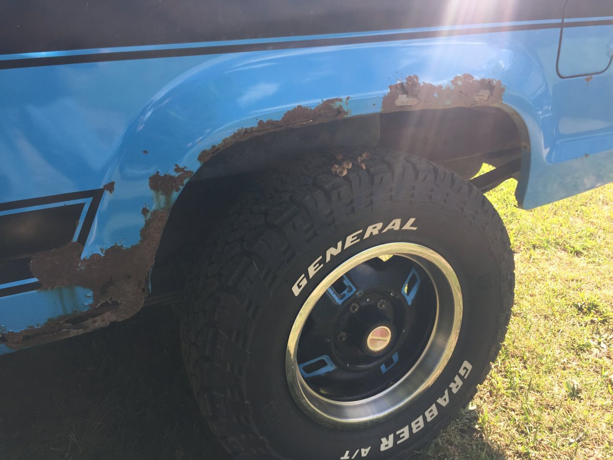

One of my 85 BIIs has some significant weight reduction on one of the rear wheel openings. View attachment 98284

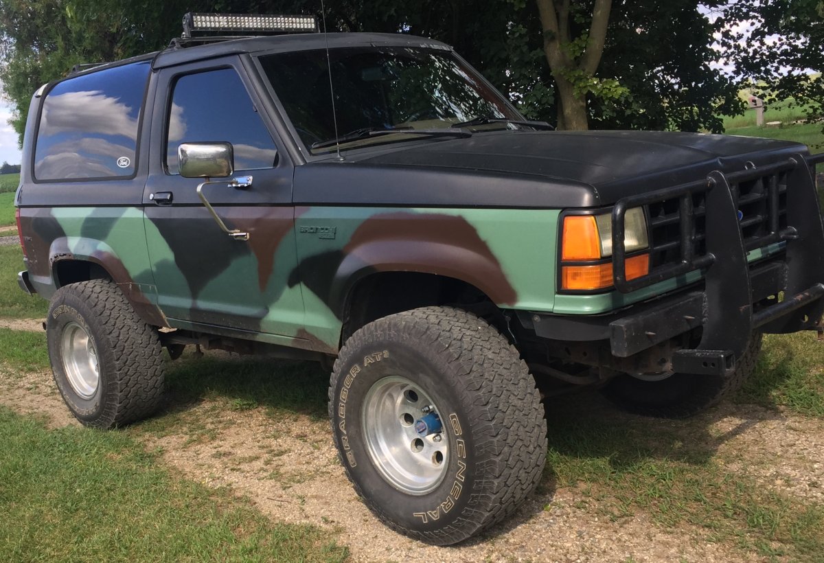

I’ve seen some bushwacker cut out style fender flares but I would have to fill that “flare”. 10.50s don’t fill that kinda space. It says it cuts out 4” of steel and adds 2.5” of additional tire coverage. Ok so without lifting can I get 33x12.50s on and clear the frame. Put a set on my 89 with stock suspension 3” body lift and cut fenders. They clear the frame. View attachment 98285. Most of the body rust on my 85 can be cured with the fender flares. It’s very secluded. I don’t ask why. When you live in the rust belt you take whet you can get. I’m thinking low on 33s would look awesome. After all clearance is only achieved by tire size. I see a new BII project. It never ends, till ur dead. “YOLO”.
I’m leaning heavily in this direction with the blue 85. First things first, I gotta get rid of the A4LD. I’ve done one swap to the M50D and am happy with it. Got my clutch and brake pedals so now I’m looking for a doner rig for the trans assembly and any other spare goodies it may have.We were just talking about this at camp.
In fact ... the best performance gain for wheeling is cutting the fenders and maybe an add a leaf or drop shackles...some two over coils or some spacers up front.
My go-to back in the 90s and early 2ks was 150 coils and f150 or e150 radius arms with relocated brackets and e series brake hoses. This greatly increases articulation and minimally effects steering issues. This combined with max fender cut allow for 35 inch tires for under 150 bux. With a welded diff it makes for an off road animal.
A former member matt8888 done such builds on a few projects and could run level 5 trails. Not pretty....but pretty effective.
I would in your case look at early bronco fender flare options. These look great on rbvs and will really open up tire options. The old school war flares I really liked back in the day.
You want to use a nice sheer on the outer skins. This rolls the edge and keeps it clean and controls rusting over a saw or grinder cut.
Win win.

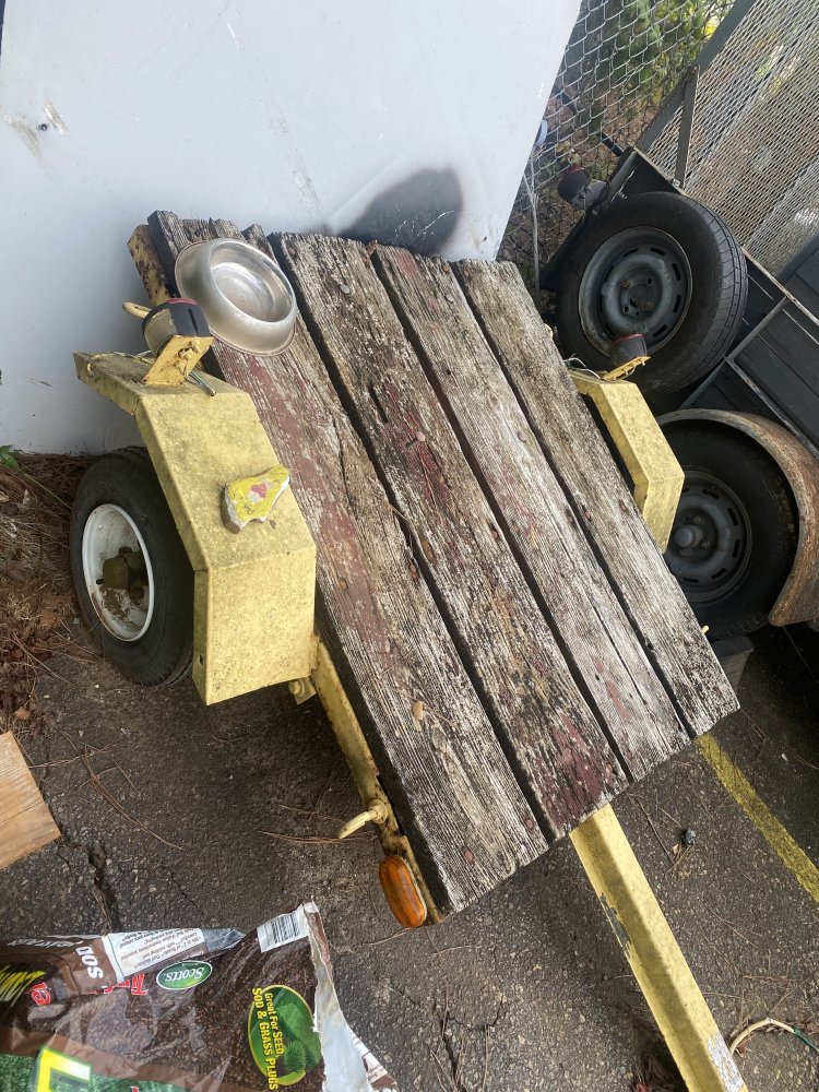

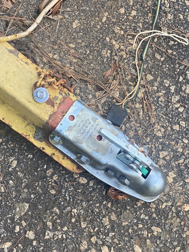

At least the coupler isn't welded on...Guess what followed me home for $40?
I think I found my second axel for the other project. This little guy had brand new tires, still had the sticker on the tread, a brand, new, high-quality coupler, unfortunately, 1 7/8 inches, and I think the wood was from the mayflower, or maybe something from the Civil War.
I’ll flip it over in the next few days and make a decision on whether to clean it up and just sell it for a profit, or strip parts for the other projects.
When I was out in Kennesaw, I went looking around, drooling in the Northern Tool store ( like tractor supply). I looked at the trailer springs and hubs and such, and that was absolutely the deciding vote on picking up this little yellow monster. If I don’t use it out right, I’ve always done better with horse trading.
Medically, it was just in time. I was about to suffer withdrawal from not painting something with rustoleum…
That's kind of expensive for a dog bowl, isn't it?
