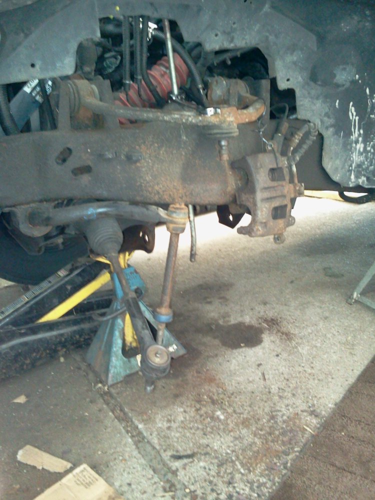

replacing both lower control arms on the 2005 2wd. they are the originals with over 360,000 miles.
ball joints have been replaced many times.
the hardest part was the end link. you can see the threaded rod used in place of a shock to de-tension the spring.

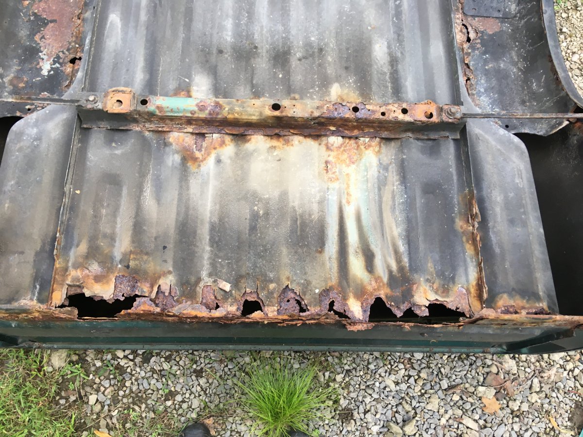

by rust belt standards, that is "not rust"

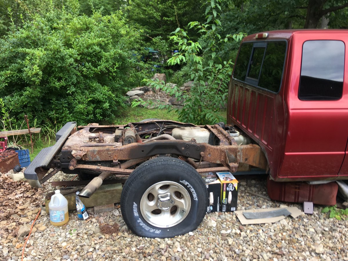

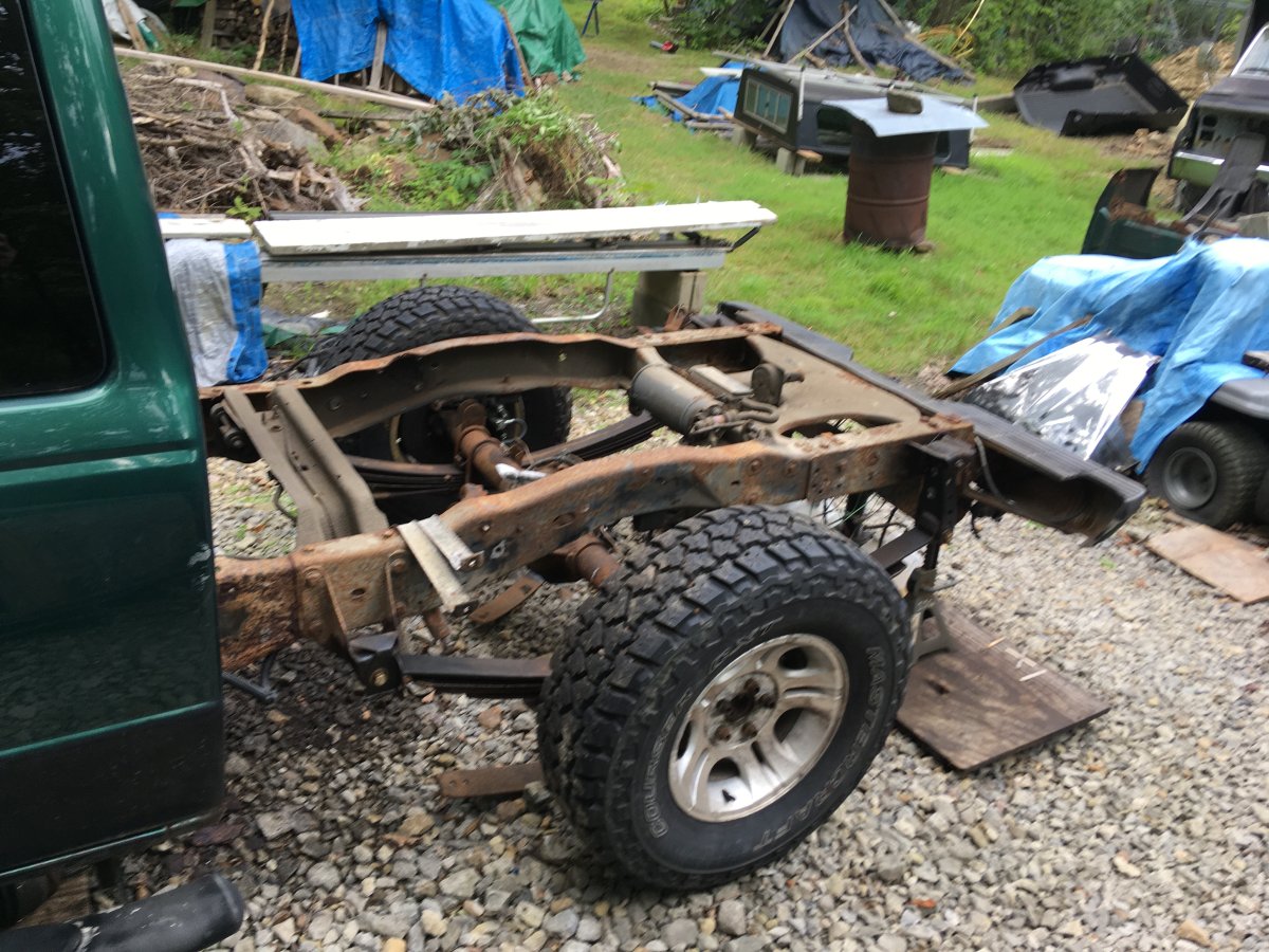

Yesterday the beds got pulled off the Rangers. Paul and Michaela stopped to help. Today I’ll get to start on getting the frames cut and swapped, should be quite the adventure. There’s a lot of stuff that has to come apart and at least on the donor truck, all the factory rivets are still there. Most of them are bolts on mine at this point. My bed also has significant rust, so I’ll be patching that a bit, but unfortunately this bed is caked with that “rubberized undercoating“ crap so it will just continue to deteriorate as there’s no good way for me to remove that stuff. Rust gets under it and just spreads like wildfire. Anyway…

what’s the issues with the red doner truck? Doesn’t look too bad.
It all relative my friend. Here in the rust belt that’s nice. Down south and west it’s beyond repair.
