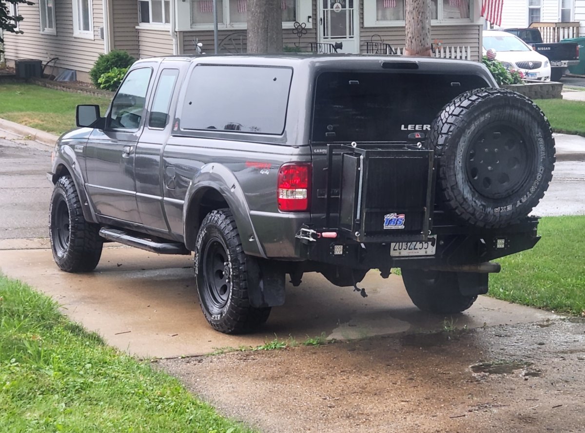

I like that rear bumper. Very functional, but looks good. Did you make the test? that? What are the devices on each end? Could we get a close-up picture of that?
I bought the bumper from Affordable Offroad... I built the swing out tire carrier. The black box on it is a "chuck box". Which is another name for a cook box.
Affordable Off Road offers a tire carrier but I’m not a fan of the design.
I like @Uncle Gump ’s approach much better.

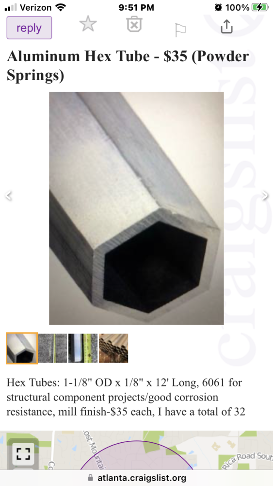

I found this on my hourly craigslist scan. If it was a little closer, I’d go grab a half a dozen sticks for who knows what on the Ranger, may be a pipe rack?
It’s a little long to drive, but it’s a hell of a good deal! I may go get some anyway…
