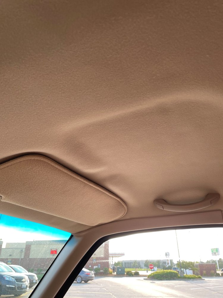

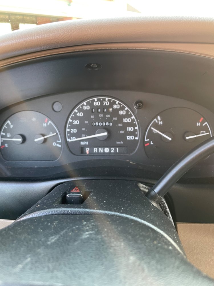

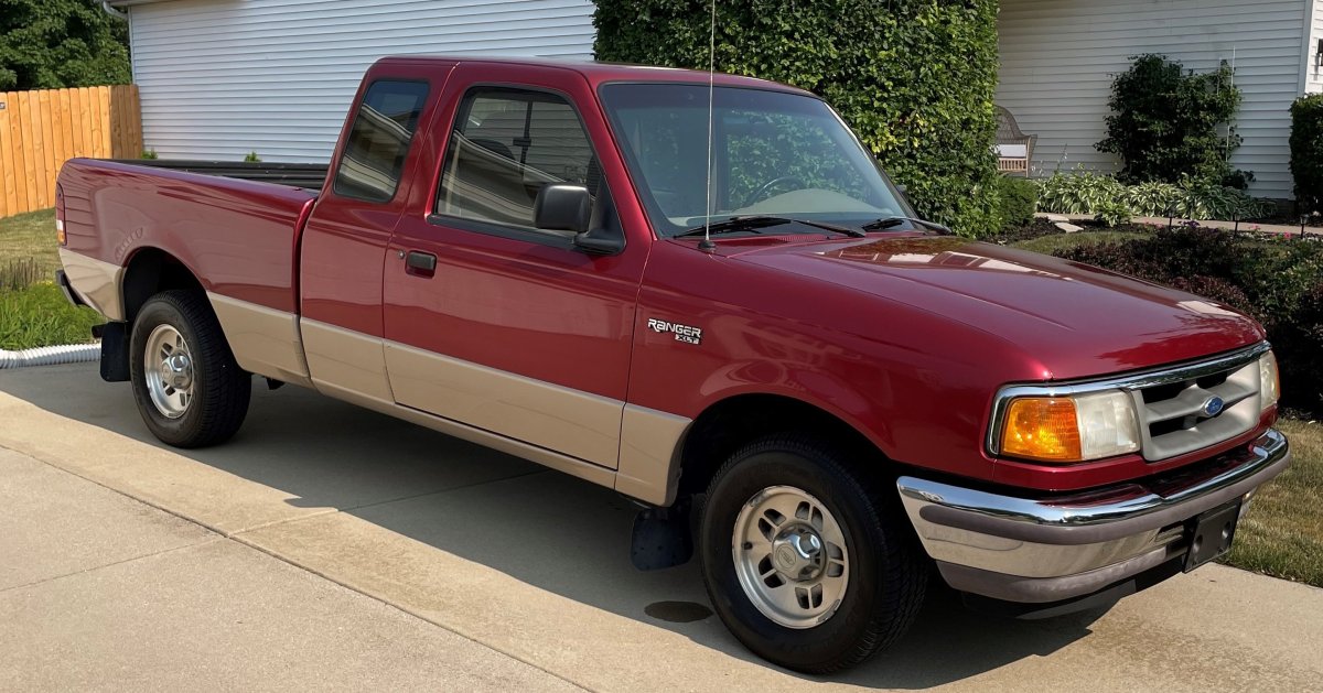

Bought my '97 Ranger XLT Supercab 2WD with only 50,000 miles on it about 4 weeks ago. Since then I've replaced the thermostat and drained/filled the coolant to fix the temp gauge that never got above the Cold mark. I recharged the AC and now it blows ice cold which is great given how hot it's been this summer. I replaced the cruise control switches on the steering wheel. The switches almost looked like they had caught fire in the past - they were bubbled and melted and the cruise control didn't work. Surprisingly after the switches were replaced the cruise control now works again. I also had a local upholstery shop replace the headliner that was ripped and stained.
