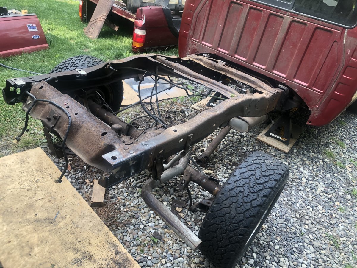

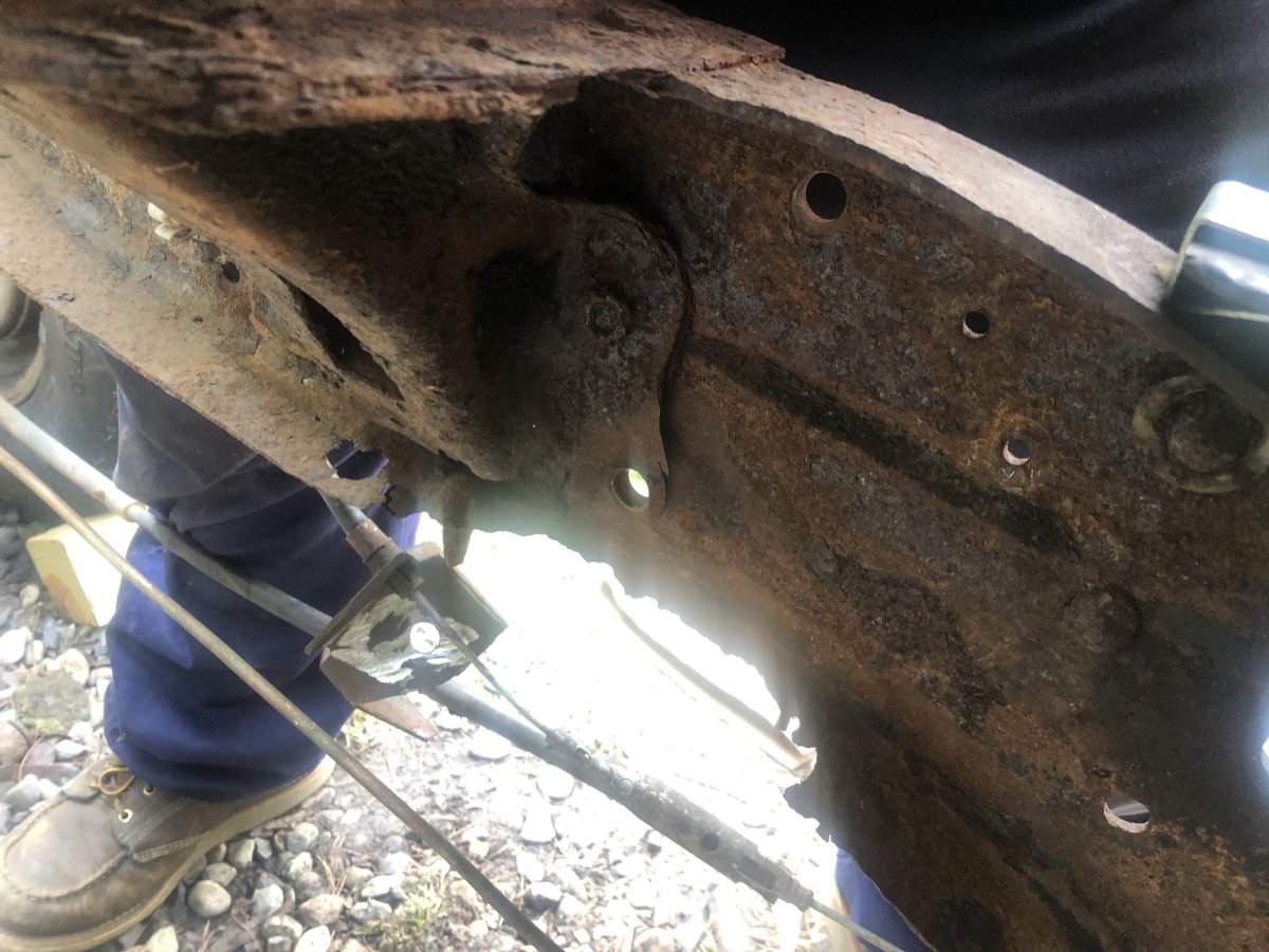

While we were hammering on the frame we discovered more rust issues.
We hemmed and hawed about doing a frame swap or ordering made to fit caps. Throwing the truck away and saving the engine.
Decided to just deal with the extra work and fix what we have.
Had to pull the axel to get the gas tank fully removed.

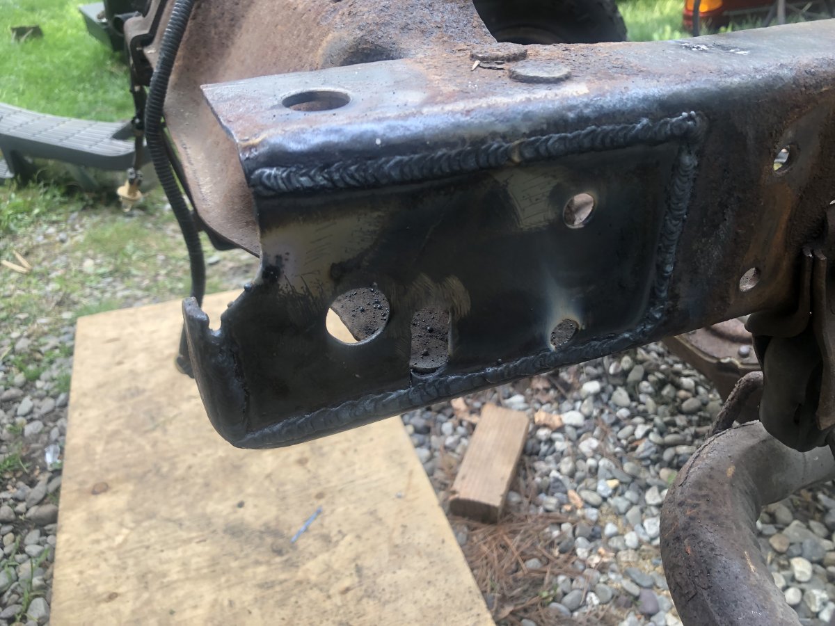

Cut up and welded in the patch for the rear passenger side hole, still need to fish plate the vertical splice.
Tomorrow is more welding for me and my brother is going to see if he can get the new bushings installed in the leaf springs.

Cut up and welded in the patch for the rear passenger side hole, still need to fish plate the vertical splice. View attachment 94022

That sucks. Here I am being scared off by a floor pan replacement on the 85, and you're repairing the frame like that. That being because I'm not much of a welder, not because I'd be scared of the patch strength.
Might have hemmed and hawed, buy it looks like you're doing some great work!
I'm no engineer, but I think you'd be ok without fishplating that patch at the back. Everything that is going to bolt back into that area is going to reenforce it and I don't think that's a real high stress area, at least not as much as if it were in front of the axle. Now if it were in front of the rear hanger I'd probably worry more about reenforcement.
In the leaf spring bushings, from what I understand fire is your friend. Use a torch to buyn out the center, then a chizel and hammer (or air hammer if you have one) to knock out the old sleeve. The press the new ones in.

Been in that boat more than once. Chin up though, we have the technology to fix it. Kinda wish somebody made replacement frames for these though. Or Ford would do what Toyota did with the Tacomas.

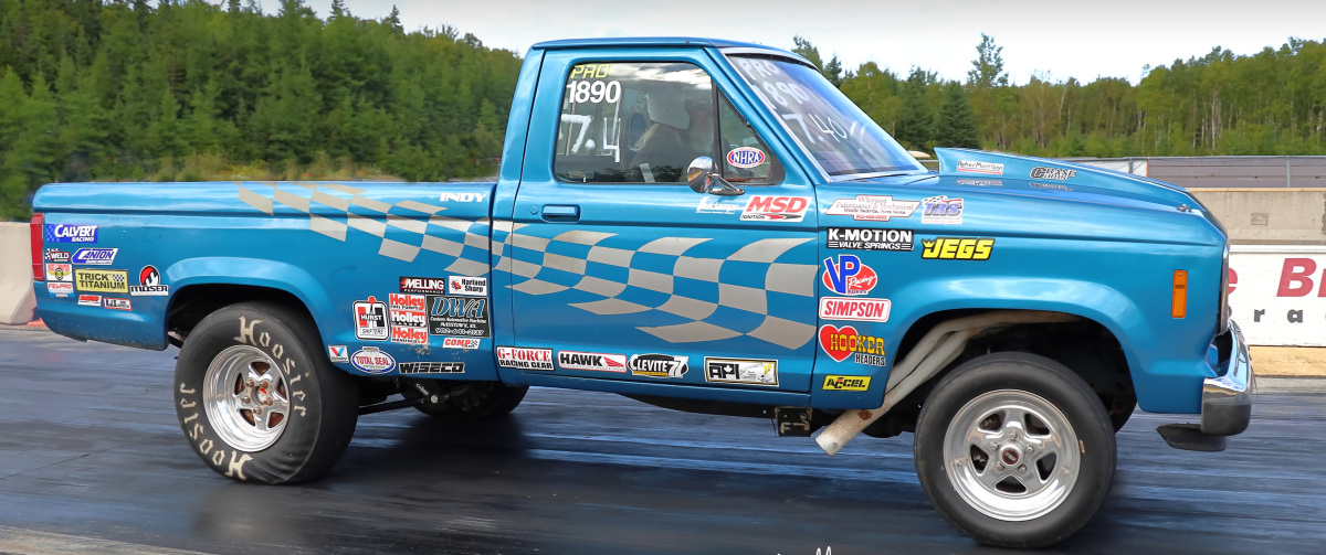

Got some bad news today. I have a vision problem that will keep me from racing for awhile. It's called Binocular Diplopia which is just a fancy name for really severe double vision. Basically it's a problem with the nerve that drives one of the muscles that moves the eye and very disorienting without wearing a patch over one eye. Trying to drive to the eye doctor without an eye patch was terrifying so I'm lucky I found a Pharmasave next door and picked one up that made the trip home a lot safer. Odd thing with this problem is it doesn't matter which eye you cover up - the double vision goes away the second you put the patch on.
Ranger will have to sit until this problem gets solved. It was a real kick to the gonads after all the thrashing the past few weeks to get this puppy ready for this weekend and now I'll be lucky if I can negotiate the ten minute trip to the track to watch(with one eye) everyone else go down the track.
What a bummer. I hope it clears up soon. That would drive me nuts.

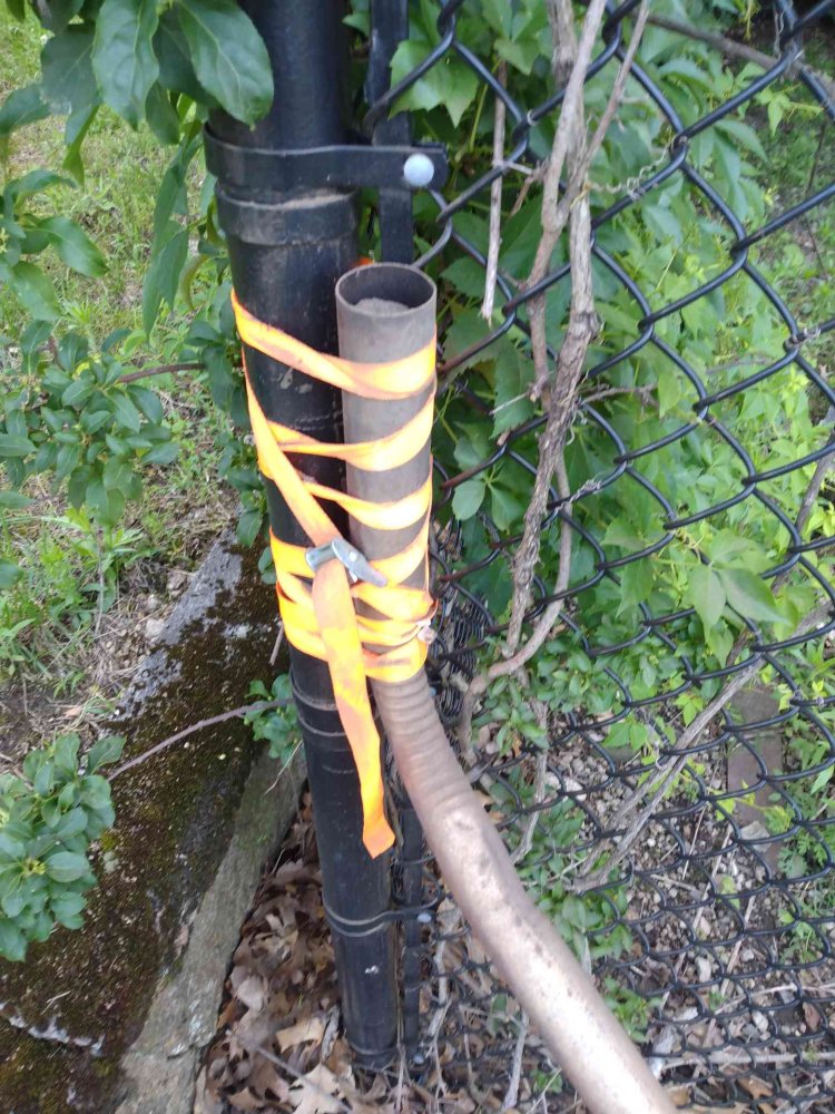

Tied my exhaust to the neighbor's fence and filled it with dirt...
