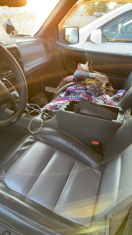

Got started on installing a center console

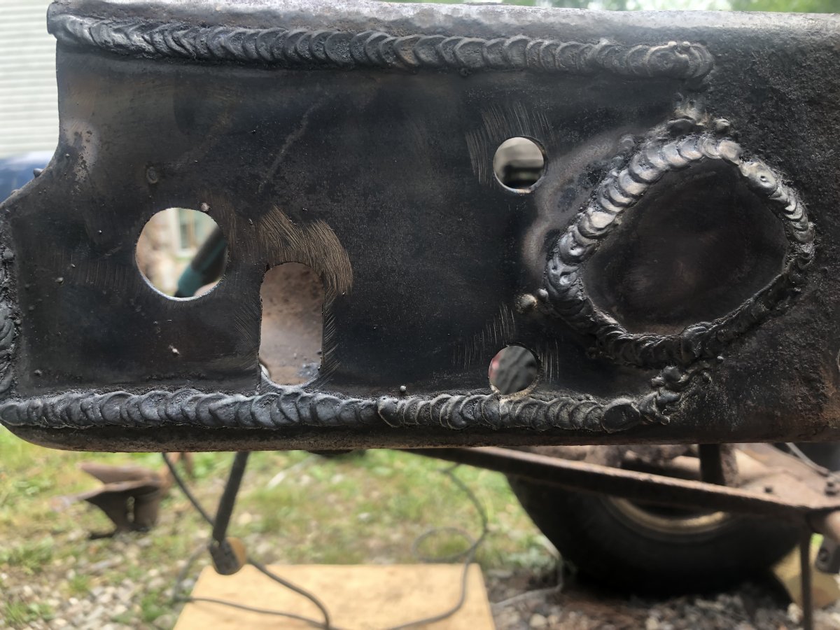

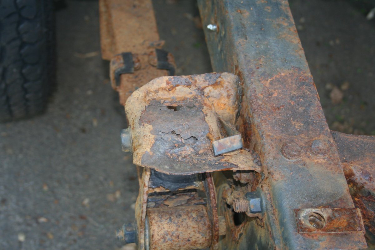

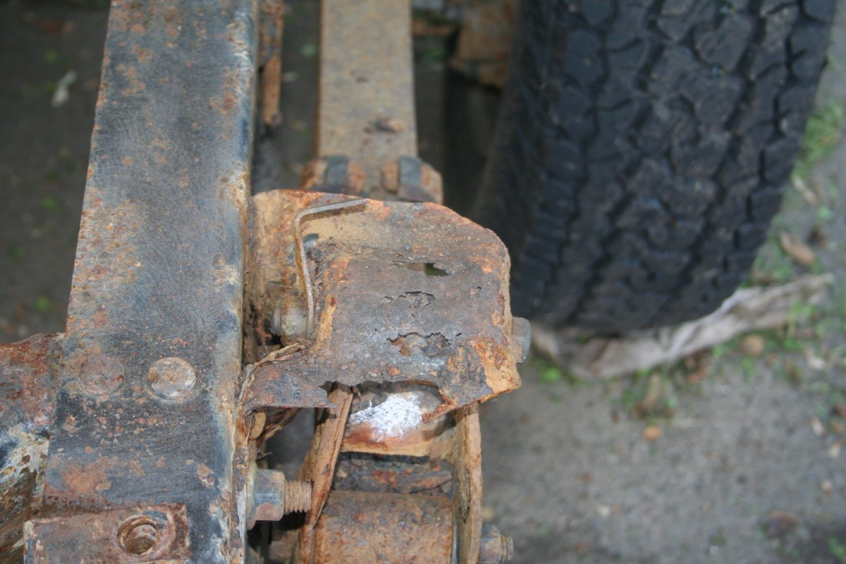

Been in that boat more than once. Chin up though, we have the technology to fix it. Kinda wish somebody made replacement frames for these though. Or Ford would do what Toyota did with the Tacomas.
We briefly searched for a donor truck to use the frame, and every truck under $2k had the same issue.
would have been nice to make frame out of fresh steel, but I don’t have the patience for that at the moment.

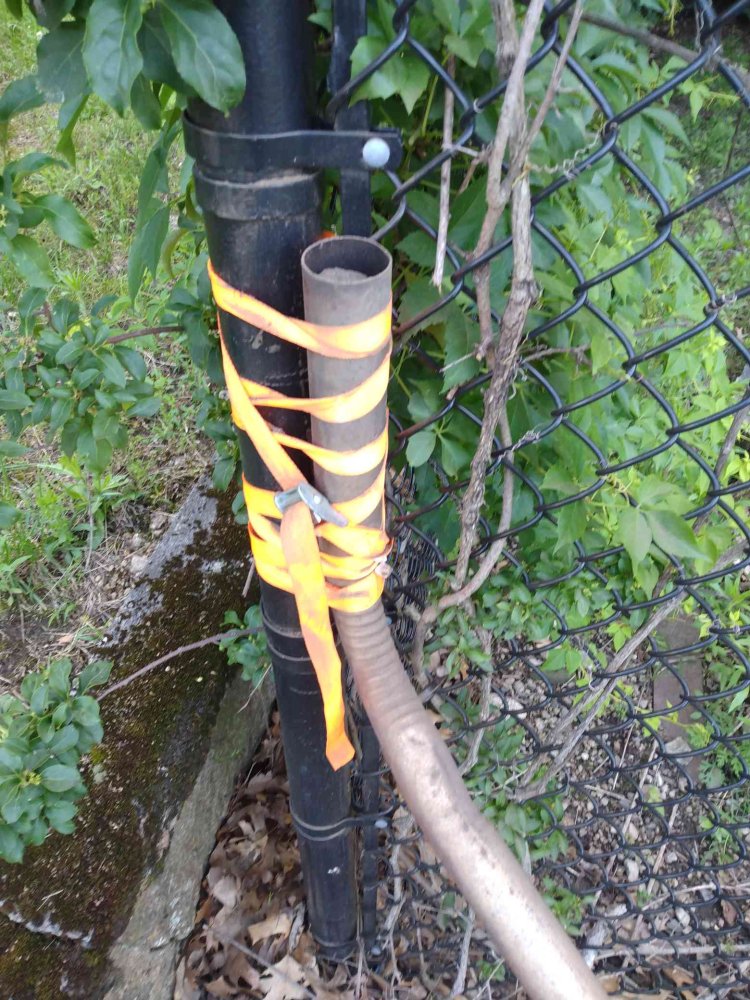

Tied my exhaust to the neighbor's fence and filled it with dirt...
Damn, I always think of myself as creative and inspired, solve any problem with what’s on hand, but it just never dawned on me to tie my exhaust pipe to the neighbors fence and fill it with dirt. I bow down…
So yesterday I finished my work of giving the brakes a once over. Everything seemed fine, did a quick vac job in the cab and took it for a spin last evening to find the passenger front is apparently hanging up. Seemed fine when I cleaned and lubed it, but apparently not fine. Little annoyed but not the end of the world, I’ve had new brake hoses and calipers sitting around since the last time I had it on the road, so I’ll just have to swap it over.
Unfortunately, I’m going to be restricted to local trips until I can do the ball joints, for some strange reason m the upper ball joints are both going bad. Lowers seem fine, but I have a little play in the uppers, which if I remember correctly only have a few thousand miles on them. Gonna have to see if they are under warranty… I need to pop the front axle apart to take care of the broken axle shaft and I want to check all the seals and u-joints and stuff too.
Are you going to let us know why?
I would guess he is going to bend it. Filling with dirt or sand will prevent a kink when bending.

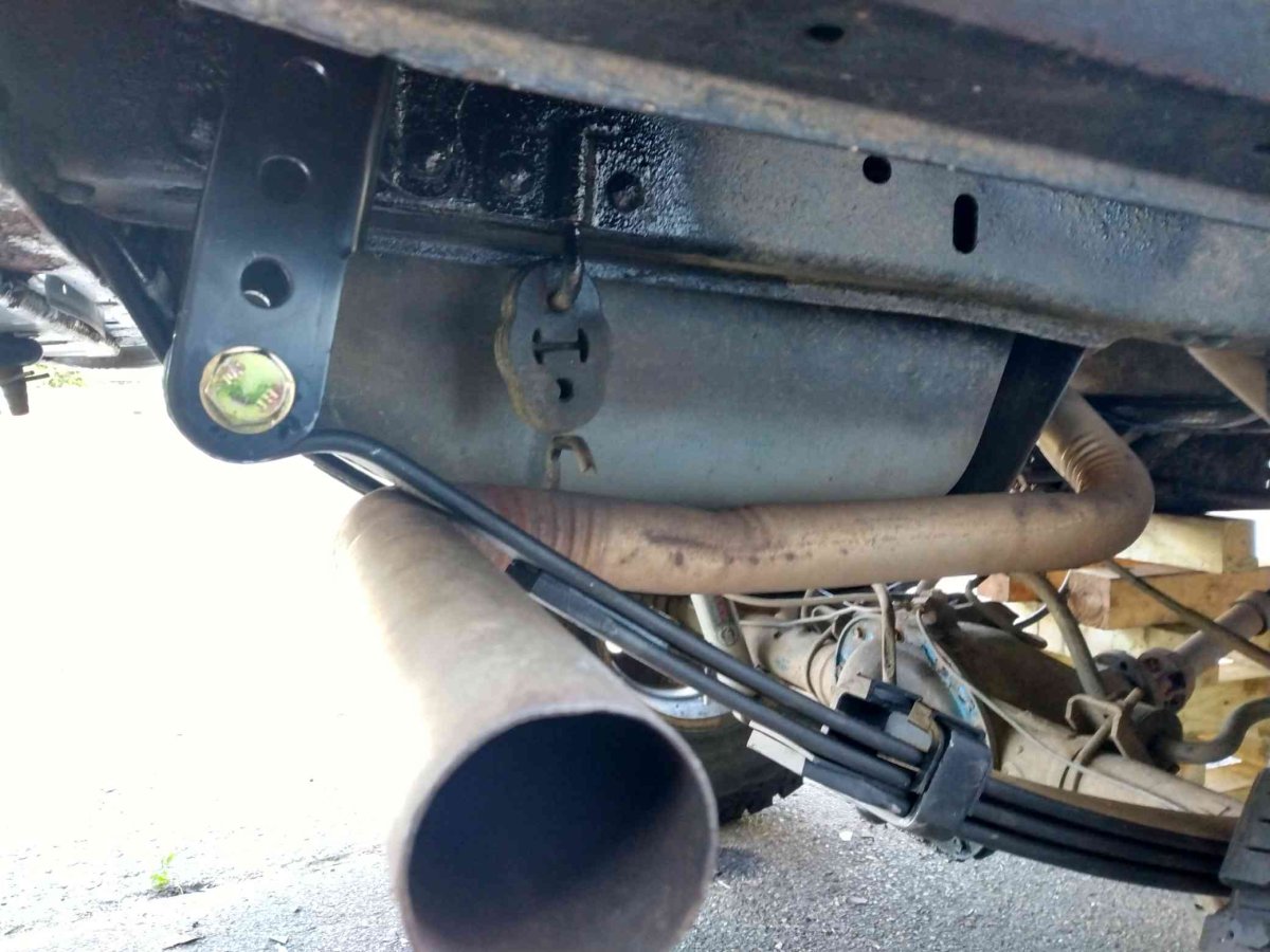

Correct! It did not fit with the new springs.

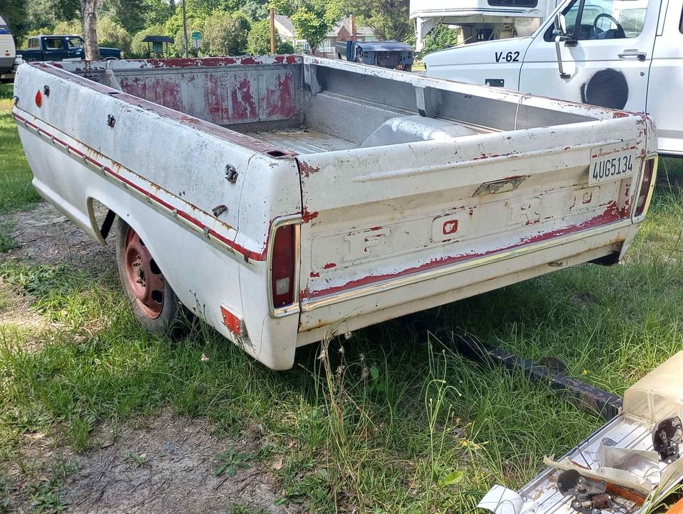

On other note I'll hopefully be taking the F-250 to pickup this trailer this weekend. Assuming it doesn't sell out from under me of course.
Popped up on facebook marketplace when I Was looking last night. $400. Not perfect but a whole hell of a lot more solid than what's on my truck now, and most of what I'd find on this side of the country. Was from California, still has the CA plate on the tailgate.
