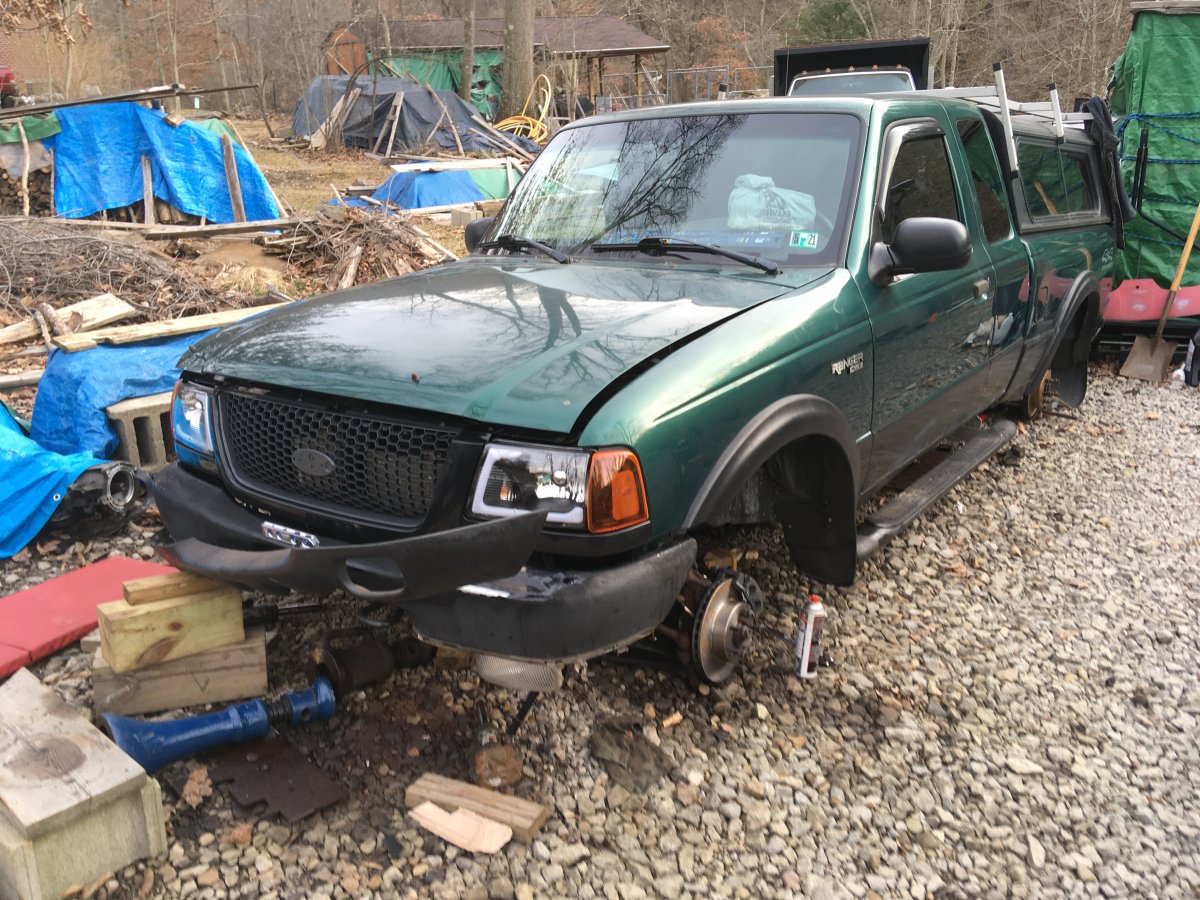

Well, I got to go out and work on the Ranger. First up I got my LED bulbs so I got the headlights together and they look awesome. Got the shackles in and re-set some jackstands because I didn’t like how they looked and started to work on getting the front tires on. Just when I was about to try getting the front set for alignment and the front tires on, it came off the jackstands. I’m not physically hurt. There is damage, but I’m not sure exactly how much yet. I do know the gas tank is f@#ked. At least 4 jackstands are crushed. I skipped dinner, no appetite. Three corners are back up and on tires temporarily. I ran out of light and both flashlights were out of juice at that point. I don’t want to talk anymore about it right now…
