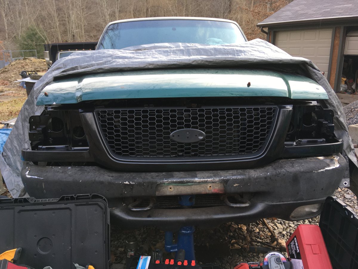

Seems strange to me the Explorer would have heavier sway bars and torsion bars than the same-year Ranger. Especially with the torsion bars, some members here have said their stock Ranger torsion bars sagged over time.Chipped away at my list. New 65 series battery is mostly installed, had to make some adjustments to the battery cables. Also had to bend the bracket for the ABS because the battery was hitting the one bolt.
Front sway bar installed with new poly bushings and end links, using the Explorer 34mm bar since it’s significantly beefier than the Ranger one. 98-01 Explorers had these and they mount exactly the same as the 98+ Ranger ones. 95-97 Explorers could have 36mm, but they mount different.
Built my second leaf pack. Few odds and ends. would have been nice to get more done, but I think that was good progress today.
