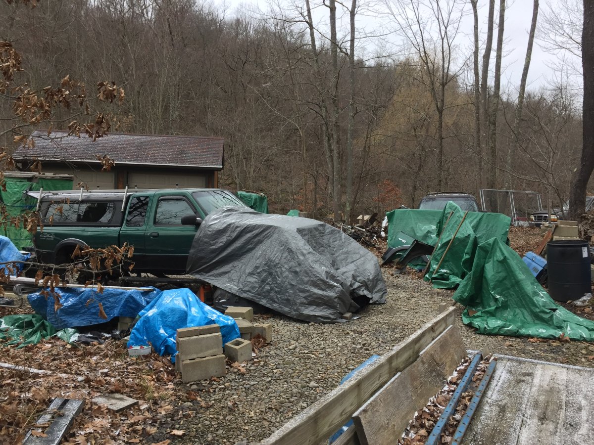

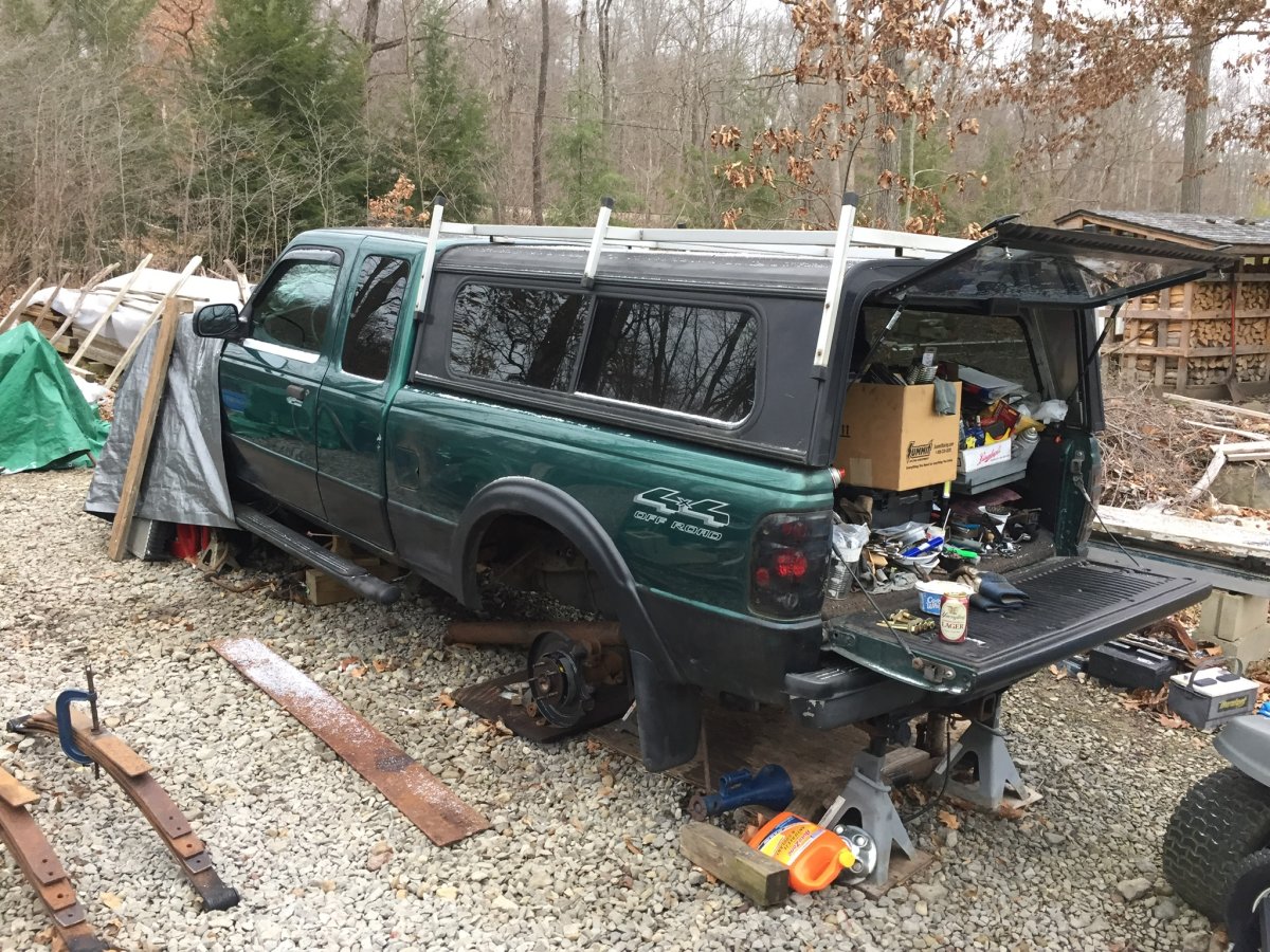

Well, I went out and worked on getting the leaf springs together, think I know how I want the packs, but before I cinch down the U-bolts I’m gonna jack up the back of the truck and see how it is. Didn’t make a lot of progress though, was fighting the cold and snow and dead batteries, broke two of the plastic end pads for the leafs because they were so cold. Had a couple other issues. One pack is built and partly installed.
Oh, and here’s my workshop and the nice rear diff cover…

I admire your tenacity.
Impressive!
But you may be OCD, one of those guys who have everything in their shop just a little too neat & orderly?
I call it efficiency, and when I have an actual shop building to work in, it will be much tidier than the outdoor shop

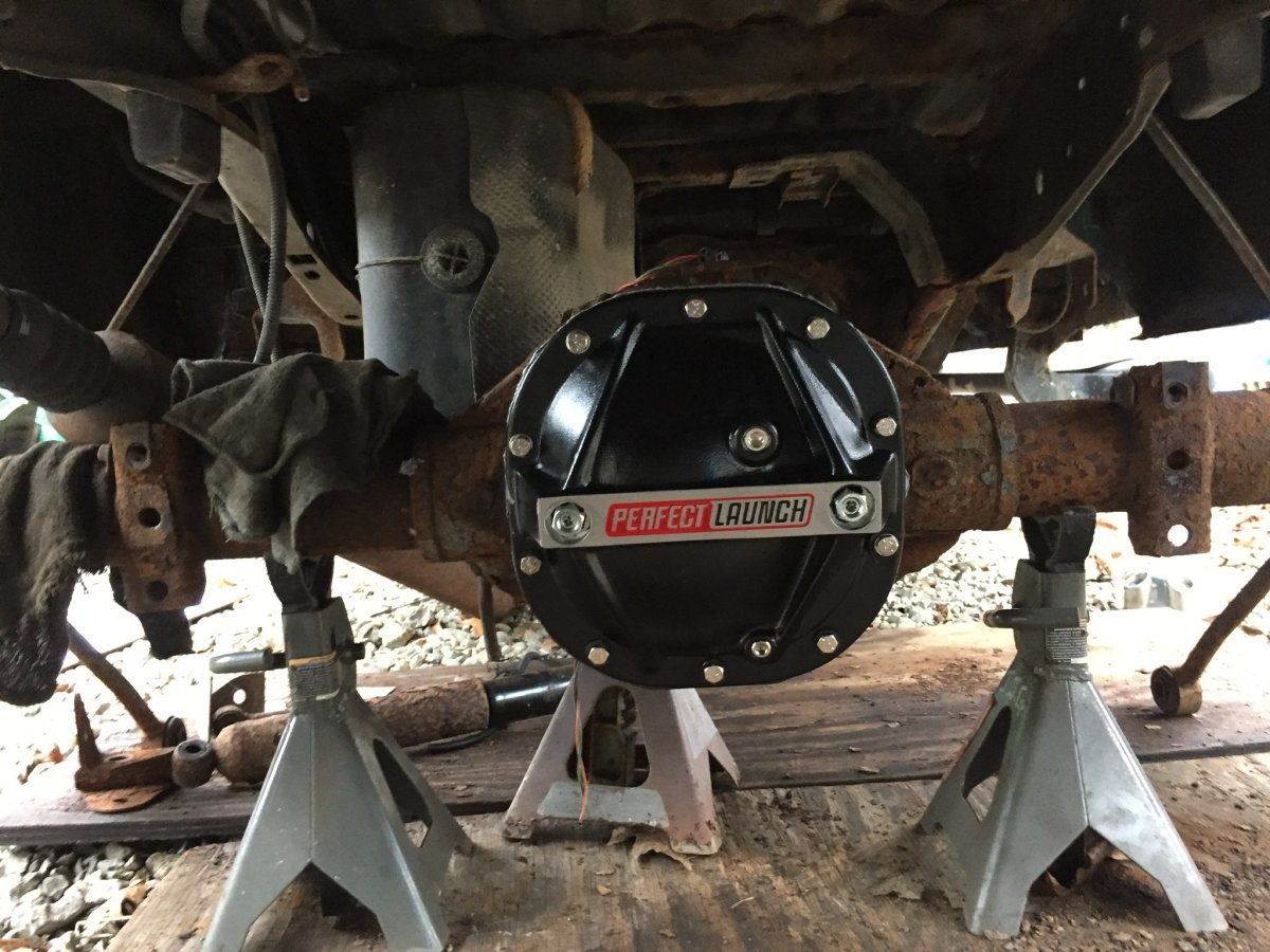

Come on, you need to spray some salt water on the diff cover so it matches the axle. :LOL:
It’ll get there, lol. Actually thinking of painting the axle with a home brew anti-rust compound. Or I might just take it in and have it sprayed after it’s running.

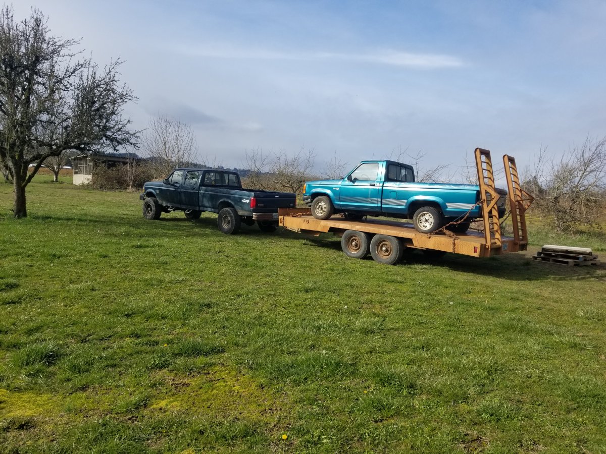

Here's the only pic I took of the new to me '92, that's the straight side, the passenger side is the one with all the damage :)
Just realized looking at the picture it's a long bed, that TOTALLY explains why the center of the drivers door had to be ahead of the front trailer axle... the '90 has been on that trailer MANY times... :)

Built my second leaf pack. Few odds and ends. would have been nice to get more done, but I think that was good progress today.
