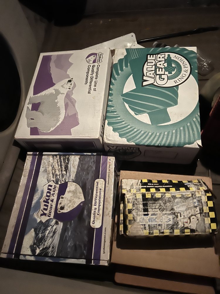

Found a killer deal on marketplace.
4.56 gears and rebuild kits for both the front 35ttb and the rear 8.8, along with a lockright for the front. All brand new in the boxes for $500. Guys had them in his shop for close to 15 years and finally decided to sell them.

That deal would have been hard to pass...
