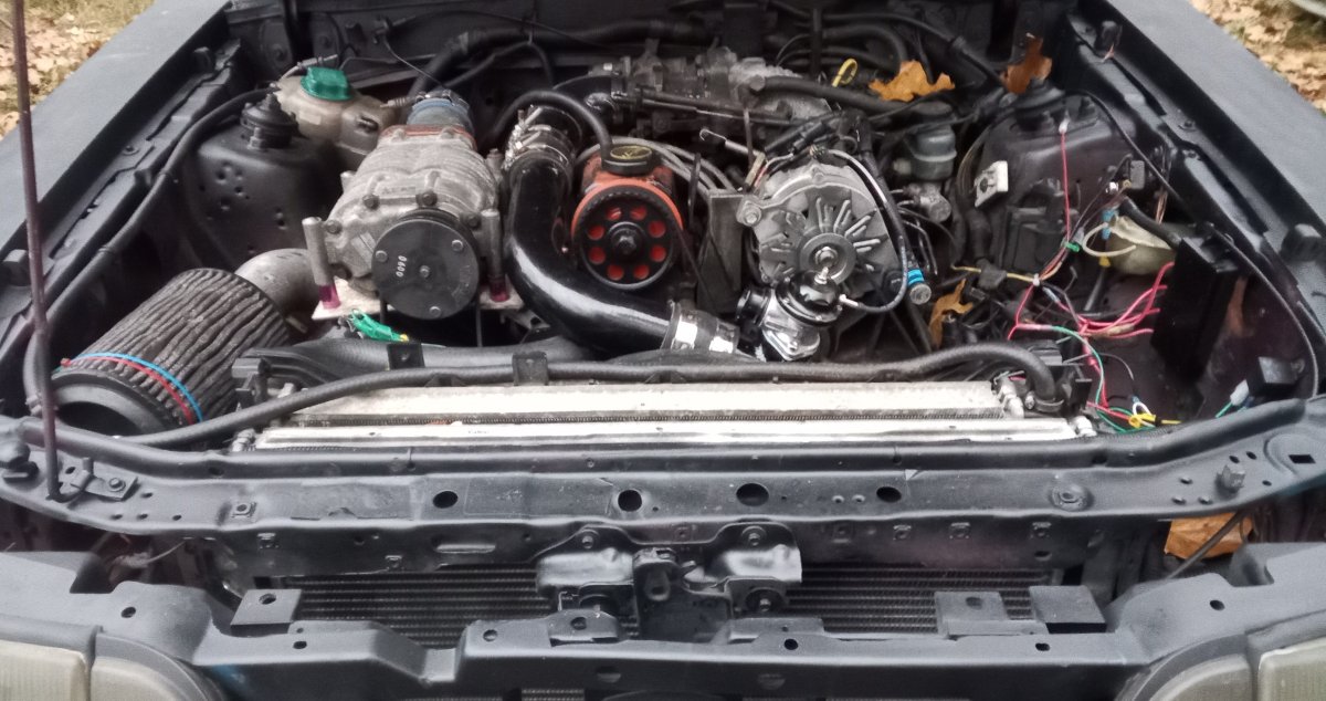

Kinda hard to see but pcv is now just a 3/8 brass connector and hose goes under intake around head and tees in to the valve cover breather hose then to supercharger intake
Are you running a supercharger (Mercedes m62?) And a turbo?
So this car just the m62..I did twincharge my 79 Ford courier but changing route on that. My ranger will be twincharge d tho!!!
Very nice
