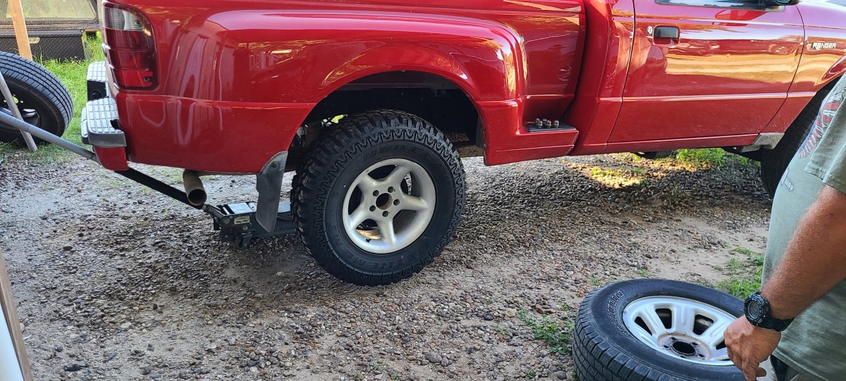

recently swapped to my set of winter wheels/tires. picked up a nasty wobble on the right rear.
chalked the hi spot on the sidewall, rotated the wheel a couple bolt holes and the mark seemed to follow the axle instead of the wheel.
instead of setting up the dial indicator I chose the "easy" route and pulled the axle shaft for inspection.
sure enough, it was greasy as all hell.
I have an assortment of bearings that will make a test jig, I'll check both shafts.
this is my 2005 2wd, has 368,000 miles and the first time the rear was opened up. lube was clean, not shiney, wear surfaces were great, seals not so much.
not too bad for a 7.5 in a work truck.
time for wheel bearings & seals, brake cylinders.
edit: corrected mileage. and they are all mine.
