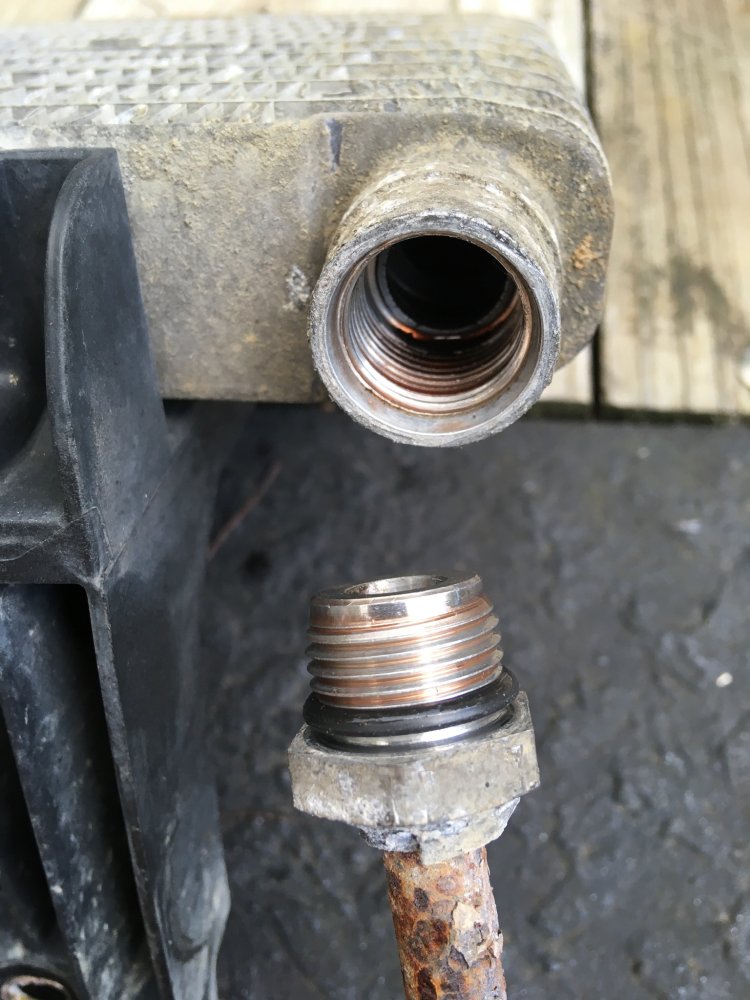

The one big thing I haven’t found an answer for yet is that I got a transmission cooler out of a 2007 F-150 that I want to use. It has threaded fittings but I have been unable to come up with a fitting to screw in there to make my own line from so far. It’s not NPT , has an O-ring seal outside the threads and I haven’t found the answer yet. Even called Dorman since they make the replacements and they couldn’t tell me the thread size or fitting type.
tapered or straight?

That’s straight thread O-ring seal… now we just need to know if it’s metric or standard.

Do you have a tap and die set. They usually have a thread checker for sizing. Kind of looks like a comb.
I’ll bet it’s still NPT or BSPT ( only difference is the angle of the threads ). They have both in straight and tapered.

If you have a nut or bolt or stud you can go to any of the big box home improvement stors or Rural King or Tractor Supply and they have threaded holes and studs that are labeled that you can test fit your hardware.

Just take it to a hydraulic shop and ask for an adapter to JIC. You can use AN fittings and hose off that.
