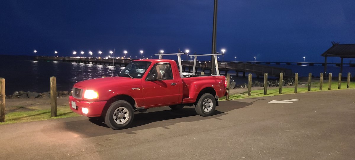

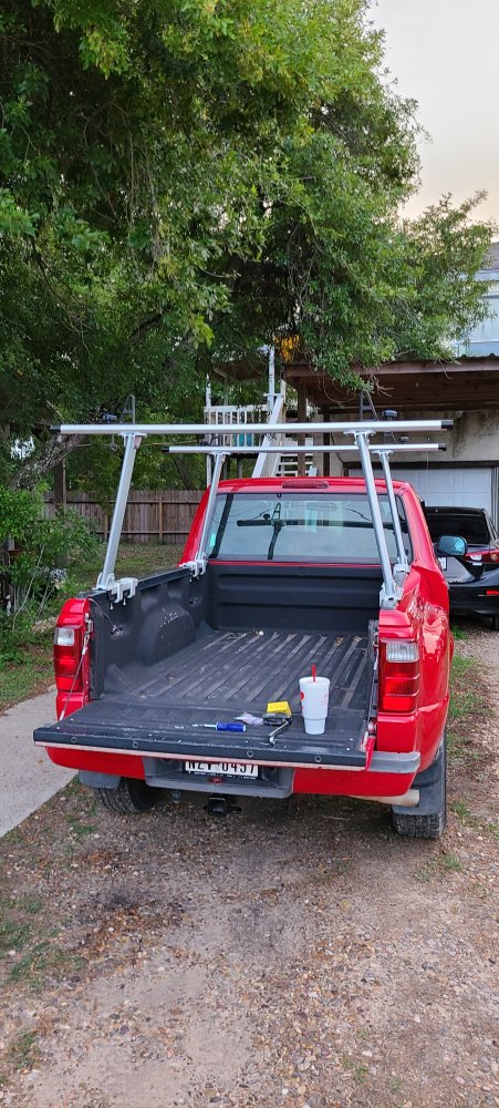

My son and i took our beauty of a ranger into town yesterday to hit harbor freight for the haulmaster aluminum utility rack. We got there and grabbed the last little ticket for one and started walking around to look at all the cool things we could use in the garage. We grabbed the rack, two 4'x6' moving blankets, a stepped drill bit, and were heading towards the compressor hose area when the manager came and told us the internet went down so we had to leave since they couldnt sell anything.
God dang, i finally drive my butt across town and the internet goes down at the store.
So we go to the ford dealer next door to look at the new ranger, the f150s, and mavericks but gow dang!!!!! They had a 20k surcharge on them! What the hell is wrong with car dealers? 20k made the rangers 60k+, all the f150s were 70k+, and they only had one used maverick so i don't remember the cost because i couldnt get over that 20k fee they had listed on the other truck's.
So we left.

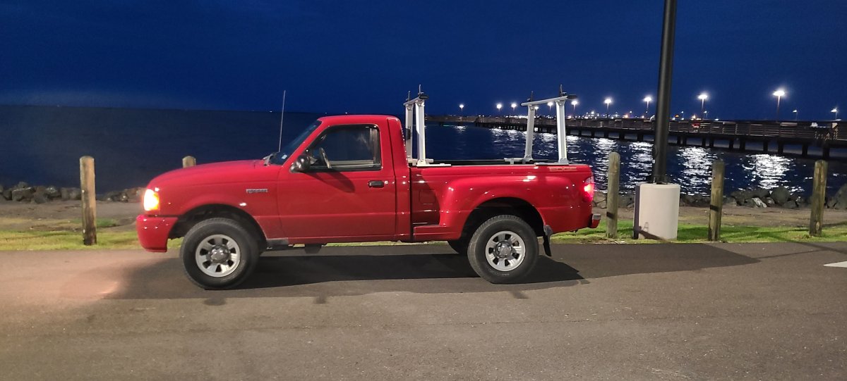

We decided to try hardor freight again today and luckily they were in a working status. We got the rack, the moving blankets (keep behind the seats in the trucks and cars in case of emergency), extendable ratchets, air compressor hose, and some wire bristle brushes. We almost got another aluminum 3 ton jack, a parts washer, a small sand blast cabinet, and a battery powered weedeater but i know my wife would have a cow so we didn't get those last fun things, That will be in a few weeks, when she goes tdy :)
Anyways, the rack is very nice and really solid once its built and put in place. It doesnt whistle on the highway either, which is nice. My son came out to check it out once i had it on and he said the ranger looks like one of those raggedy beat up work truck rangers now. Apparently he is not a fan. I really like it, having grown up with pipe racks on all my trucks in high school and when i was doing contruction. They are just so dang useful.
I ran down to the end of the road to use the parking lot light for a picture
