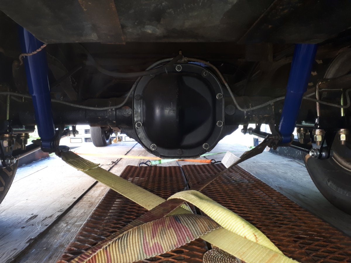

New blue Monroe shocks in a "Hail Mary" attempt to solve our wheel hop and spin on launch problem. Old shocks were 100% non functional on rebound so this is hopefully a quick fix.
I'm surprised you didn't already have some single adjustables.
I have a pair of AVI adjustable shocks but they are shorter than the stock ones so I will need to make a new upper crossmember and weld new perches on the axle tubes. Going for eye surgery today then a couple days recovery so I didn't have time to get them installed before the Labor Day race. Stock replacement blue ones didn't even take me a half hour to install.
