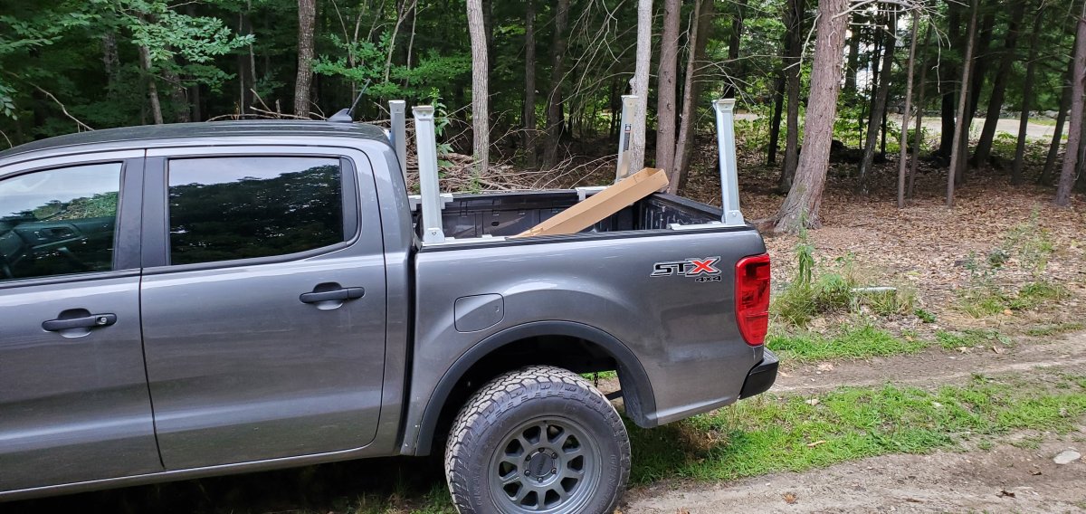

Got most of my bed rack on before it started to pour. Hopefully get the crossbars on tomorrow.. but.. supposed to pour so 🤷‍♀️ well get there eventually lol.
The rack is a haul-master 800lb universal job I snagged at hazard fraught. I ended up cutting 4" off the uprights so the crossbars would be at a reasonable height above the cab. This required enlarging 2 holes per upright a hair and tapping them for m10x1.5.

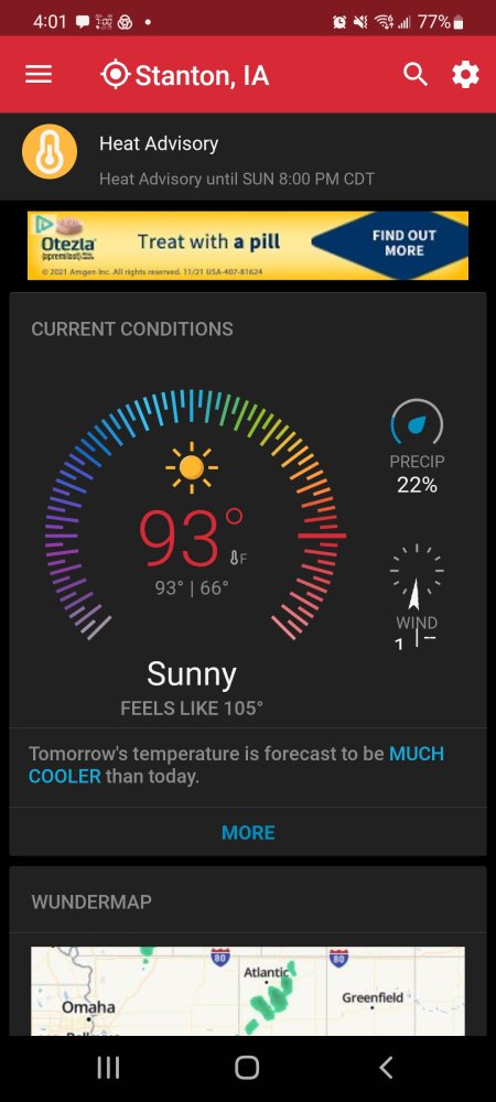

Weatherman said 88 for a high today. I was thinking I was a wimp since it sure seemed a lot hotter than that. It was...

how do you like that rack? i was going to get one for my ranger but i am not sure if it will fit my stepside. i figured i was going to have to cut it a bit to make it fit the 46" wide bed. and than i found it at tractor supply for less so i might get it from them instead.
I like it. I don't think I'd regularly load it up with 800lbs lol but I'm sure it'll haul my canoe around forever just fine. It would be relatively easy to modify to accept brackets for an offroad jack and other things too which is cool.
It would fit your stepside just fine. Your bed could be a foot wide and you'd still be able to get everything bolted together.. but it would be no big deal cutting the cross bars narrower If you wanted. Metal chop saw makes quick work.
that is what i was hoping to hear.
i only need it to pick up lumber from the store every once in a while. the ranger bed is longer than the bed on my crew cab full size but its still to short for 16 footers. i need to a get some 16 and 20 foot 4x4s and 2x8s to start the other car port
Shouldn't being a standard abrasive cutting saw/disc with aluminum. The abrasive generates too much heat, and the aluminum is too soft and can bind up the cutting disk and the disk with shatter. Should use a cold cut saw or band saw, something that uses teeth to cut instead of abrasive material. They do make cut off wheels specifically for aluminum, but I have not tried them and do not know how common they are to see in store.
Very common.
They look just like a wood blade, but are specifically for non ferrous metals. I used them all the time when I worked for an Awning Company. Chop saw for steel, metal cutting blade for aluminum. Cutting steel with the non-ferrous blade will chip the teeth.
Just incase anyone was not away, it can become extremely dangerous very fast.
No bandsaw available and wasn't gonna try with a Sawzall lol.
I was suuuuuuuper easy on the chop saw though, didn't wanna clog up the disk. Never thought about it being possible to bind up though.
Very common.
I was talking about an abrasive cut off wheel for aluminum.
I would rather cut it by hand with a hack saw, aluminum cuts easily enough. I also have a jig saw with metal cutting blades I use for thicker AL.
