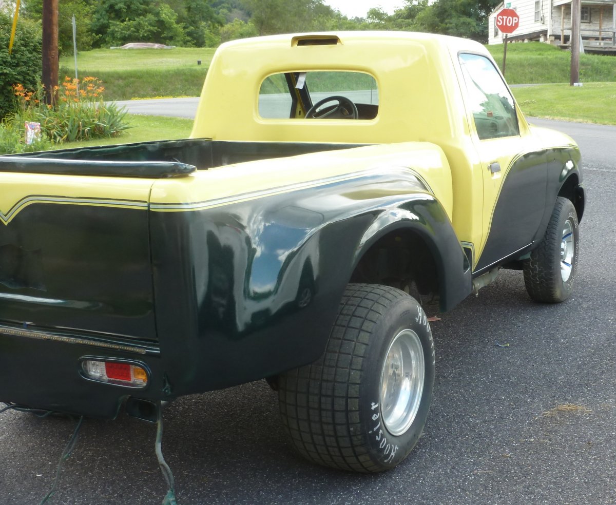

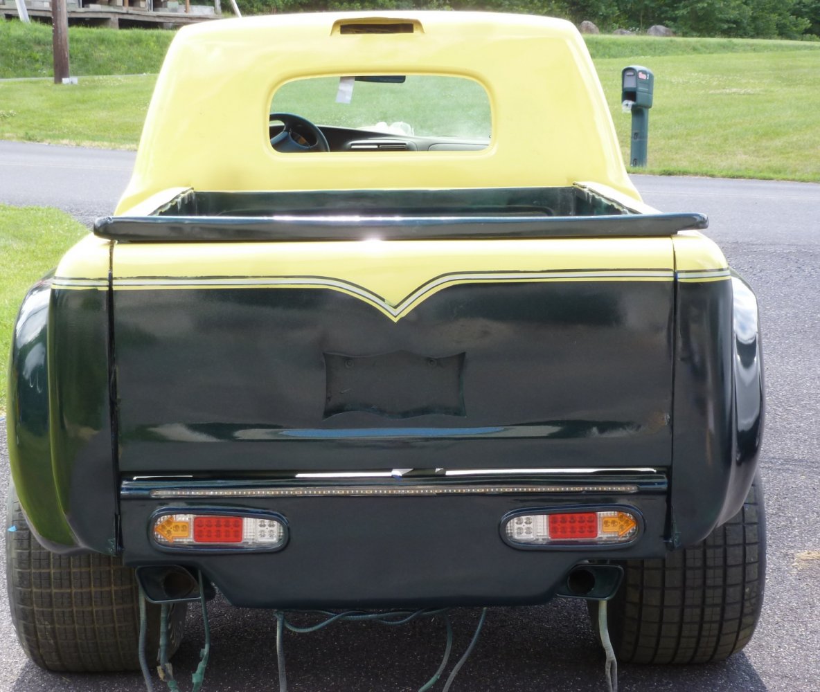

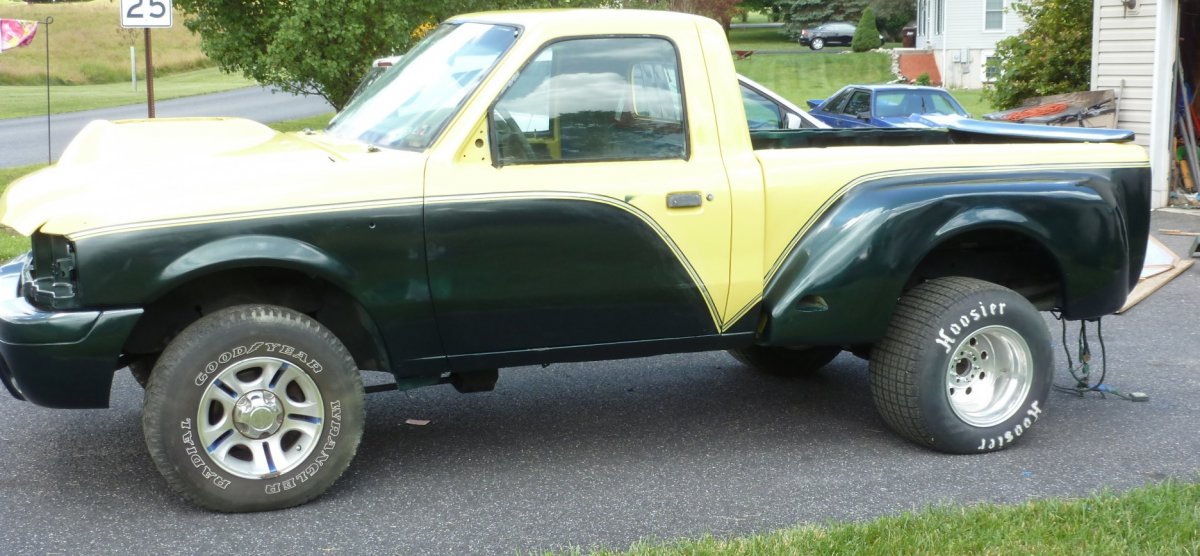

That is an interesting look, kinda Studebaker like from the back. Personally I would have moved the rear window up a couple inches and the tires are a bit small for that stance, but it's definitely not bad and looking forward to seeing where you go with it.

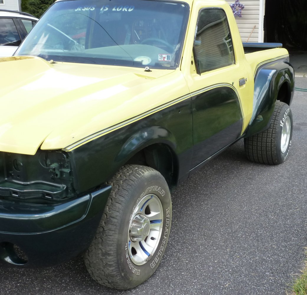

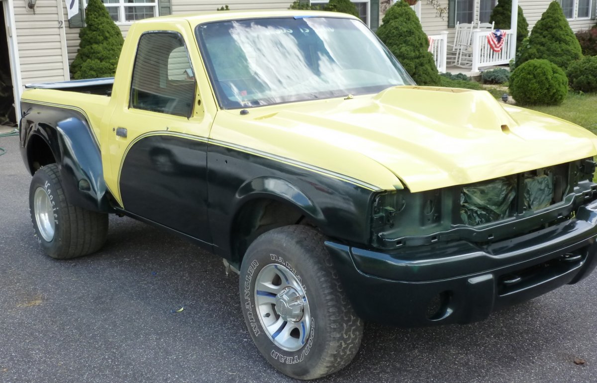

Well here it is , fresh out of the "paint booth". Finished up the paint work yesterday and I think it came out great.

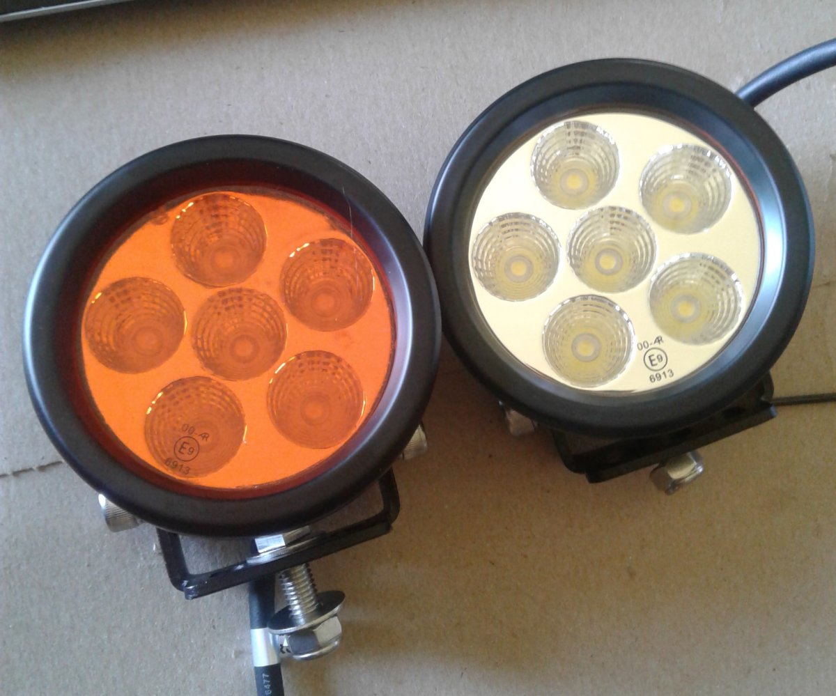

Not sure why... but I've always liked the amber fog lights. Not only do I like them... but they closer match the color of my park lights. So I bought a set of non DOT small clear LED floods (3.5")because nobody seems to make affordable DOT amber fogs. Then I bought some Lamin-X amber film and laid it on. I may do a second layer if the color isn't dark enough when they make it onto the truck. The Lamin-X is like $10 for a 7" x 8" sheet... way thicker then the tape at the parts stores. Hard to get it on without bubbles. They say they will go away... we will find that out also in time.

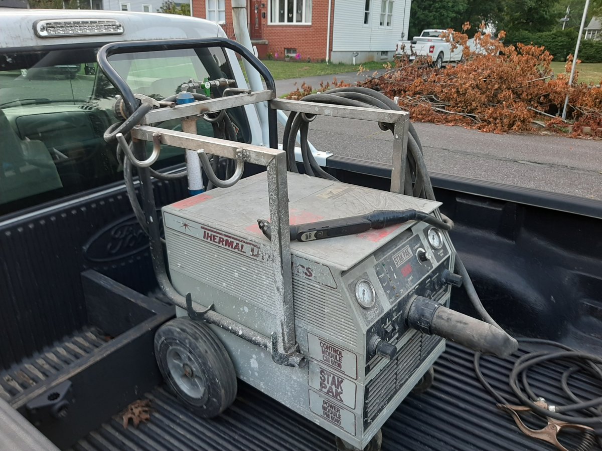

Put this in it... me go cut cut now
Is that a wheelchair for someone with a major incontinence problem?
I guess technically plasma would be an extremely effective way to keep your pants dry. :unsure:

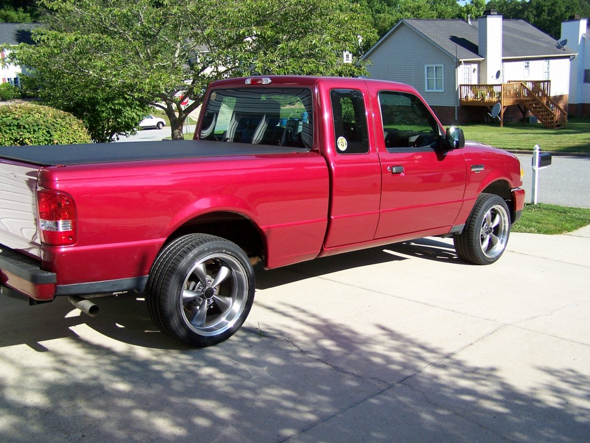

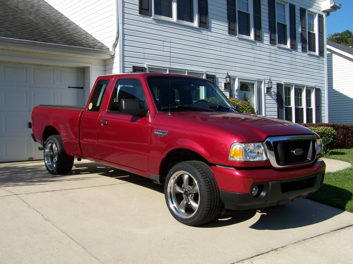

Couldn't wait any longer. Had to put the new wheels and tires on the Ranger. Now It really needs the lowering kit to arrive. 245/45-18 front and 275/40-18 rear. Same diameter 26.7 so no issues with RSC or Traction control.

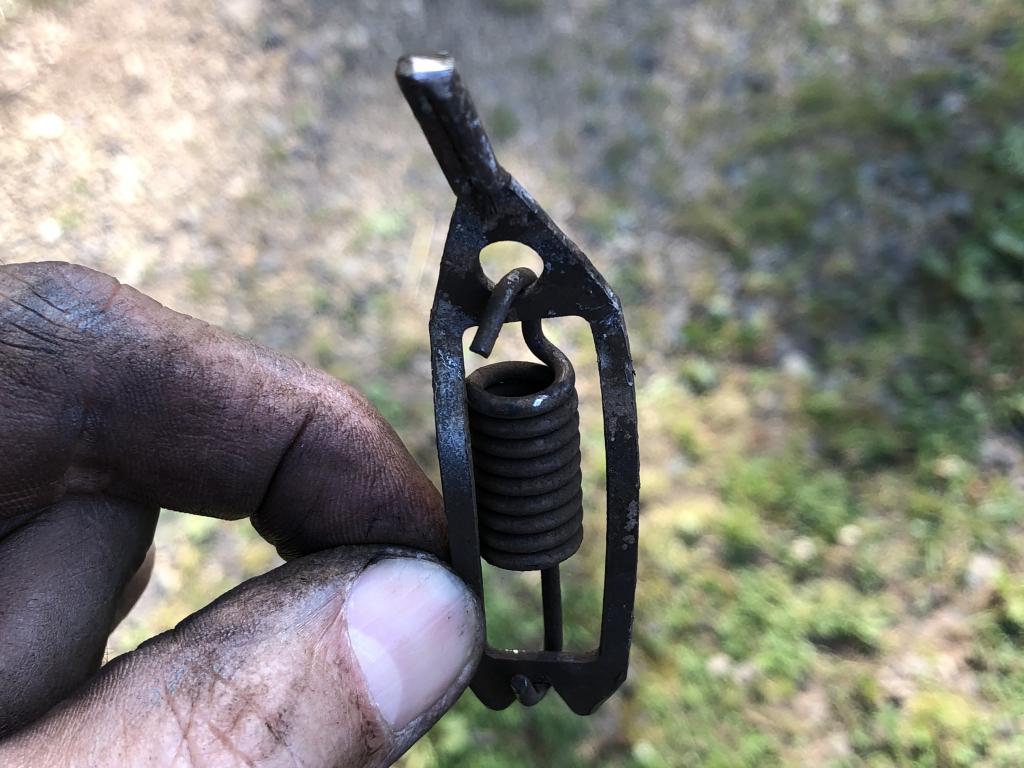

I topped up the rear diff fluid (about 1/2 quart), and of course it made no difference. I stopped at an empty school parking lot to see what I could see, braking in forward and reverse, and then I noticed a new, louder noise that was definitely wheel speed related, and on the right side. So I checked the front wheel bearing and it was fine, and then I jacked up the rear axle. It sounded terrible, with something nasty and crunchy going on in the right rear drum.
It turns out the adjuster cable had broken and the end was busy grinding itself away on the drum:
I picked up a hardware kit at AZ and fixed that, and now all I have is the original higher speed noise, although it is fainter. There is some notchiness, but it is hard to tell if that is the diff or the pinion. Perhaps it's a sign of issues with the pinion shaft bearing, but it's not bad yet and I'm going to let it go for now and keep and eye/ear on it. Overall the rear is quiet while running and the noise I hear is very faint, only audible sometimes with the rear window open when almost at a stop.

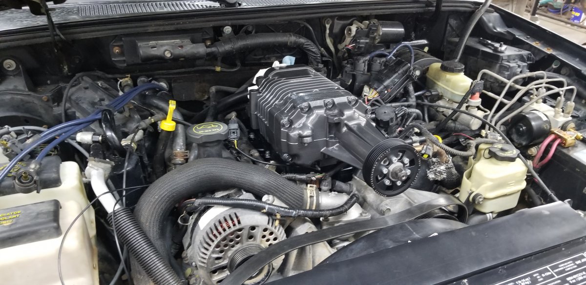

Got a good start. Maybe I'll finish tomorrow. It's not as "plug and play" as I'd hoped, but not too bad.
