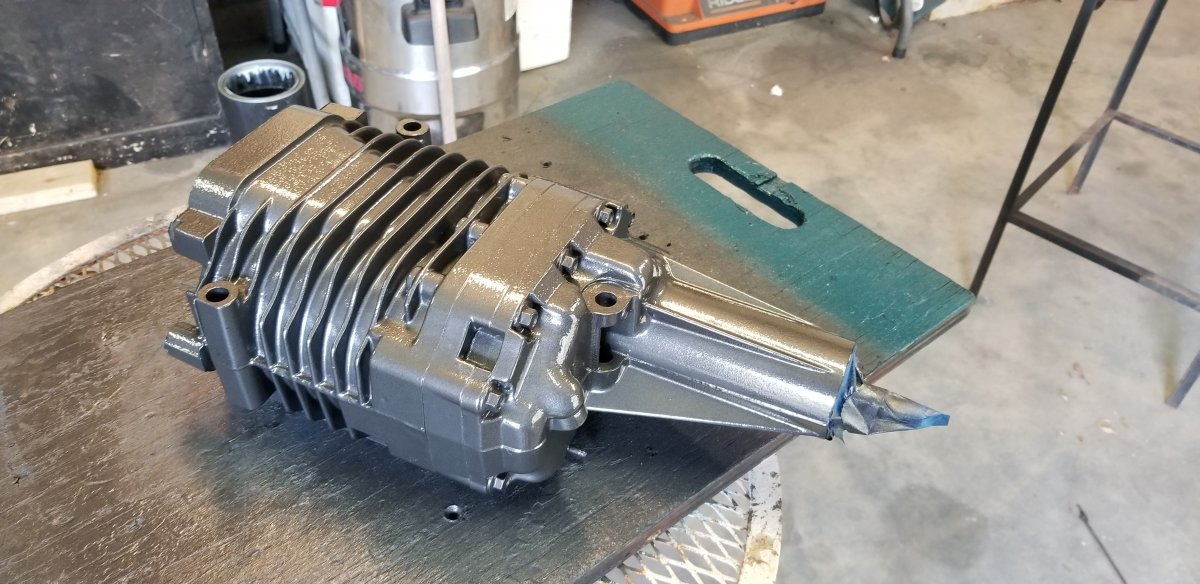

Fresh coat of Hammered Black. Getting closer...

Black? Looks more gunmetal to me.
I agree, but I'd have been lying if I'd said it was Hammered Gunmetal. The can clearly said "black". :ROFLMAO:

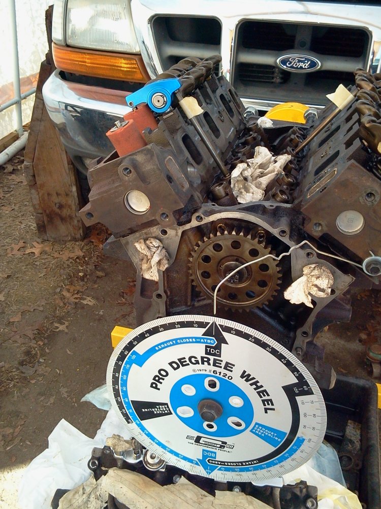

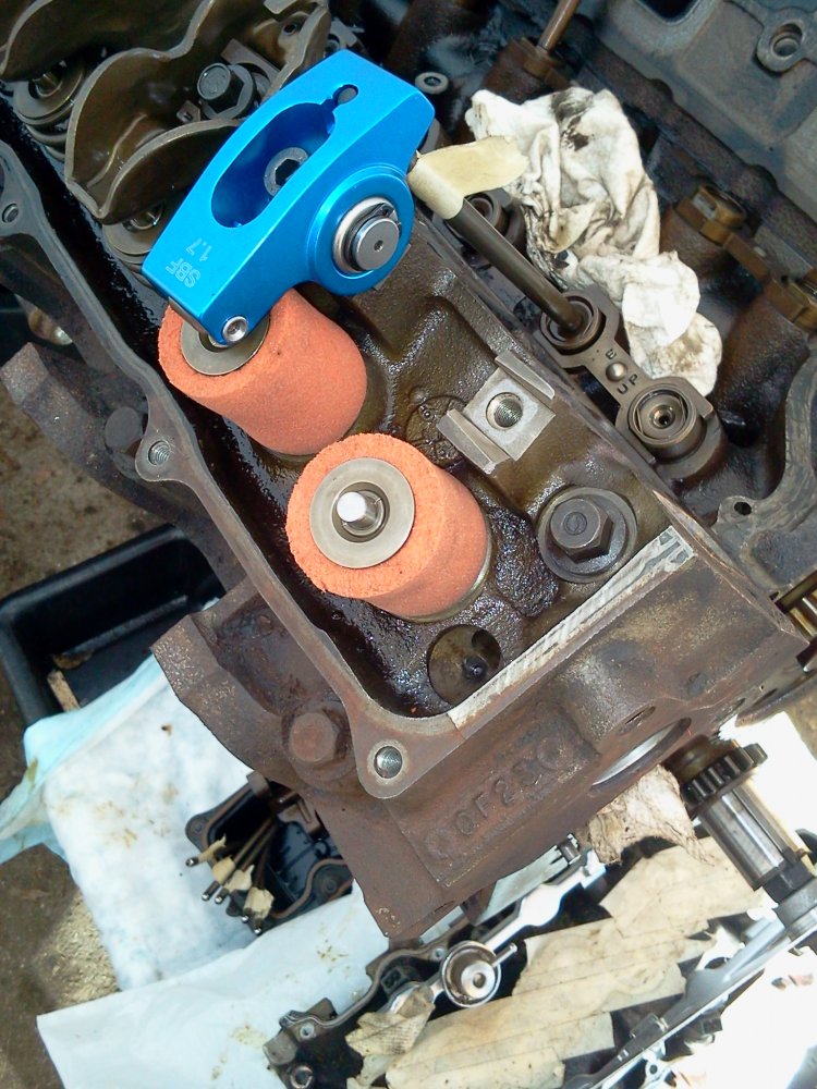

was testing some new rocker arms. had to improvise on the "testing springs"
those are sections of hi temp silicone foam from a roller in some of the copiers I used to service.

they might "bolt on" but there is an issue with a huge lash gap. I'll be needing longer pushrods if I keep the new rockers.
Where did you order that special degree wheel pointer from? I might need one of those.
I have one just like that I got from Acme Corporation. Wile E. Coyote turned me on to the place. All kinds of neat stuff!
Can I ask a dumb Question? (or 2)
@pjtoledo What are those orange spongy looking things, where the springs should be?
that dates back to my days in the Army. the possibility of a massive Electro Whatever Discharge had just been realized
(remember the tubes in a Soviet fighter?) so that has been forever influencing anything I do, maybe. :dntknw:
anyway, notice the subtle curly section of the pointer ??? well, it's not well known but those curls are there to neutralize hi frequency
emissions from suspected Evil Empire sources. No way do I want any static from the Russians influencing my project, I get enough of that from the wiffie!!!!
So there just there to take up space. Ok thanks. Sorry I missed that.
I work in a mail room and I see those rollers all the time, Just had to make sure I was seeing what I thought I was seeing.
they are functional.
works just as good as low strength testing springs.
you can turn the cam by hand, chain removed, to examine rocker and valve functions.
