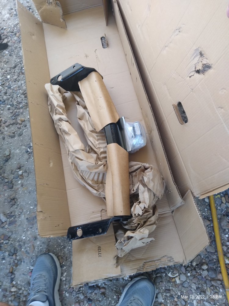

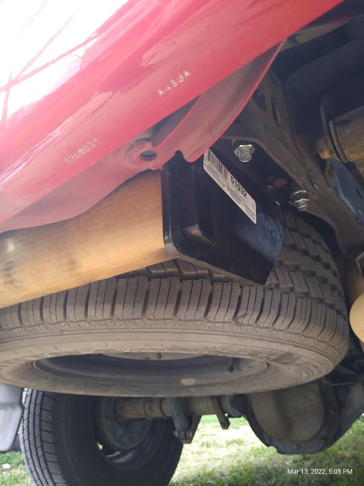

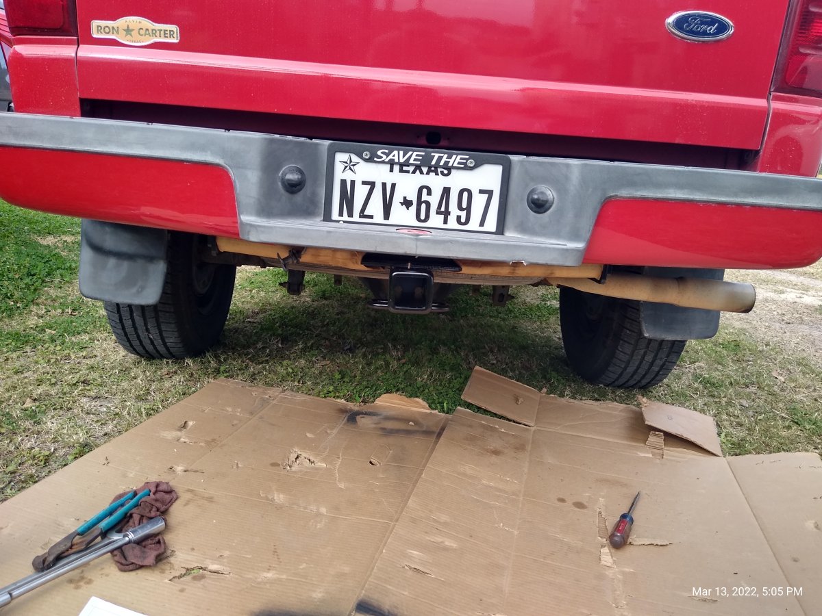

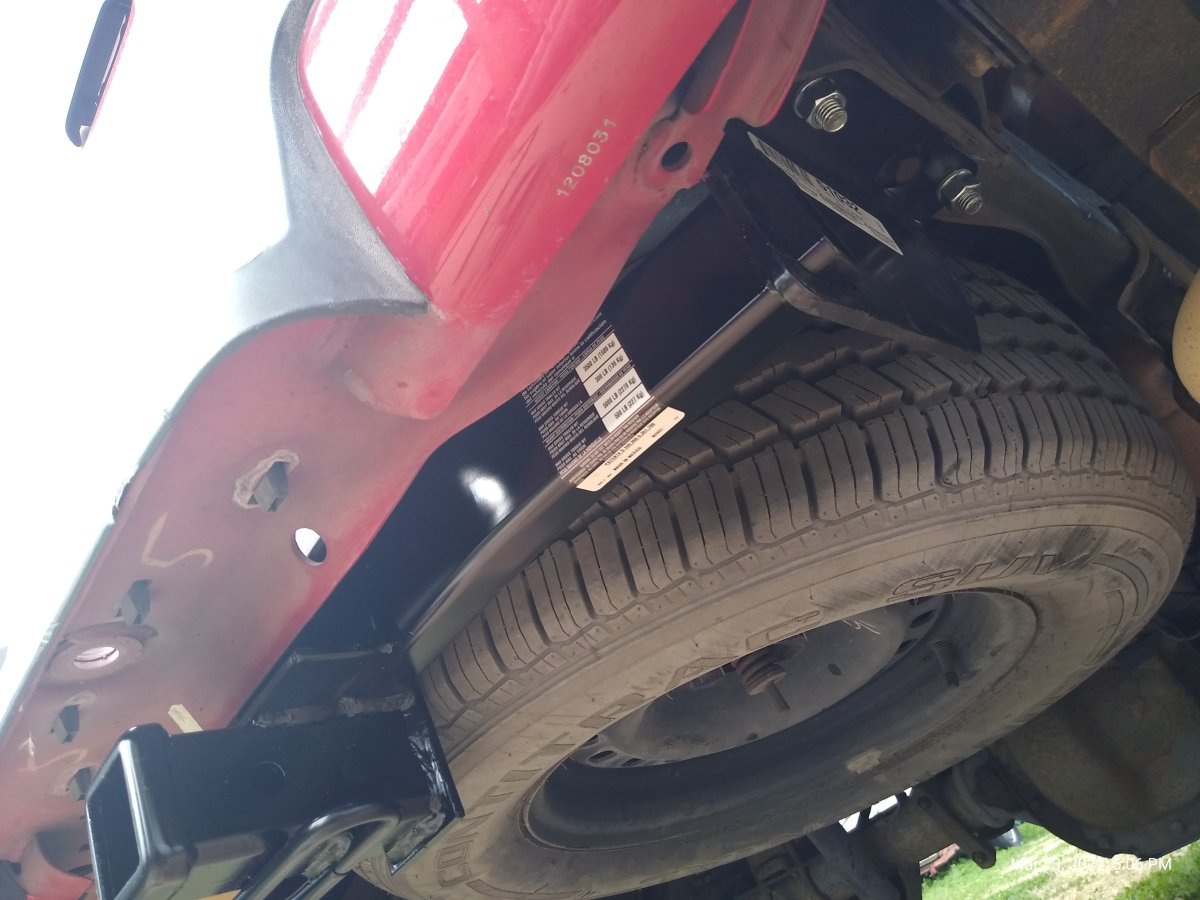

Put a hitch receiver under the back. It's very hard to do with one shoulder unable to support weight. Had to use my knees and right hand to try and hold it in place while the dead left side just threaded the nuts on. I had jack stands on 4x4s holding the bumper in place.
