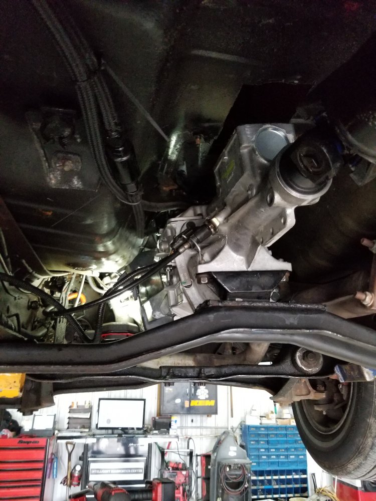

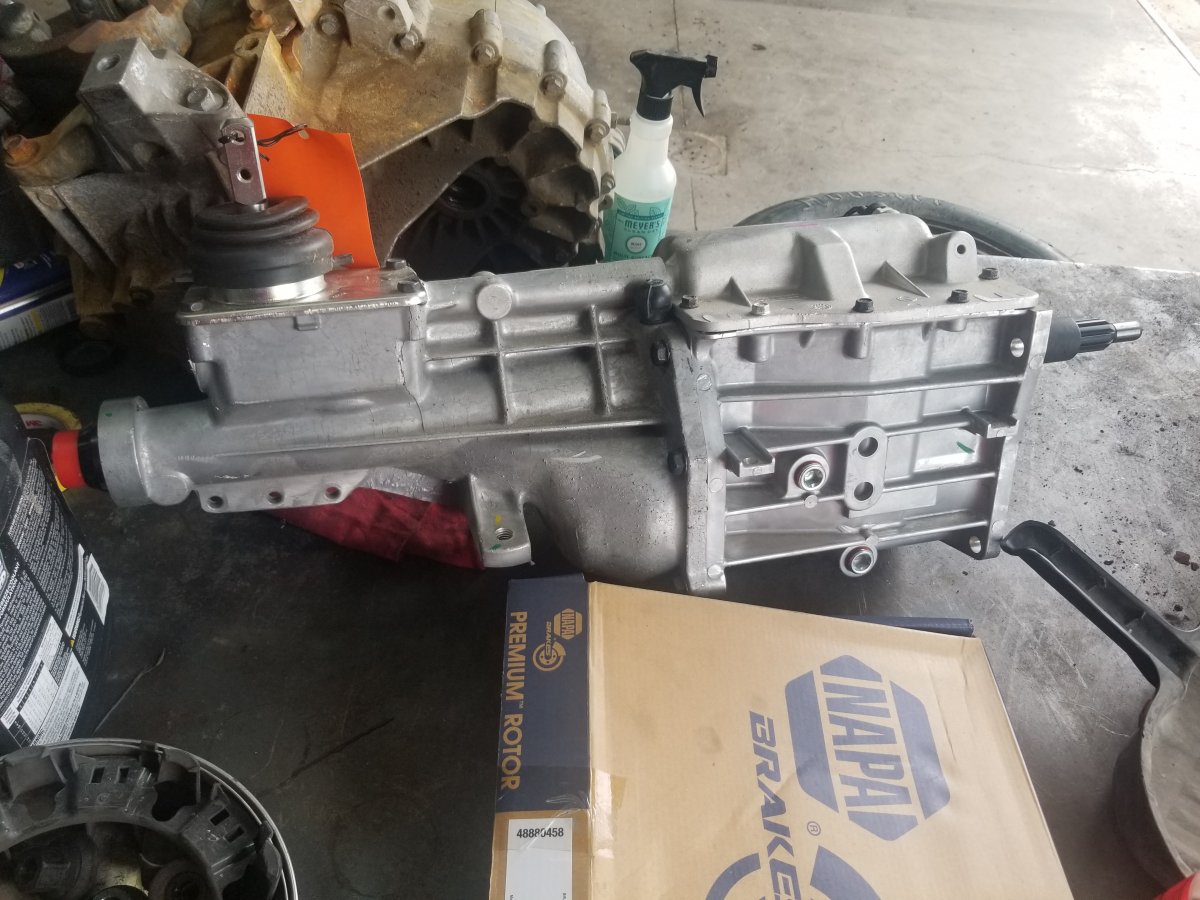

New T5Z is in

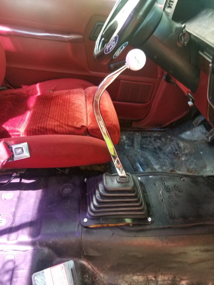

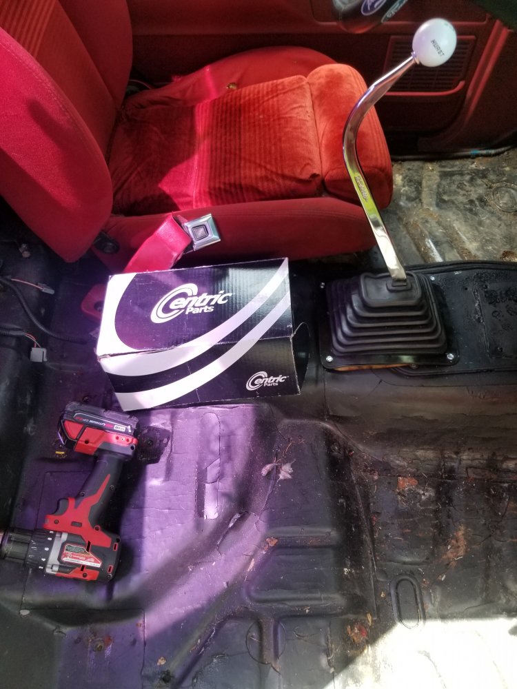

Covered the hole in my floor today. Still waiting for the carpet to come. But all that heat blowing up in the cab made it nearly unbearable to drive.
Good enough for now.
43581
Also check out my awesome new centric console..... it will work until I make or find one I like.
43582
