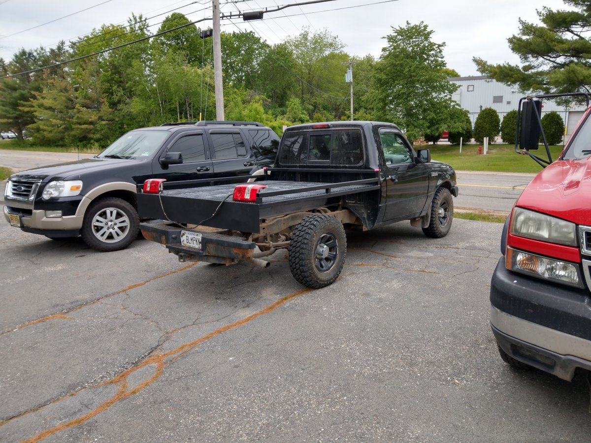

Made enough progress on the flatbed to leave it on the truck. Hopefully it's 100% this weekend.
I need my own garage. It's a bummer having to coordinate with my buddy on his few and far between days off.
