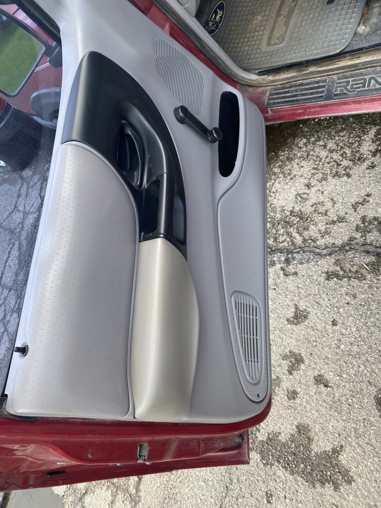

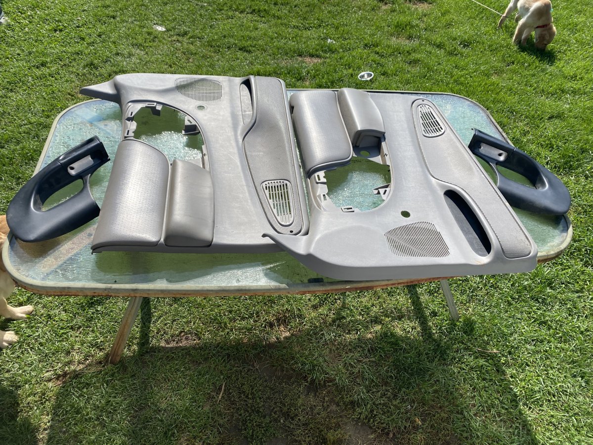

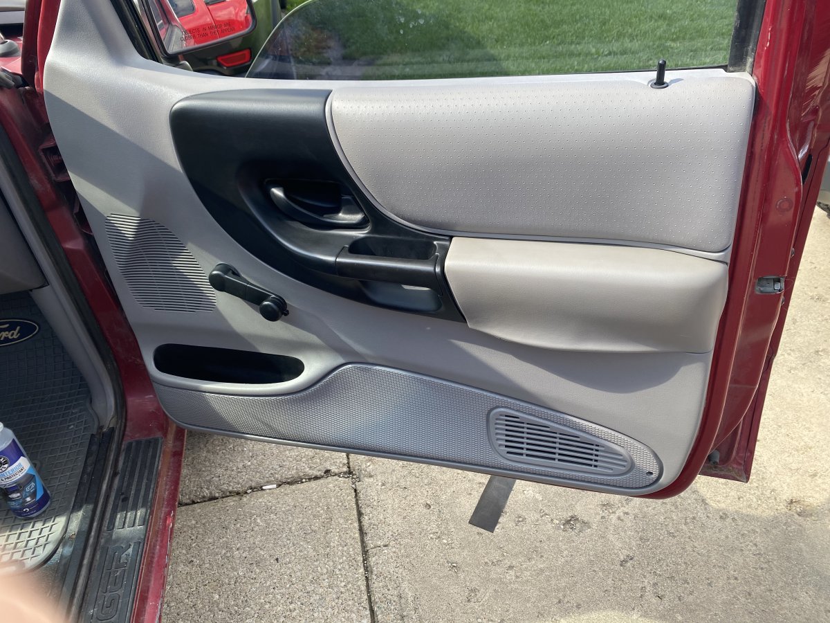

Knocked these out after lunch.
Before
After
Need to glue those pads down at the bottom but theyre on
Looking good Rusty!

They look brand new. Give it up...what's the process?

Depends on how bad it is. These cleaned up with Tuff Stuff and a nylon drill brush. Bad stuff like the arm rest on my console i let soak in a mixture of dawn soap, purple power, and some steam cleaner solution before the Tuff Stuff and drill brush. If you scroll up a bit in the thread i linked youll see the results of my “deep cleaning” process.
