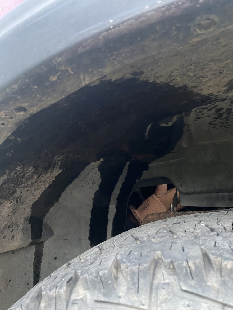

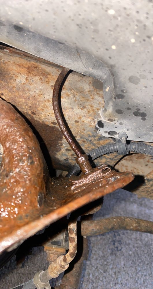

Well if i got to drive mine for a week straight itd be a miracle. Sat most of last week due to battery wiring giving me crap, This week its a brake line, wonder what its got in store for me next week.
Tried to see where its coming from but got a face full of brake fluid. Now that i can see again its definitely coming from somewhere right here lol.

I honestly would just buy enough NiCop line to do the entire truck... when one lets go the others are on borrowed time too. Do all the flex line while you're in there too.
As to what is next... my money is on rear leaf spring hangers and shackles... I mean... you did kinda ask.
Did those already and the rest of the lines have already been done once. Also i have coils on coils of steel line so steel line it is. As rusty as that front passenger coil bucket is itll probably outlast the truck honestly. Once that goes itll either get real expensive or wind up in the junkyard.
I've always used steel line too. I just hear so much about NiCop... the next one I do I'm gonna try it.
I forgot to mention... use care on a couple of the brake line fittings. There are a couple that are odd ball size... and are in the category of unobtainium.
It bends like butter and lasts forever. I nicopped my 79 K20 about 10 years ago and that stuff will be like new when the truck finally does fall apart.
Yeah i mastered the art of brake lines a long time ago. If the lines rusted in the fitting i just drill it out. This is absolutely invaluable also https://www.eastwood.com/universal-...kedid=491598523420&wickedsource=google&wv=3.1
Plus if i did scrap an unobtanium fitting i can crank one out in the Mazak at work no problem.
