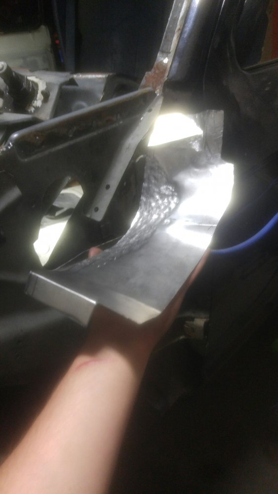

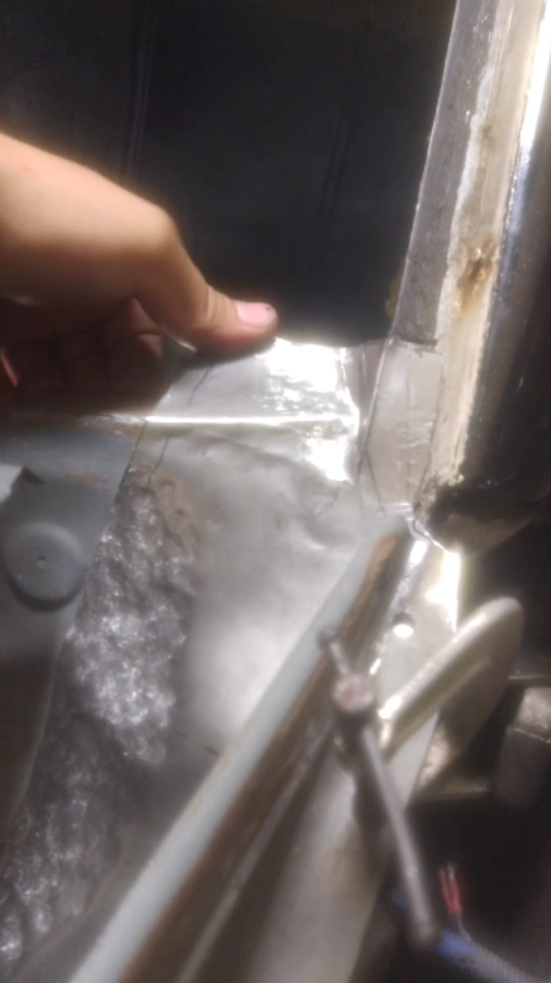

I'm nearly done with the rust repair now. I'm onto the most difficult section of the wiper through. One which I have been putting off as long as possible. I'm having some trouble trying to shape the metal enough with only a hammer.

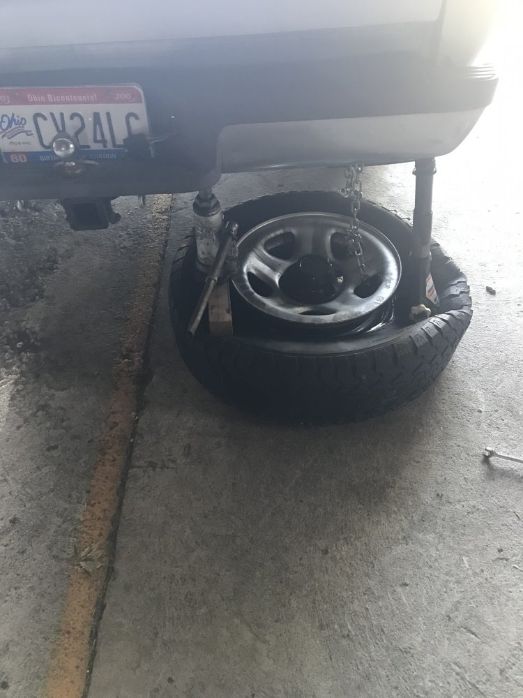

Today I used the ranger as a tire-bead breaker. one of the tires from my trailer had a bad valve stem, happened to have a new one but didnt want to pay a place $10 just to break the bead down & put a new valve in. So with a couple of small jacks & a small chain (so I wasnt raising the truck while trying to push the bead down) I got it all done in a hour. the old ford tire change jack worked great, rather then use the 4ft handle I used a screwdriver with a ratchet wrench on the hex right below the handle

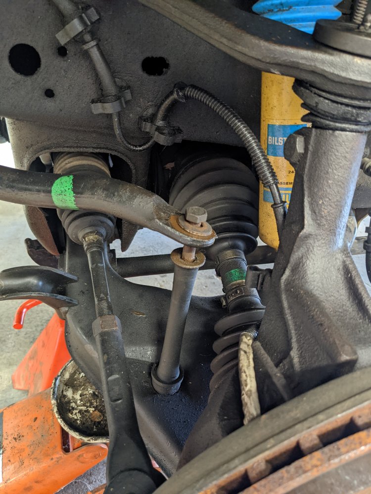

Discovered this:
I'll deal with that tonight sometime... I'd kind of like the sway bar before i spend eighteen hours on the highway this weekend.
You're complaining about a free automatic sway bar disconnect system?!

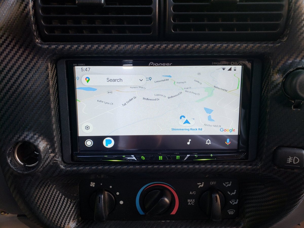

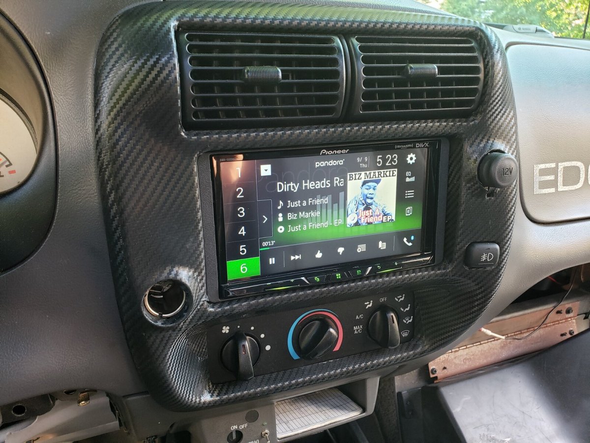

Decided to upgrade my Pioneer Avic D3 in my Ford ranger to something slightly newer...lol.
Pioneer DMH 1500 NEX. It's the same one in the Solara and I'm going to put another one in my STi. I primarily only use the Spotify or Pandora app. And apparently from what I've gathered the newer Pioneer head units do not have these two apps which is a shame because I really like them.
Also has the standard apple carplay in Android Auto.
It's comical to me that my 20-year-old Ford ranger has a newer infotainment system than my 2020 RCF... smh.
-Nigel

The new infotainment system looks great, but one of the things I like about my Ranger is being able to play CDs. Most new cars don't have CD players even as an option any more. Guess I'm a dinosaur.
I guess that makes me a dinosaur too. I love making and playing CD's and my Pioneer touch screen unit does it very well. I wish it had Android Auto though but Bluetooth works just fine. My wife's 2018 Subaru has all the bells and whistles for the phone and she doesn't use any of them but plays CD's all the time.
