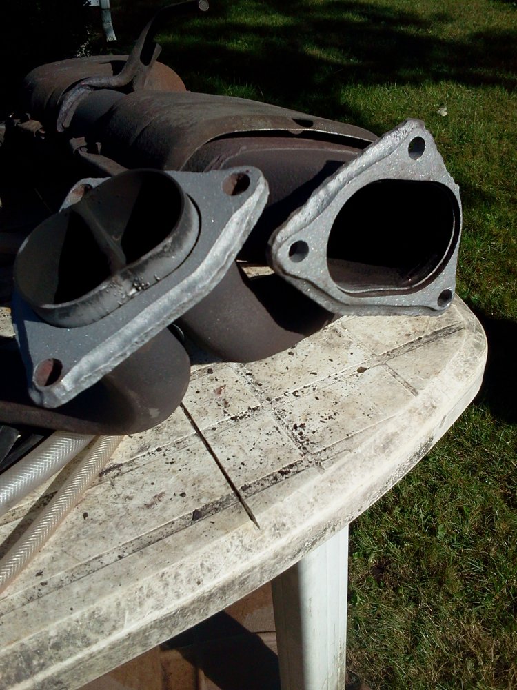

did some blasting on the rusted exhaust flanges.
used the black grit stuff, and a punch for the hard rust boogers.
there is a lot of metal missing, the gasket doesn't even come close on two sides.
time to find a welder.
this is a 2000 3.0, rust belt special.

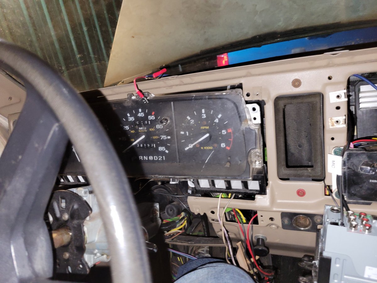

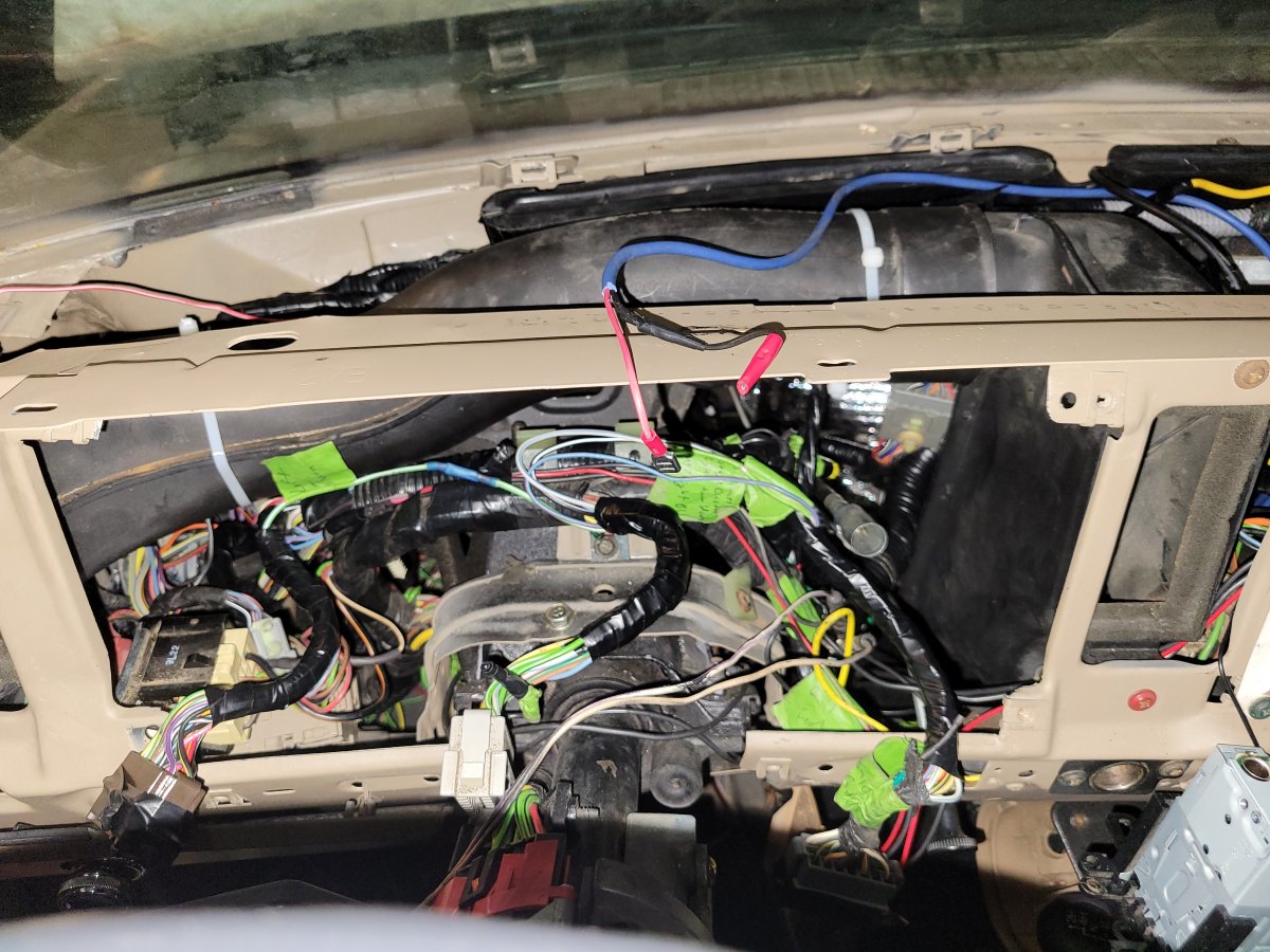

Didn't make as much progress as I planned, had baby duty while my wife cleaned this morning, than went and fixed the pass. Front door handle on my father in laws 98 explorer. Crazy how if the handle return springs fail, it prevents the actuator from falling enough to unbind the lock mechanism. Anyway I started putting the final touches on the dash wiring. Wireless ignition is wired in to the 4.0 harness, all indicator light, dash light wiring from the 83 guage cluster plug, is wired into the 4.0 guage cluster plugs some pics of how the wiring behind the guages looks now, and a pic of how it will look with the 91 cluster I. Place sort of. No pics of the 4x4 controler, or my wireless start system, I dont want to show how it's wired for security reasons. If anyone would like more info in what I use I will post more in my build log.

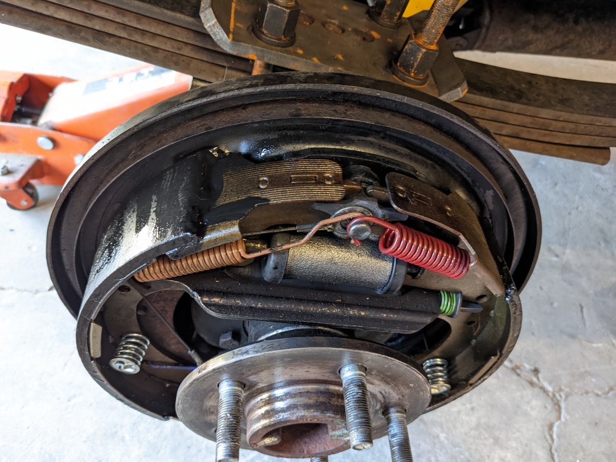

Looks like i forgot new wheel seals before the axle swap. Time to find a new set of shoes and seals tonight so I can get home!

Got the new seal on and finally got the parking brake cable connected, but the passenger wheel was hot when I got home and the e brake isn't holding. If I'm driving to Indiana on Friday, someone else will have to sort this out for me.
Just pretend you didn't notice the wheel getting hot and use park like a normal person.
Easy fix!
I really may leave it disconnected for the time being.
