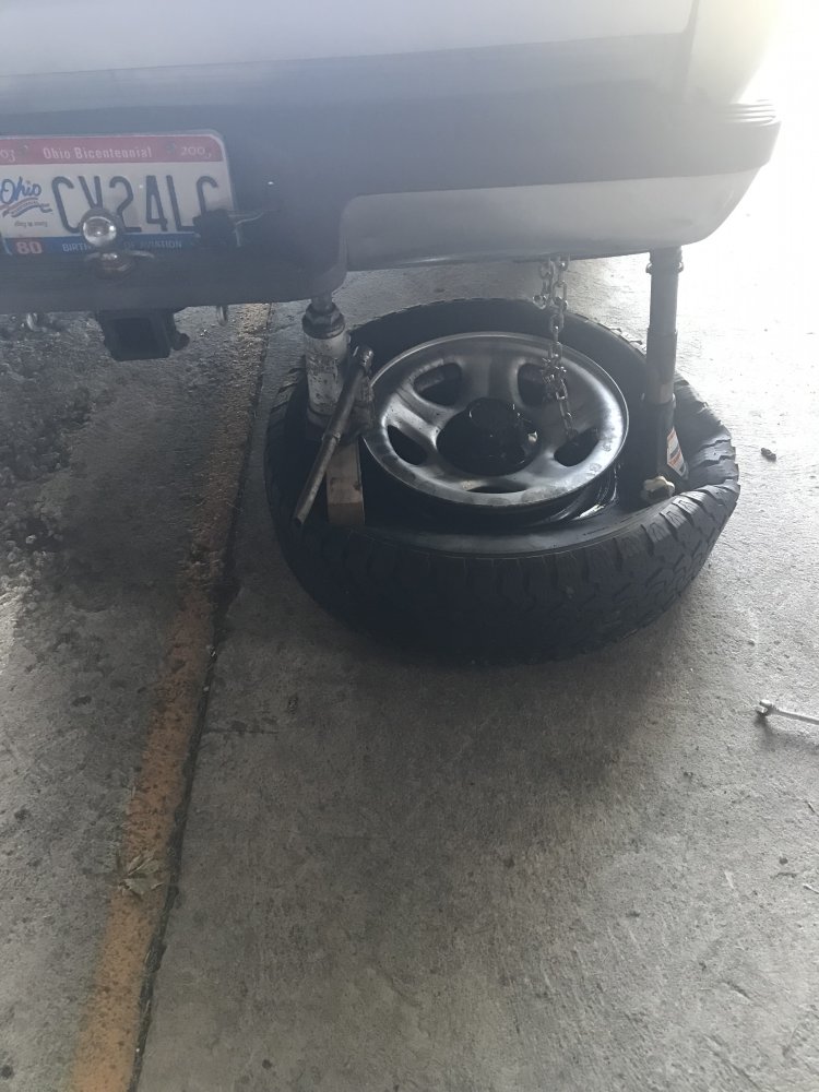

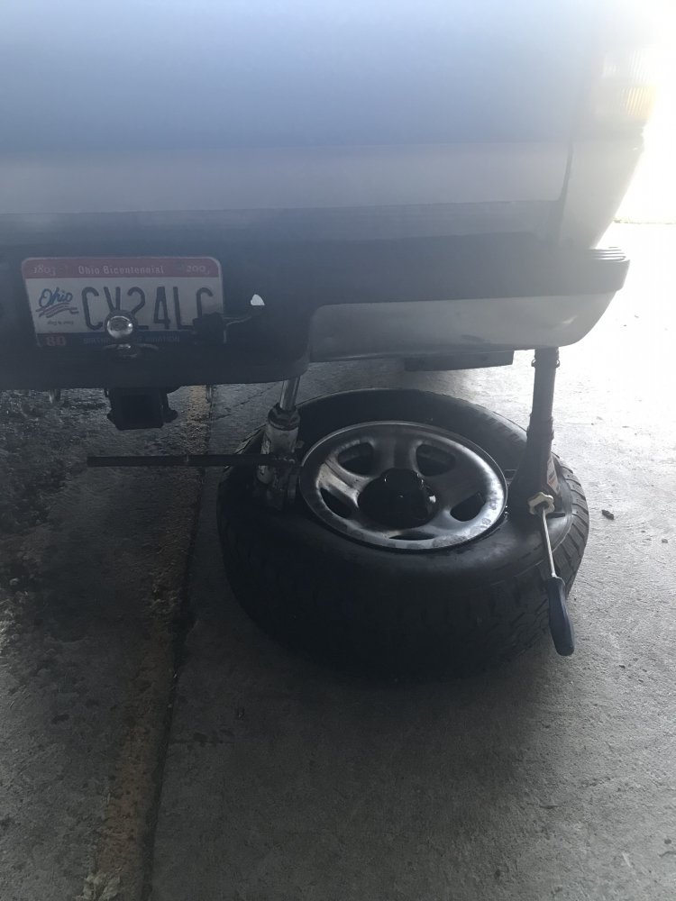

Today I used the ranger as a tire-bead breaker. one of the tires from my trailer had a bad valve stem, happened to have a new one but didnt want to pay a place $10 just to break the bead down & put a new valve in. So with a couple of small jacks & a small chain (so I wasnt raising the truck while trying to push the bead down) I got it all done in a hour. the old ford tire change jack worked great, rather then use the 4ft handle I used a screwdriver with a ratchet wrench on the hex right below the handle
View attachment 65340View attachment 65341
I like to use a high lift jack for breaking beads. I put it in the hitch receiver and get after it.

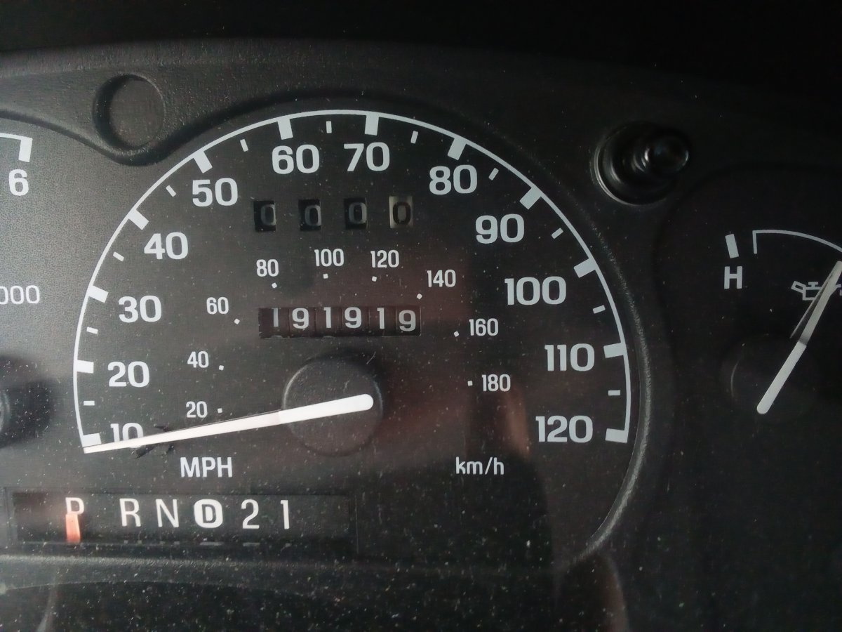

Not today but a few weeks back:
Actually turned 194k this week.

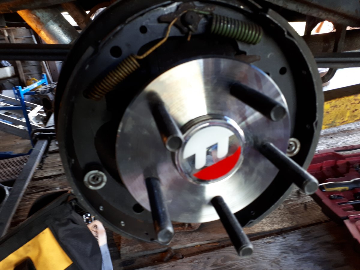

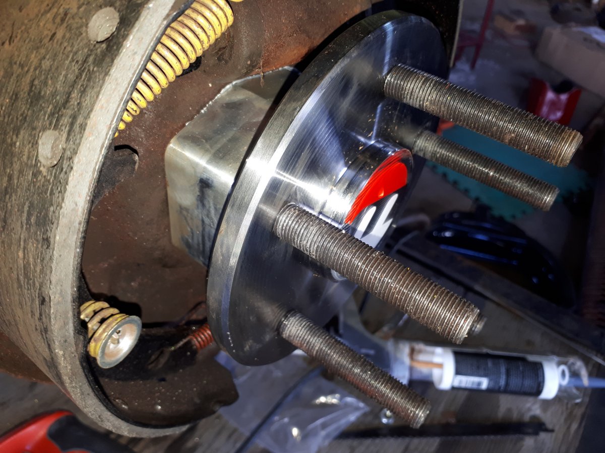

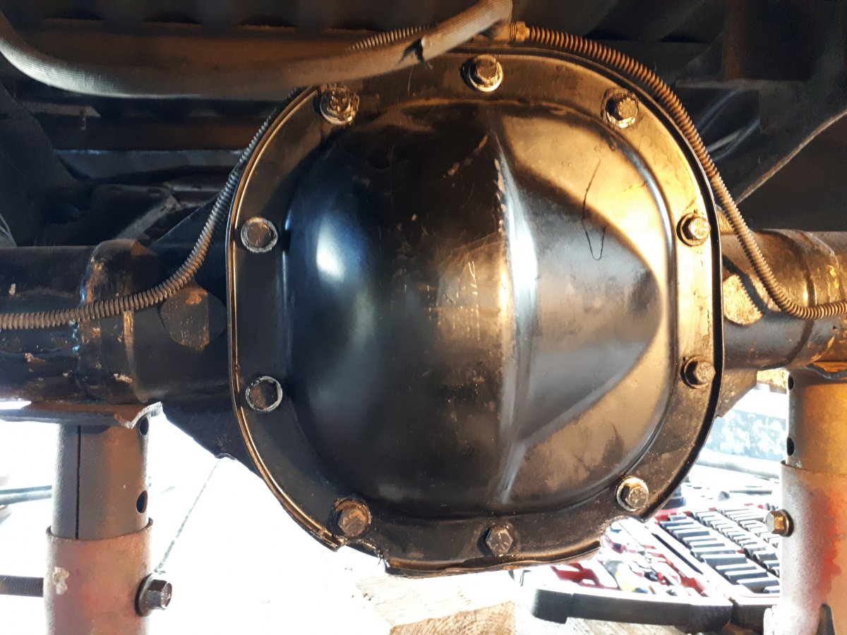

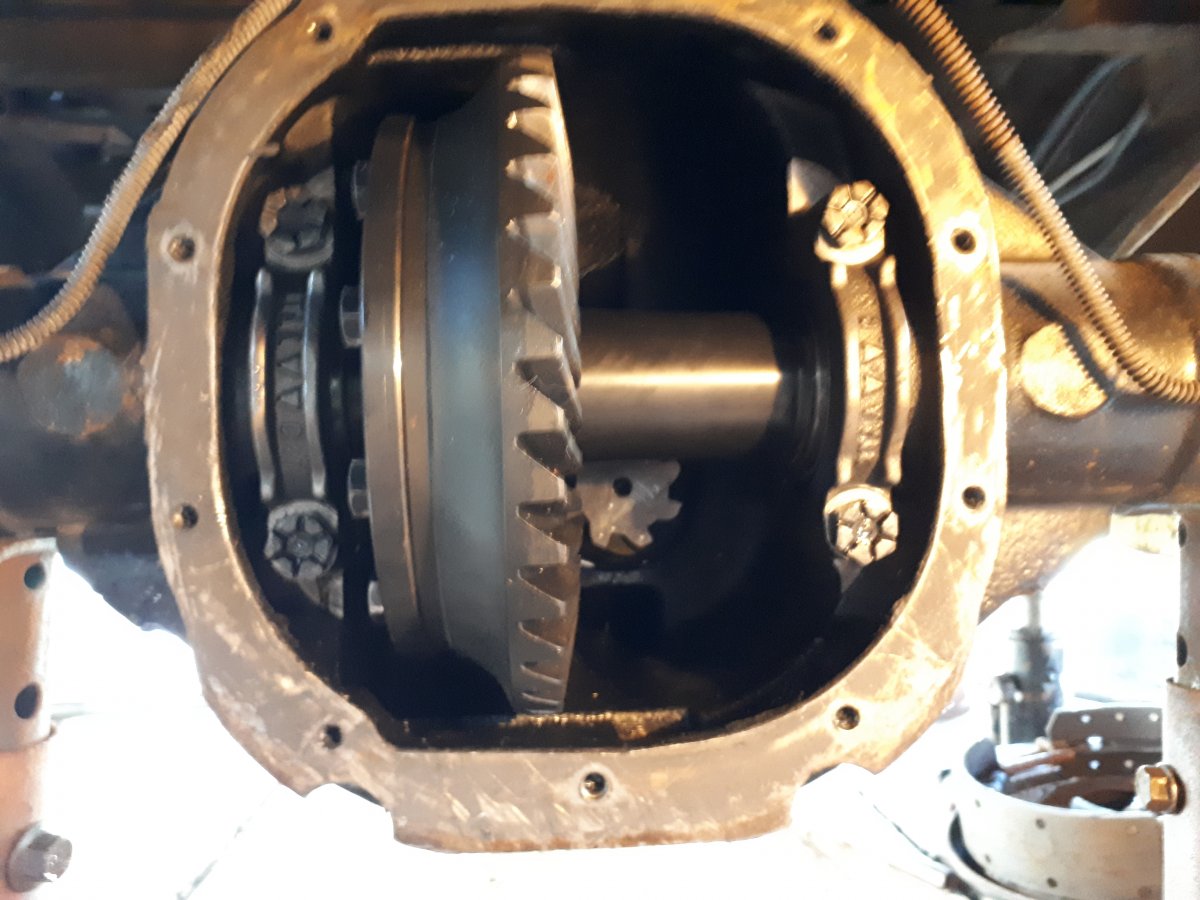

Got new Moser spool, axles and c-clip eliminator all together now. I just need to put gear oil in the rearend, bleed the brakes and put the wheels back on.
