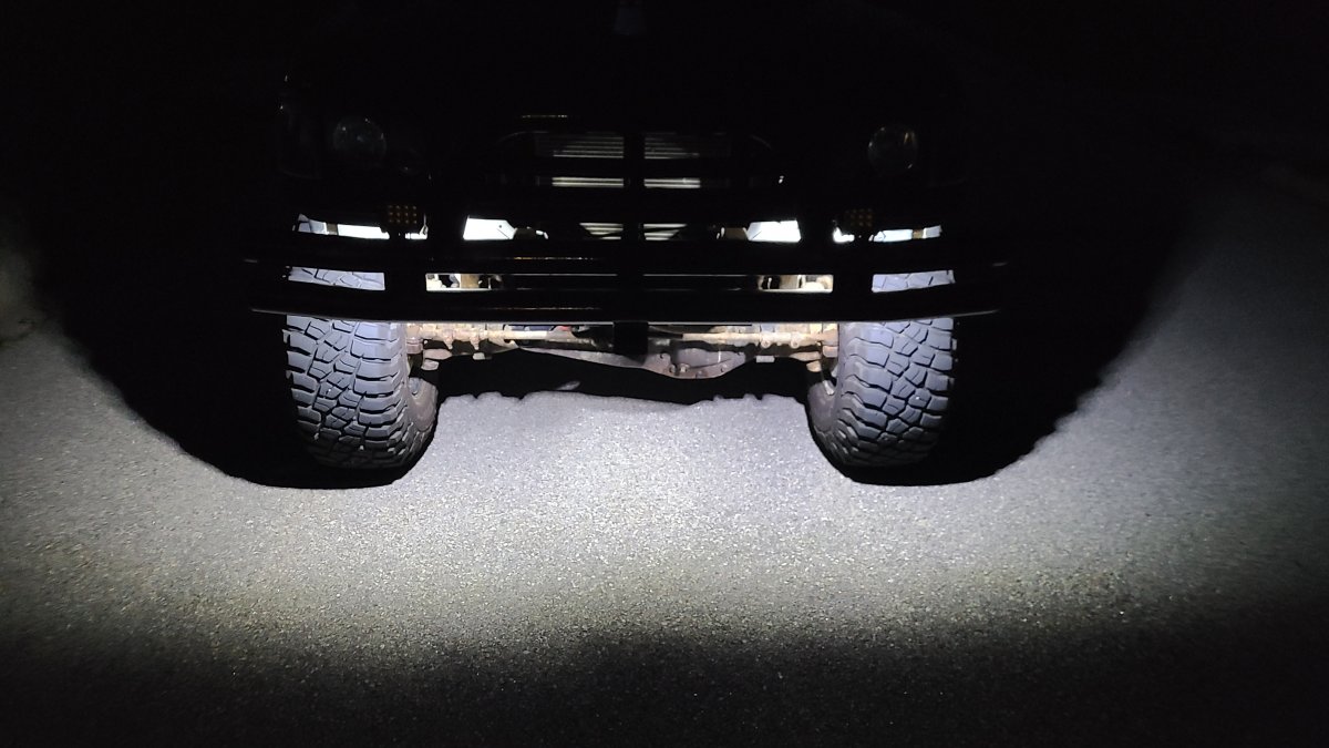

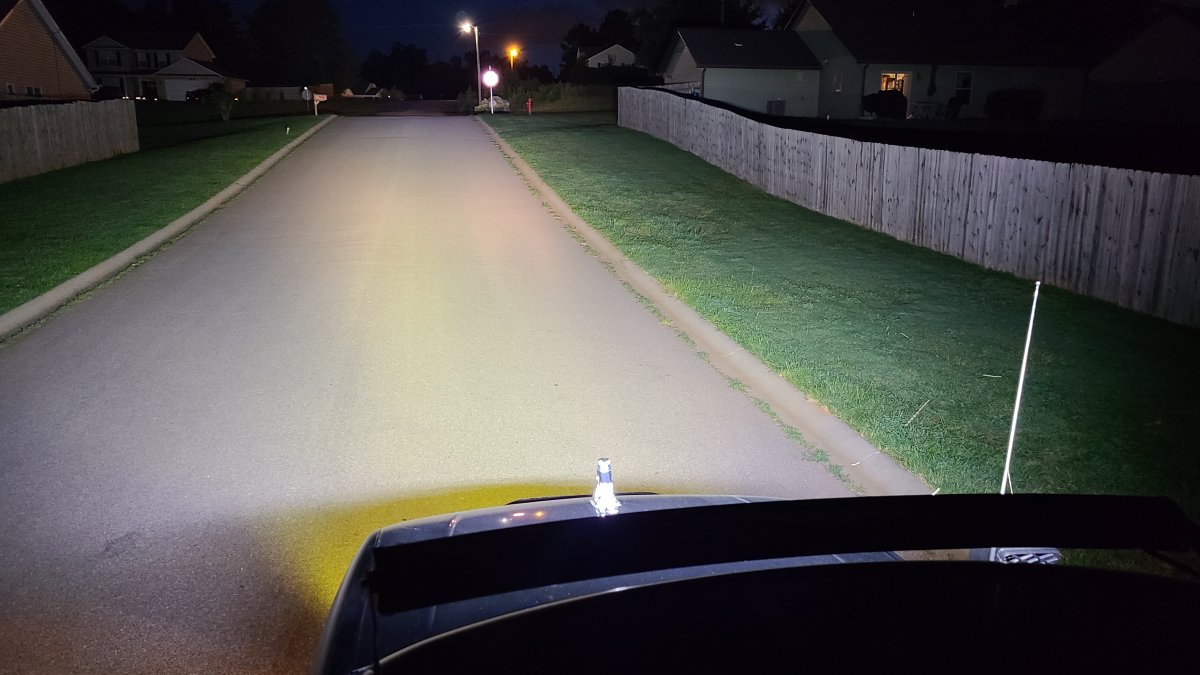

Just took some pictures of it. Installed a pair of rock lights at the front end. Will be adding others later.
The rock lights.
View over the cab with headlights, fog lights, front rock lights and light bar all turned on.
Dumb question. Why would you need to light up under the truck? You can't see underneath when you're driving anyway.
For the guide that is giving you directions over the obstacles.
As mentioned above, it helps the spotters. Also helps the driver/passenger when they lean out the window to look.
And, good work lights if you have to change a tire or fix something.
