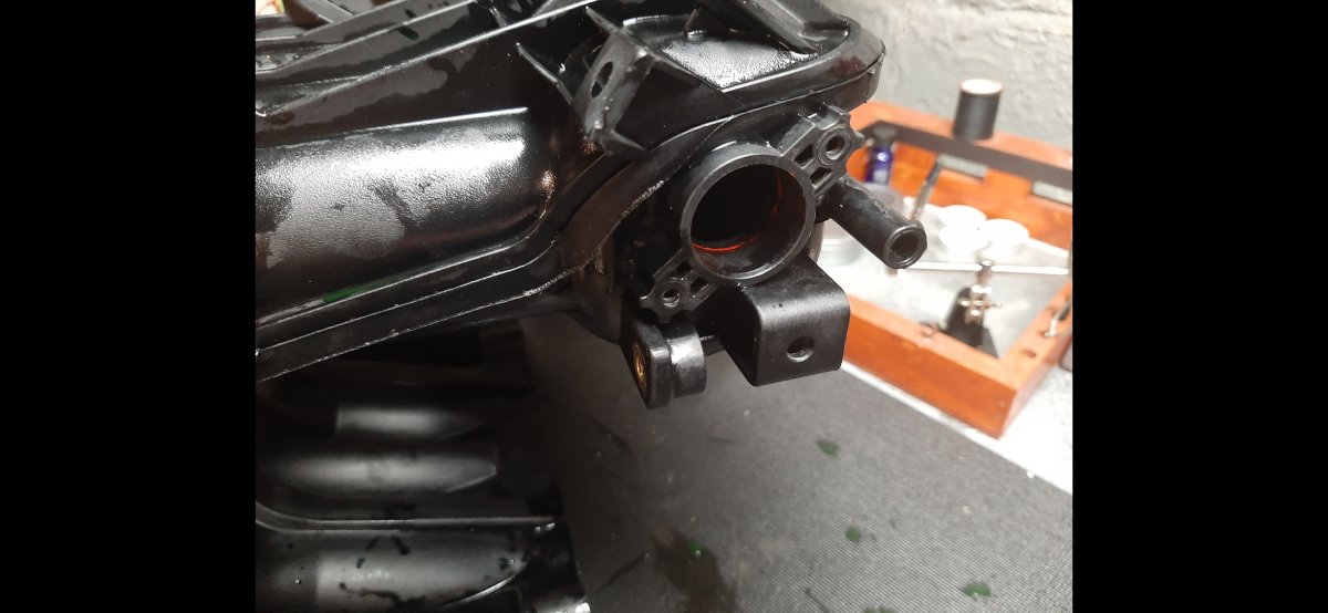

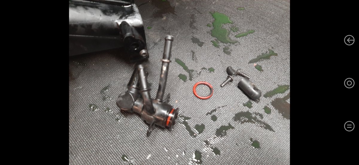

And its apart again... something didn't seem right after a drive and the idle was a little high. Uplugged the IAC valve and nothing changed. UGH vacuum leak!
Did a quick check that everything was tight but nothing seemed wrong so out came the smoke machine. Smoke came right from the back of the intake in an impossible place to work on so the maifold had to come back off.
Only thing there is the weird heated pcv valve nipple which was quite loose and the oring is basically flat so 99% sure thats the culprit.
