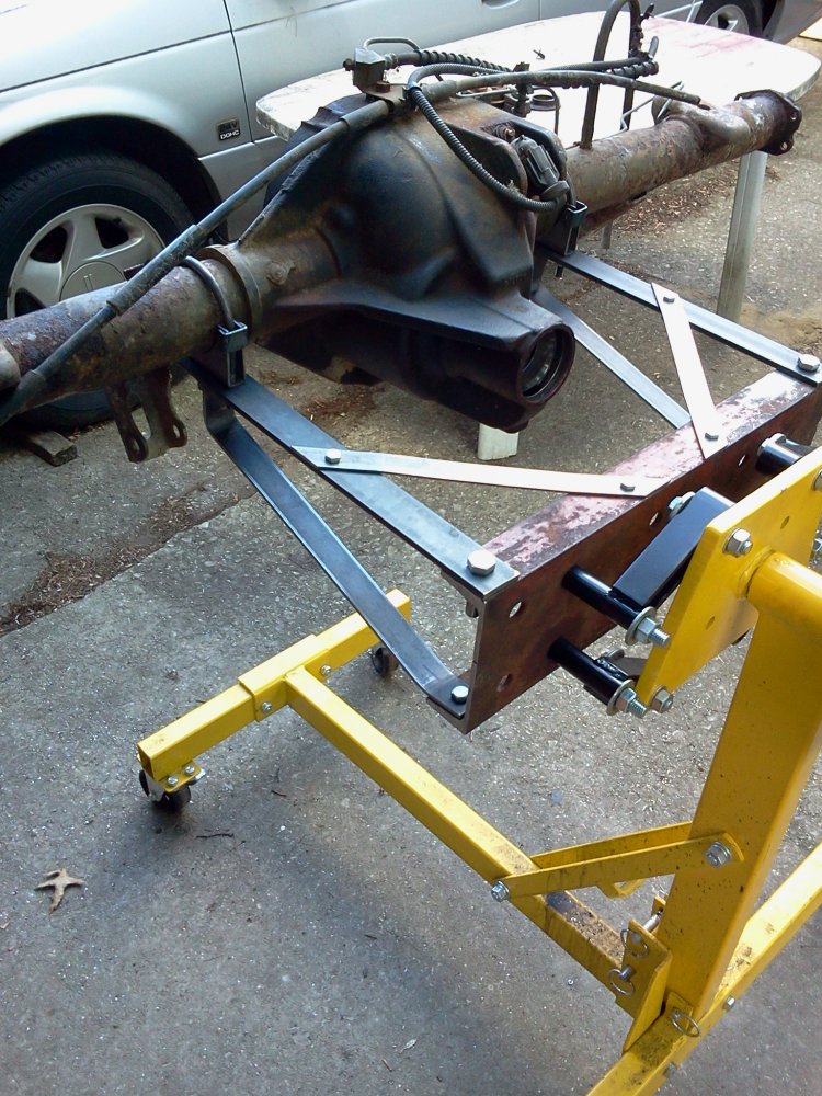

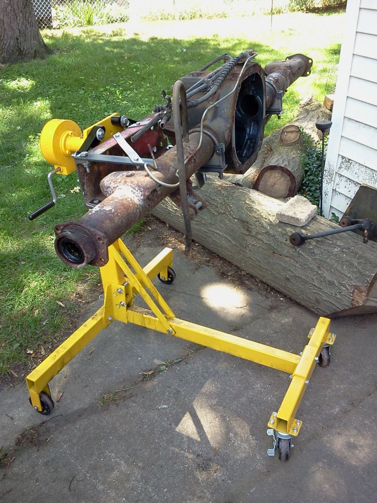

gathered up some spare metal and commenced to drillin' cuttin' & bending.
@racsan that piece of red steel should look familiar.
yes, glad you found a use for it, that was originally part of a cultiimulcher frame, more of it was used on my ranger to reinforce the rear frame.
Is that the 3.45 / 7.5 I sent with you too? If youre going to use it the right shaft bearing surface doesnt look very good, might be a good place for a speedi-sleeve. I know youre aware of the seal leak on the right side, dont think I remembered to tell you about that axle shaft.

getting those bolts out was a challenge. had to resort to 3/4 drive tools then grind some welds.
that's an 8.8 I bought from a yard quite a few years ago.
