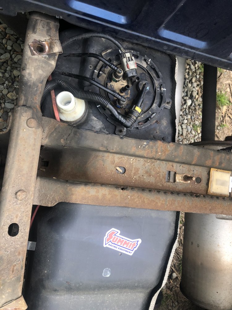

Got it back running. A walbro 255lph fuel pump overnight from summit was less then the el cheap sender from Napa. Dropped right in and fired right up.

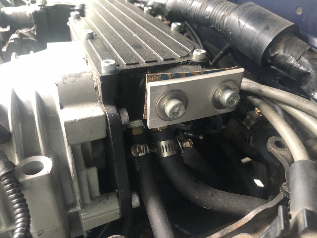

My egr extension was broke, the replacement from ModdBox is going to take a week coming from Canadia, so I made a temporary egr delete.

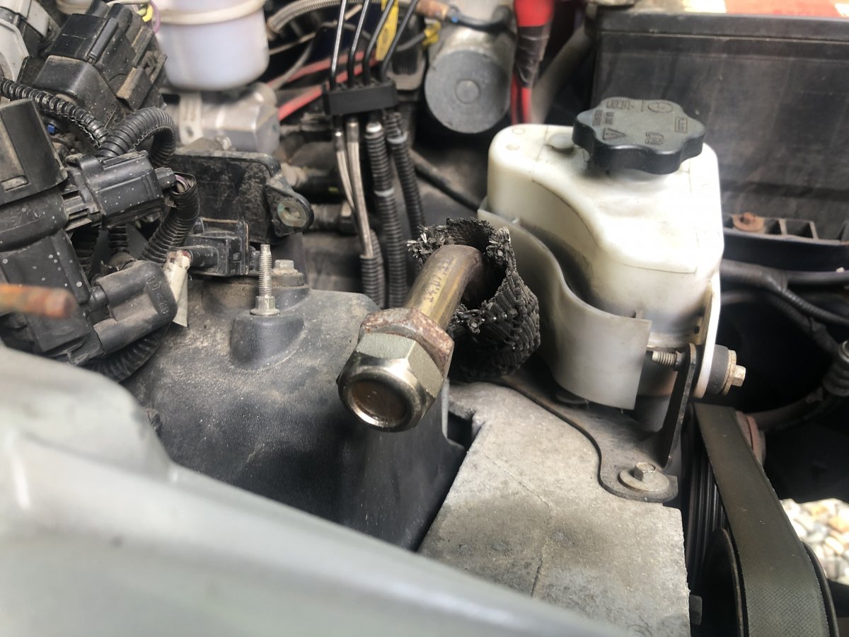

Was able to cap the egr tube with a penny set inside the jam but from the extension tube.
Got it back running. A walbro 255lph fuel pump overnight from summit was less then the el cheap sender from Napa. Dropped right in and fired right up. View attachment 60573
My egr extension was broke, the replacement from ModdBox is going to take a week coming from Canadia, so I made a temporary egr delete. View attachment 60574View attachment 60575
Mine broke a while back, but I was able to weld it back together. It broke right at the connection to the EGR valve. Had it not been easy, I'd have deleted the valve and got custom tuning, which I'm probably going to do eventually anyway.

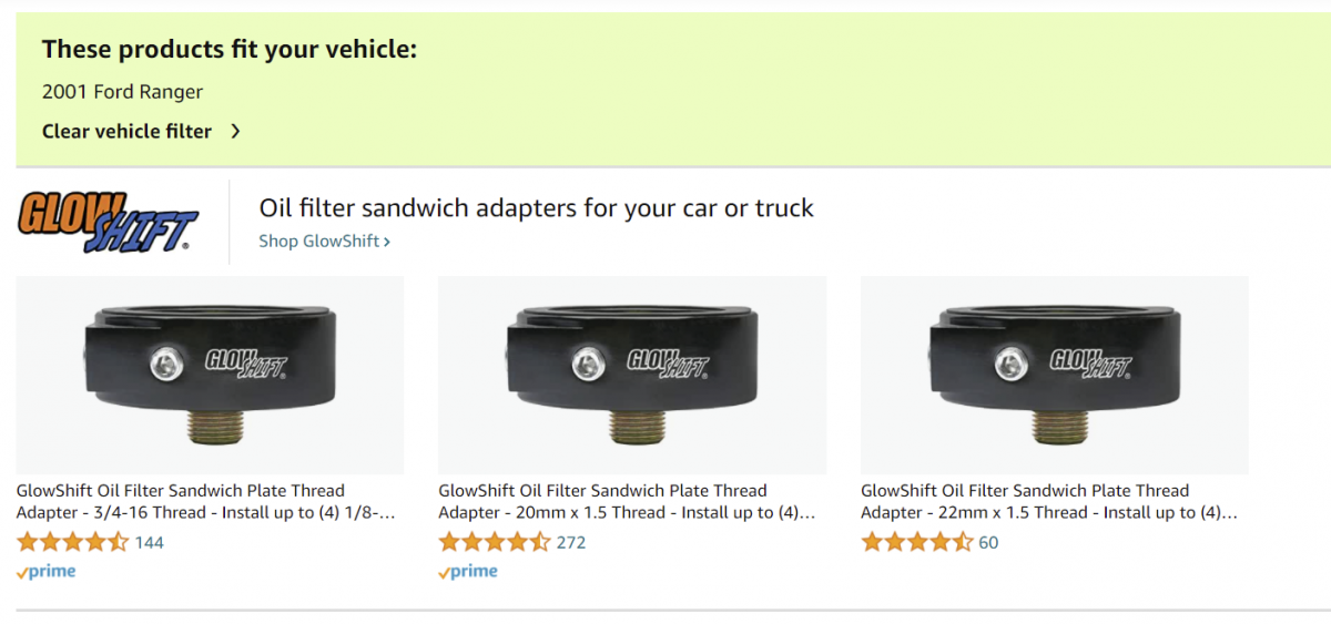

Amazon says all three of these fit. I have my doubts.
60704

@G8orFord It's the 22mmx1.5...
That is for the 4.0L SOHC
