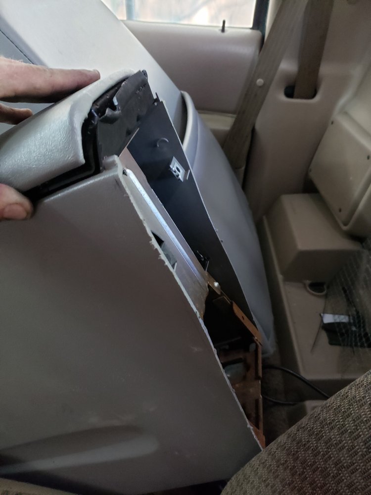

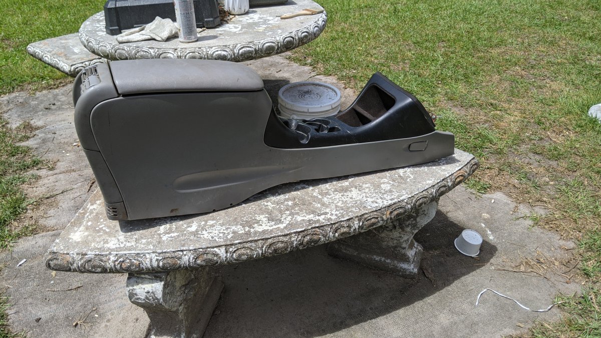

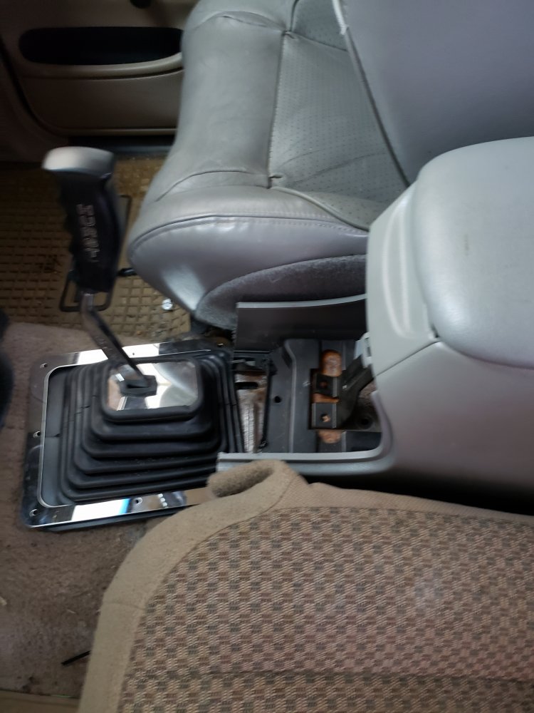

I just hacked one up with Sawzall to fit behind shifter of t5

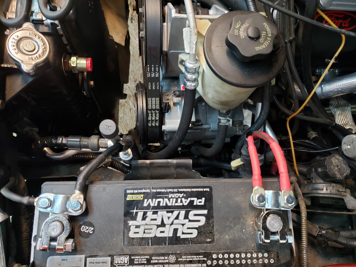

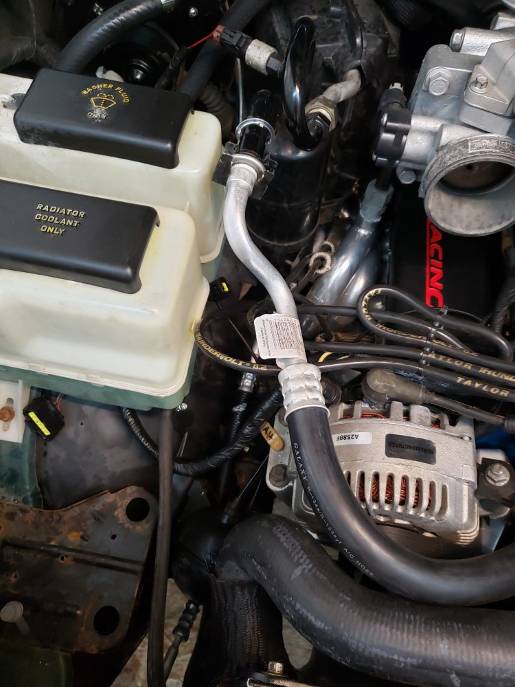

New compressor, ac hoses, battery terminals w/ soldered ring eyes. And of course a few pics of my cuts for dirtman, not from the corner either.
