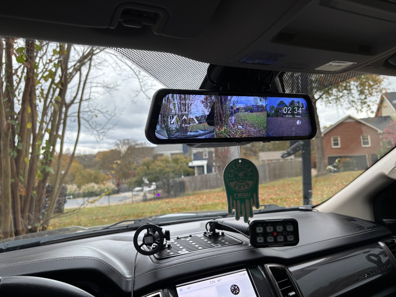

Over last couple of weeks I have installed an off-road camera system, dash mounting system, and half of the switch panel. I am thinking about moving the camera system display from the mirror to putting it on the new dash mounting system. The factory mirror mount is very integrated into the truck and obstructs the inside cameras view. I need to fabricate a mount for the fuse panel under the hood. There is not a lot of space to work with under the hood. Any thoughts?

Over last couple of weeks I have installed an off-road camera system, dash mounting system, and half of the switch panel. I am thinking about moving the camera system display from the mirror to putting it on the new dash mounting system. The factory mirror mount is very integrated into the truck and obstructs the inside cameras view. I need to fabricate a mount for the fuse panel under the hood. There is not a lot of space to work with under the hood. Any thoughts?View attachment 135954
That the Wolfbox?
I'd like to get stuck wolfbox, but man they're expensive.
