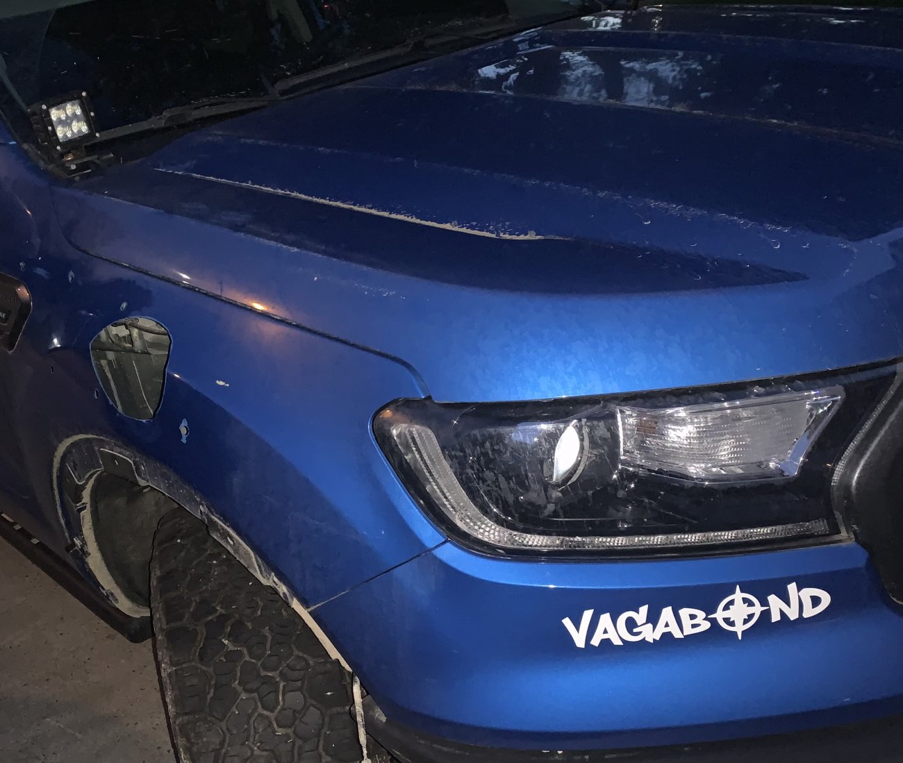

I cut a big hole the passenger fender…

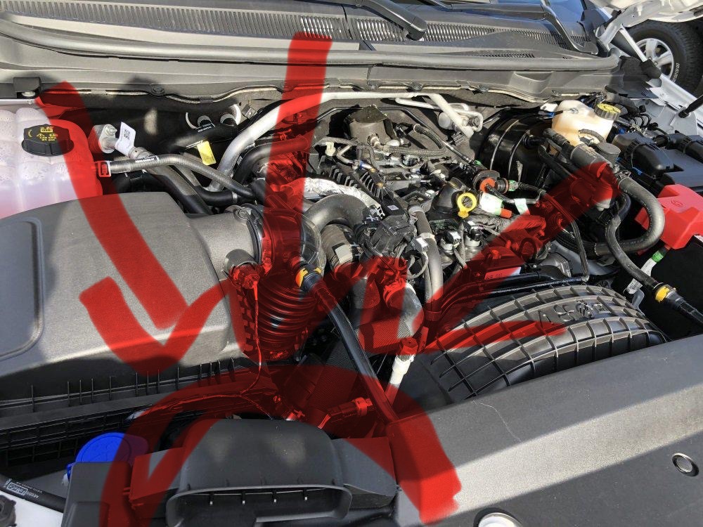

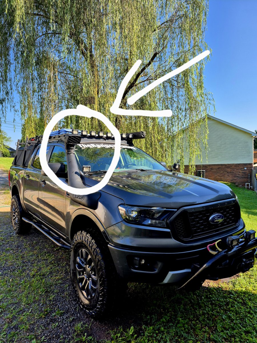

I don’t have a CAI. The Ford tune comes with a K&N filter.
Oh. I thought it came with the whole CAI. Well disregard my question haha
Doesn't Ford provide CAI from the factory any more? My 93 had it.
Technically yes. It pulls cold air from the front of the engine. But I know they make high flow air intakes aftermarket and I ASSumed it came with one in the Ford Performance tune he's running. The air box on most are shaped completely different. So i was wondering how the snorkel kit lined up with athaftermarket air box.

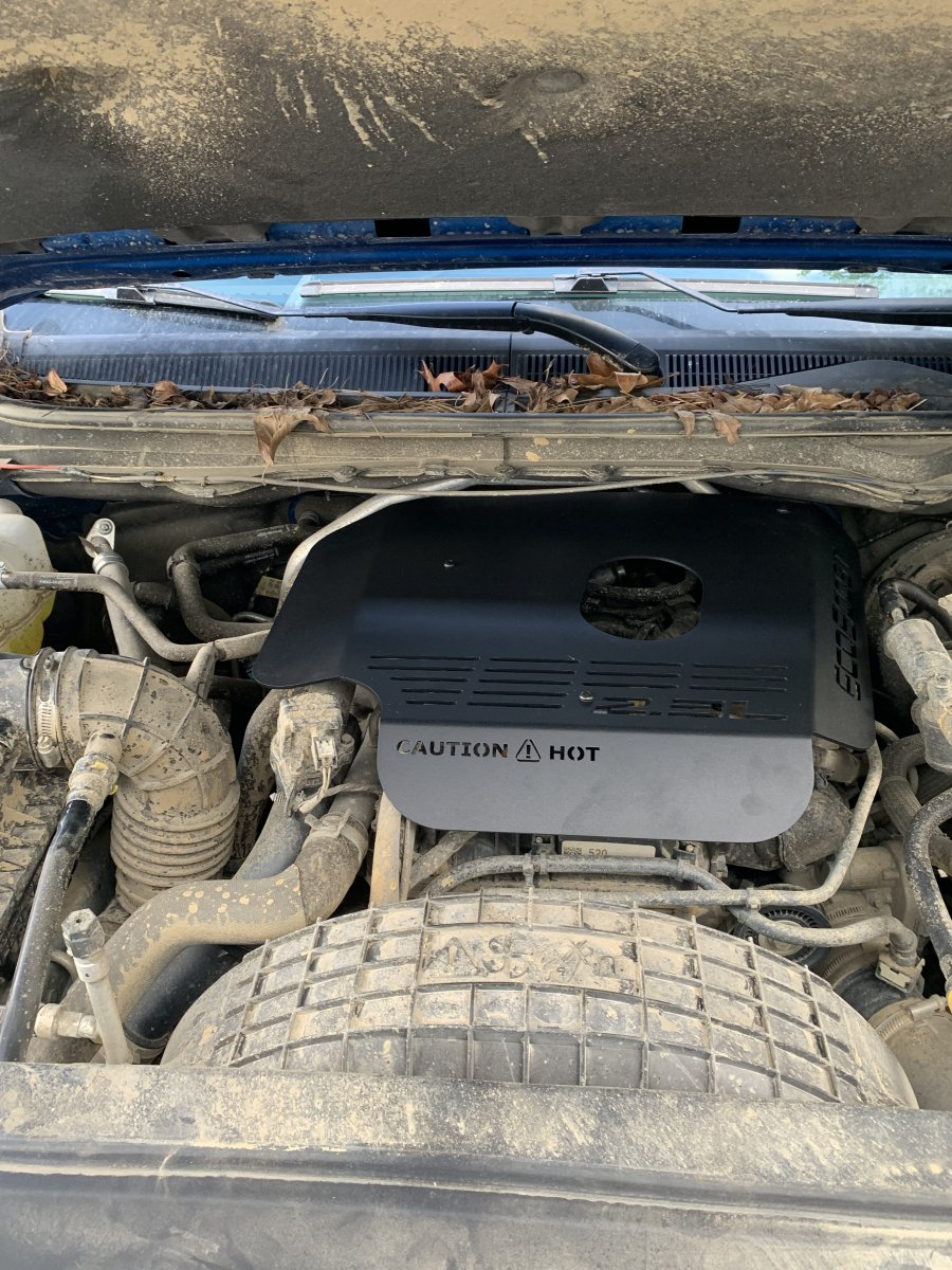

I installed the JCR Offroad engine cover I’ve had for way too long. It’s supposed to help with the water in the spark plug boot issue:

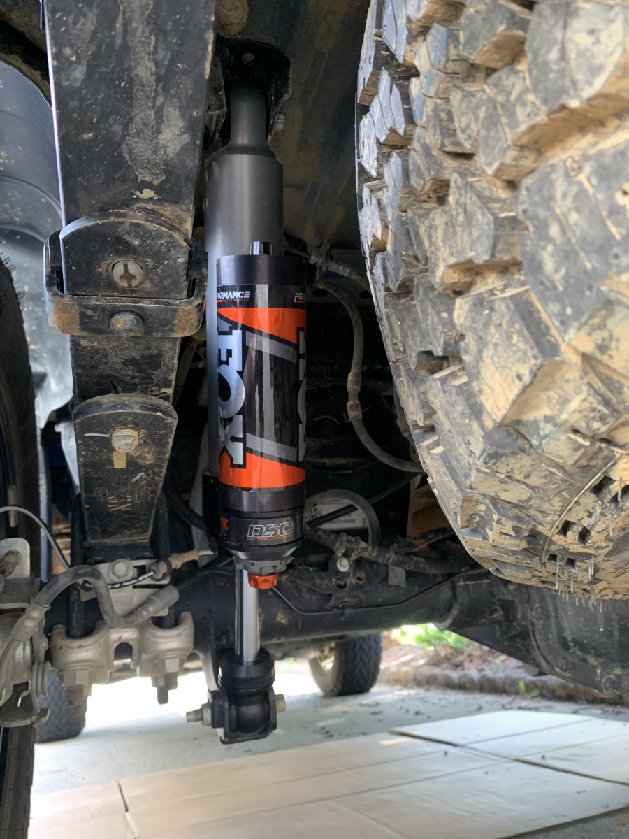

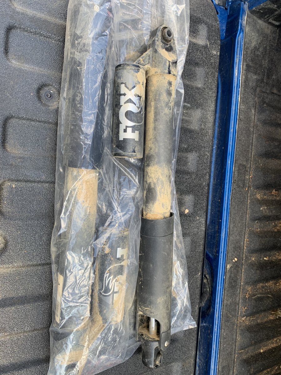

I installed the rear Fox 2.5 piggyback shocks. I had to straighten out a bent passenger side lower shock mount. It looked like it took a few hits in the rocks. I guess I’ll have to build some skid plates for the shock mounts.
Out with the old (10K miles old):
In with the new:
In case anyone ever installs a set of these… DO NOT FOLLOW THE DIRECTIONS. If you do, the passenger side reservoir will hit the upper mount at full droop. If you turn the shock 180° the axle tube will smash one of the adjusters. You need to loosen the piggy back lock nut and rotate the reservoir 90° toward the middle of the truck.
