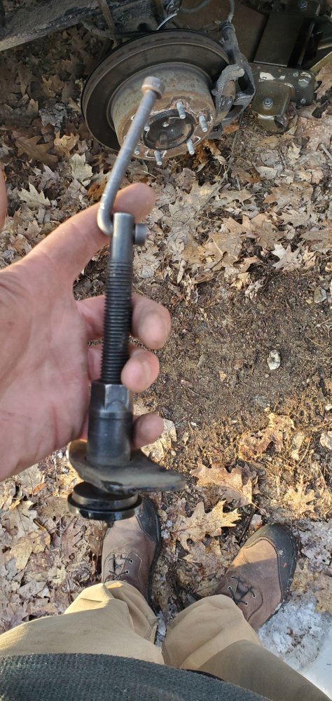

Tried to do a padslap on the rear today, just ended up getting right pissed.
Couldn't get the piston to compress. Absolutely will NOT spin clockwise. The apex of my "shitty day and way too late to be dealing with this" rage come about when THIS happened 🙃
What's the G.D secret to getting these rear pistons to compress? I know I must be missing something stupid and I'm probably getting pissed for no reason... I even cracked the bleeder to see If that would help... nope... just made a mess.
Ok so from what I'm being told, the drivers side pistons on the new trucks depress counter-clockwise, and the passengers side clockwise.. apparently.
This makes the harbor freight kit i have 100% useless for the drivers side of the vehicle 😑 😒 as it will only depress a piston if it's wound clockwise. Stupid. Looks like I'll have to be off to find the type that goes on the end of a ratchet tomorrow morning and hopefully get the pads changed before it starts to rain.

You are correct. The kit I have has an adaptor for each side. I think they might even be marked for which side they go to but if they don’t, it doesn’t take much to figure out you have the wrong one.
Alright, gonna make those pistons my beetches today. Day off work. Up nice and early. Actually ate breakfast too! Weeeoooooo
I finally finished right at noon, used the cube tool. Complete nightmare trying to get enough pressure on the pistons with the damn calipers mounted in the truck... needed to crack the bleeders pretty much wide open before they would budge. Honeymoon phase finally over after a little over 2 years 😔
