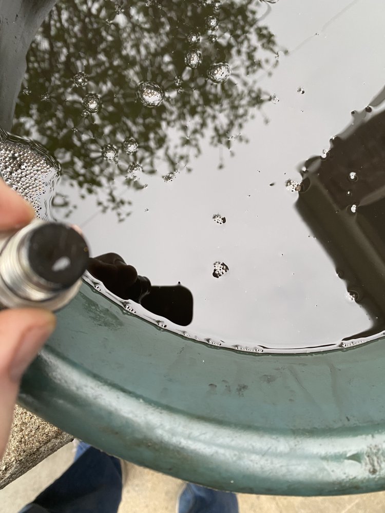

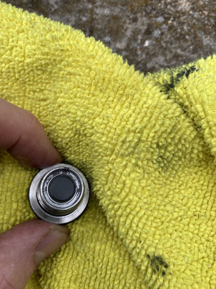

Changed the transfer case lube. Used Redline D6 which meets the Ford Spec. You need a hex key for the plugs, not a 3/8” drive, and a cheater pipe to loosen them. Only the drain plug has a magnet so don’t mix them up. Based on past experience with my other trucks, as expected the old fluid looked like tar.

What size hex?
Take an 8mm and 10mm under there with you and I bet one of them will fit.
Probably. My hex drive sockets are pretty limited. So just making sure I have what I need. I have more allen wrenches, than hex drive sockets. I’m not sure I have one that big though. I guess I’ll find out...
I just checked, it fits perfectly in a 3/8" socket and wiggles a little in a 10mm. The plug isn't a square drive though.

I needed a cheater pipe on the end to break the plugs loose though. Spec says torque to 20 ft/lb but they were on a helluva lot tighter than that.

Honda did the same thing with the rear differential fill and drain plugs. We called the installers the Honda Gorilla. We always told people to make sure they break the fill plug FIRST before draining the fluid out of it or you might have a dead in the water vehicle.
