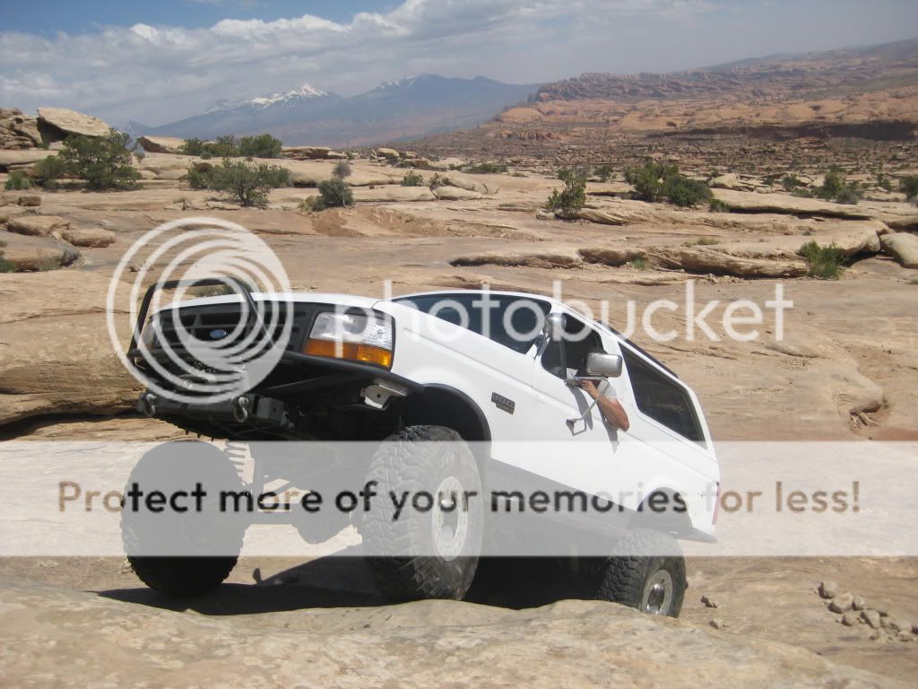

i use wildhorses 5.5 lift progressive rate coils with an extended radius arm ballistic joint setup and heres how well it does.
personally im looking for more flex its embarassing when im getting beat by stock width jeep yj

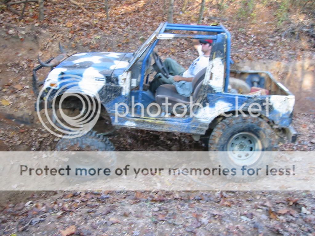

My old zuk with leaf springs
wow that looks really good, i wonder if the bronco graveyard coils rated at 190 would be way too soft. i bet those duff 5.5 probably stil handle good on the road to.

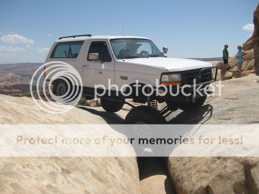

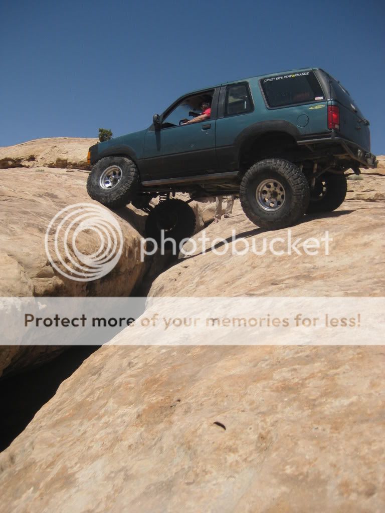

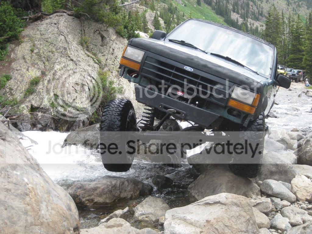

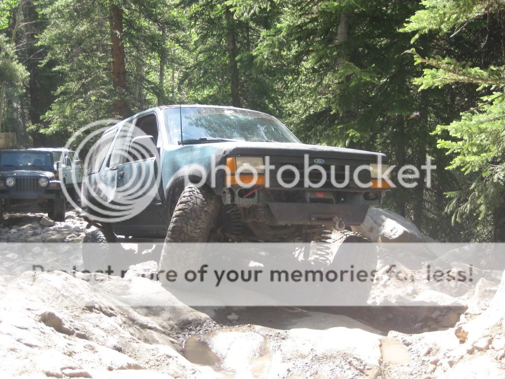

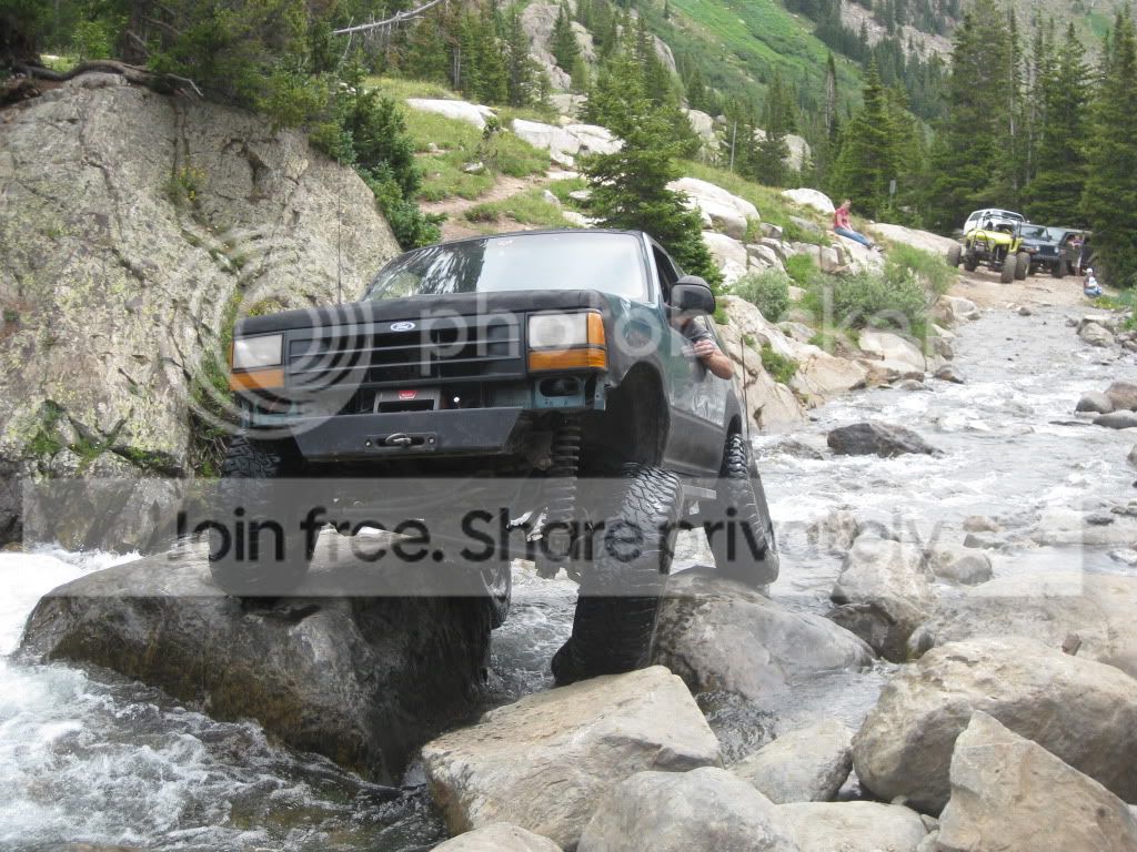

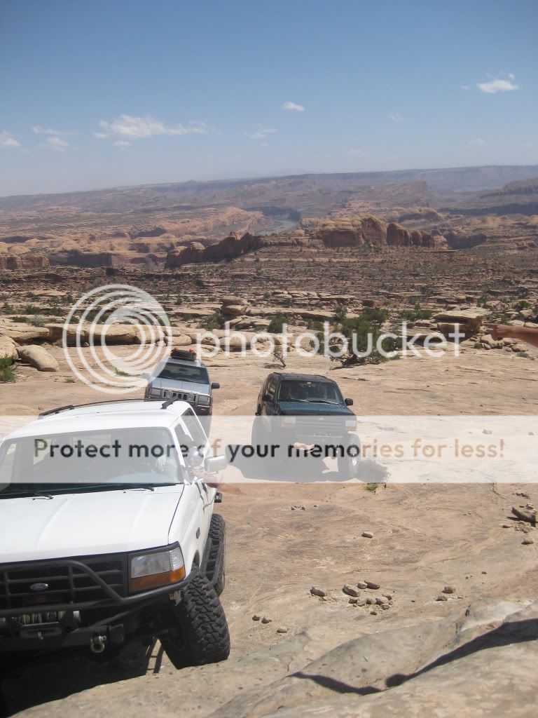

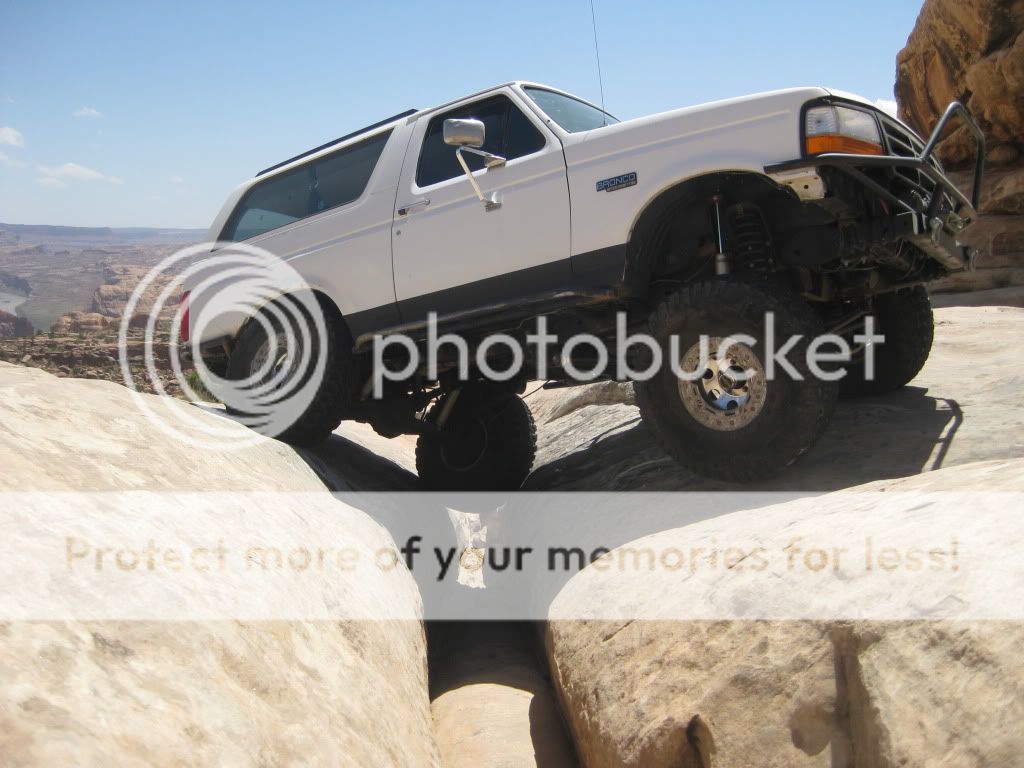

I ran WH coils on my sploder and I thought they sucked. The soft "progrssive" first part was too soft and it sucked it up too quick. Then the stiff part is just too stiff. I installed some superlifts too and they sucked. Then I got some BC linear rates and they were soft and handled well. Flexed sick. Here is some pics with the BCs. I had the longest ones they made mounted with full length f150 buckets in order to get a long coil w/o too much height.
And all that flex isn't so much useful? I would sooo much rather drive it on the trail with some wheel travel rather than with no flex. The lines you can take because it doesn't unload and try to flop or refuse to climb. Totally not useful...

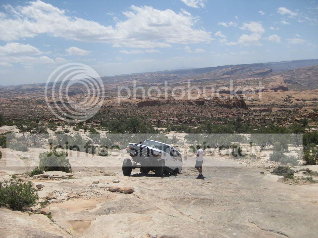

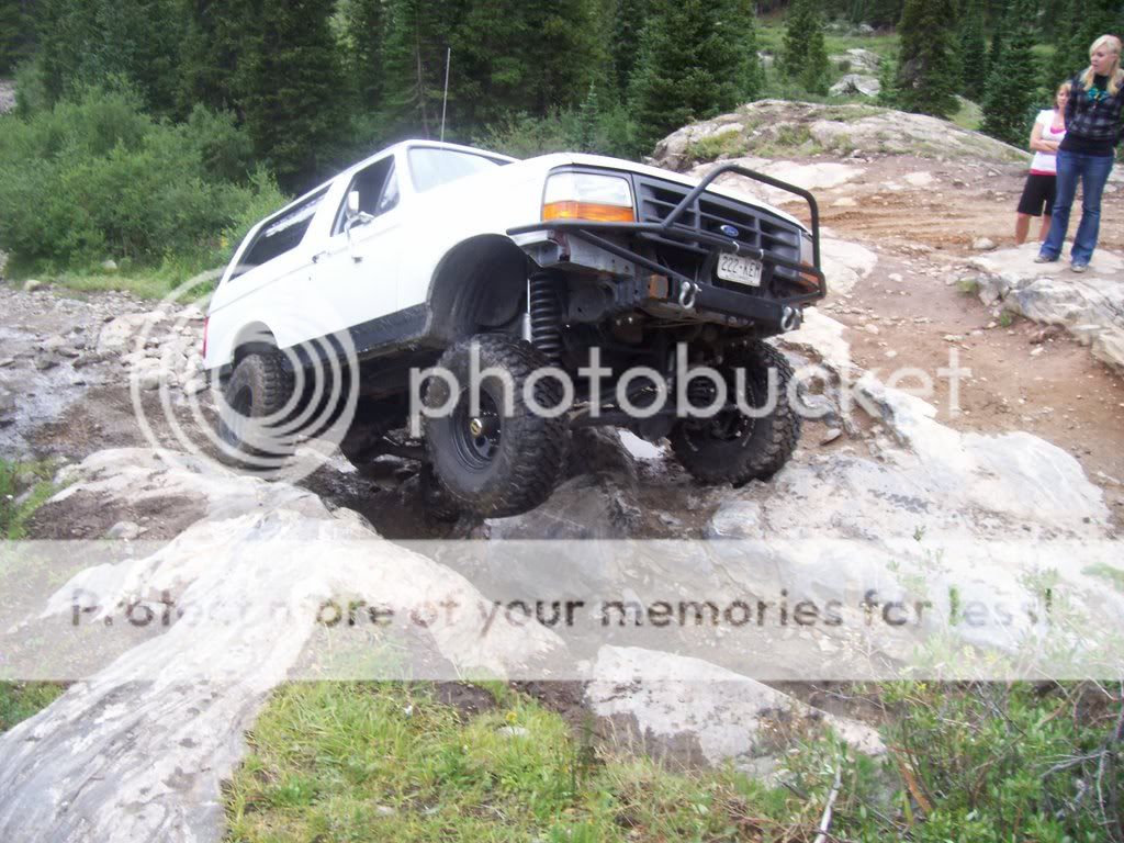

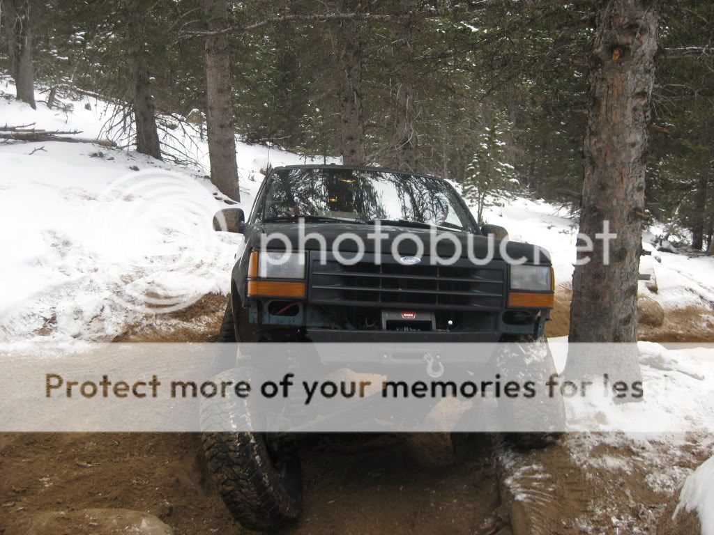

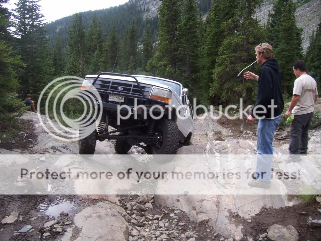

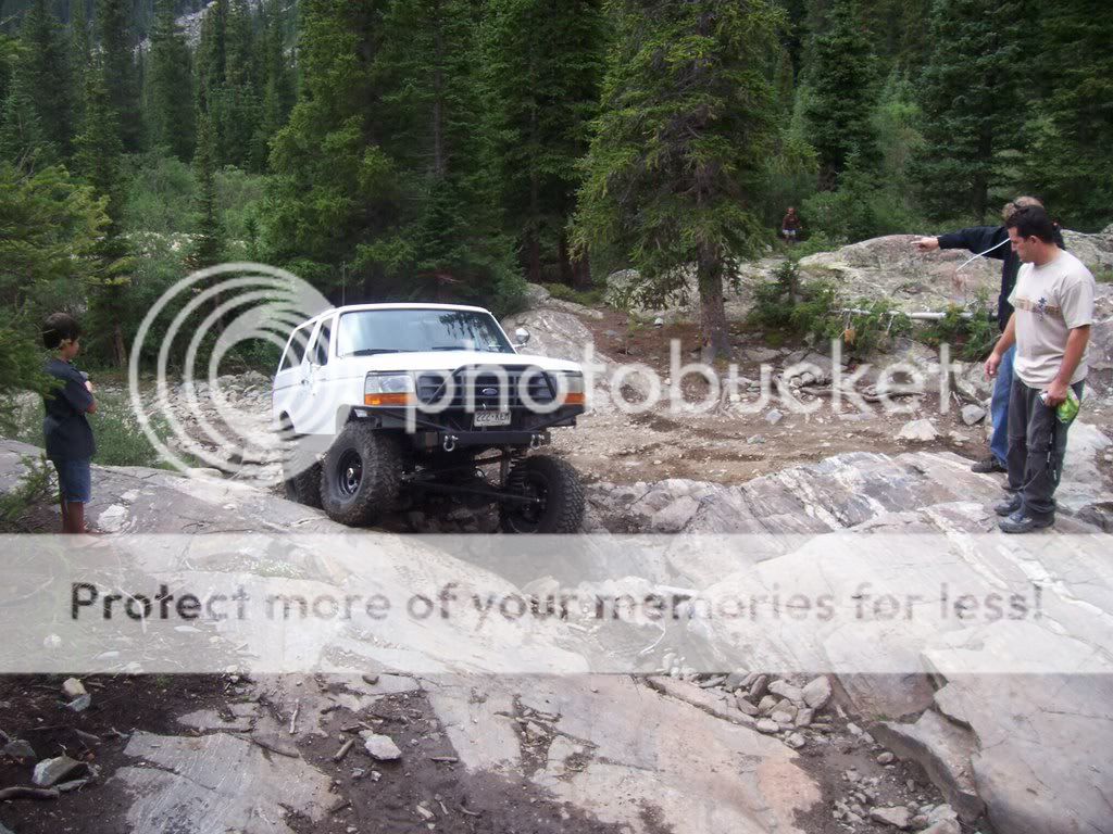

Here is some pics with deavers on my buddies rig we built. They would travel if you forced them, but way too stiff imho. Deaver used to make some that were around 200 lbs spring rate. The ones they make now are like 300. Great for the street. Suck for travel. His is even way heavier than yours.
We replaced them with BCs longest ones. Now it travels and he is not sweating bullets when on the trail. The front end flex is now an asset and he can approach obstacles without compensating for it.
