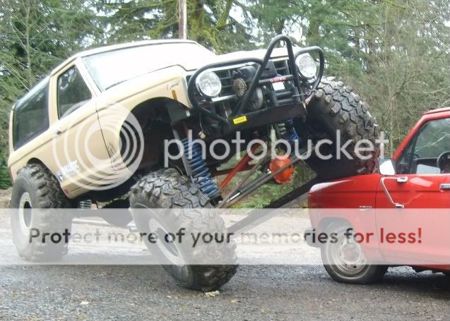

wow, all of these photos are impressive does anyone know the rate of the bc coils?
ya there is alot of good flex shots here!
