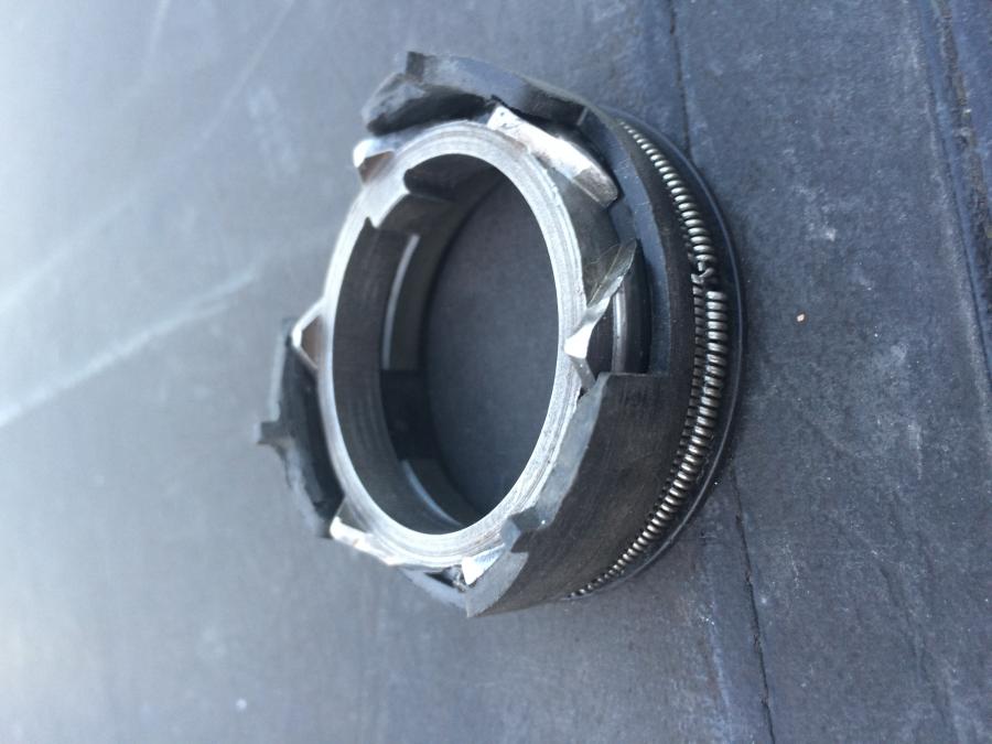

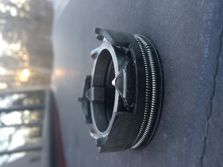

1997 4x4 goes on the front hubs. Put new bearings in the front rotors. Passenger side is cracked and the driver side has a groove. 4x4 doesn't want to unlock. These are automatic locking hubs. Going to try to add pictures. Do these come from Ford or can the be purchased at another parts store. If you have a part number and know what its called it would be greatly appreciated. Thank you for any help in advance. VIN#1FTCR11X6VTA31070

Locking cams.
As far as I know they are not available separate. You have to buy the entire hub. Thats what fails in the auto hubs. Its been a while since I had the auto's (and it may have changed since), but that is what I found when I tried to replace just that part....
Thank you
Wanted to say thanks for taking the time to help me out. Now, The search is on:headbang:
I got a pair of Warn manual lockouts at U-Pull-It for $10 with all the guts...
good deal
I think the closest one to me is about 4 hours away. I got up with the guy I bought the hubs from. I think he may have a good set. Won't know till tomorrow everything is covered in snow and ice right now.
