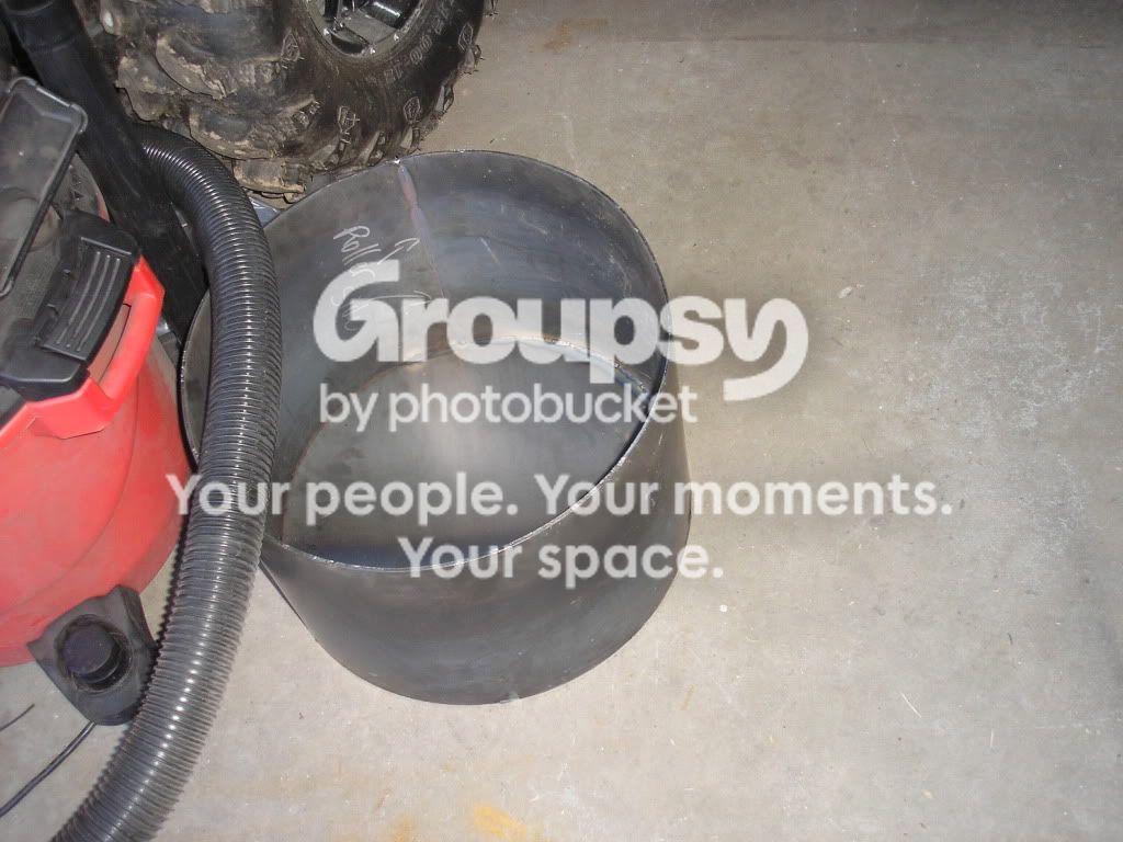

Got started:
This is the half-welded fire box. It's what will hold the burning charcoal and choice of wood.
I used a template and the drag tip on the plasma cutter to cut these perfect circles (not done making a circle burner yet......). I then eyeballed the 3 holes for the flange I'll be making. Not the same as what PM made, but I believe that this is better.

Looks great - one suggestion - If you get an extra piece of sheetmetal and bend it so that it can just sit in the bottom 1/3 of your firebox, most of your ashes will fall on it and it makes the firebox much easier to clean out. It will also make the firebox last a lot longer too.
I was thinking of lining the bottom with stove bricks, plus it has a 2 3/4" dampner at the bottom too. Should be easy to clean out.
