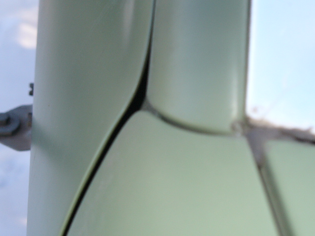

had same problem on my '83. filled the area where the hood, cowl, and fender all come together with adhesive sealant (Permatex black) and problem fixed. only the passenger side was leaking, but i did it to both sides just in case.
Do you have a picture of where exactly you had repaired it?
