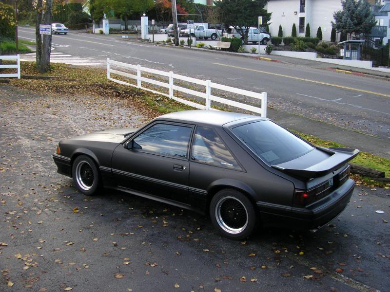

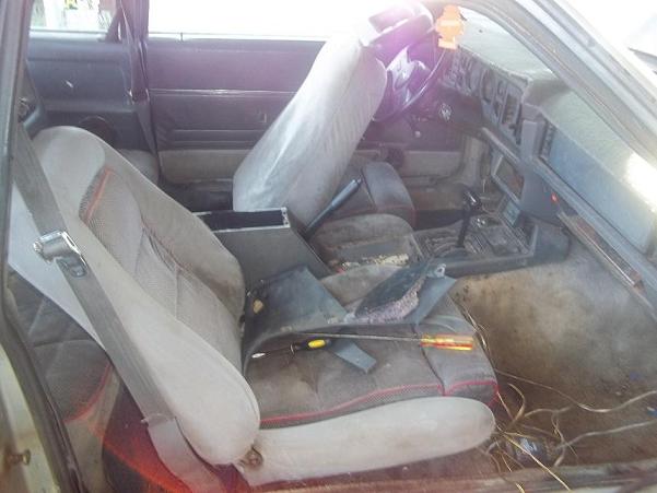

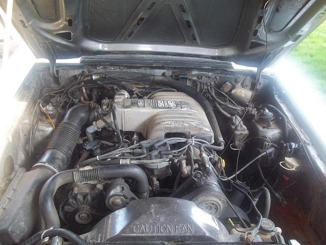

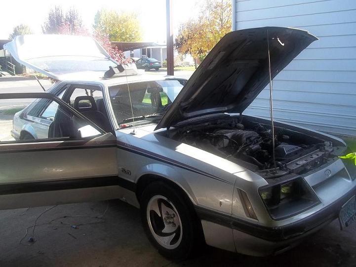

i bought a 1986 ford mustang 5.0 gt new project :yahoo: just going to clean the hell out of it and make it run p.s i only spent $250 to buy it heres some pic i might make a build thread but its really going to be slow thanks for looking and the black one is what my plans are for paint any suggestions helps alot

The unfortunate thing about an 86 is they are the only year that had the E6SE heads, which were the same heads that came on Crown Vics. This meant they also used different pistons. So aftermarket heads are kind of an "iffy" deal. However, there are several people who have used production (meaning off a Cobra or 5.0 Explorer) GT40 or GT40P heads in unison with the factory cam. In other words, I don't suggest doing heads and a cam, just heads. Don't bother with the E7TE heads, they will be a waste of time. I have the P heads, and love them. I got them for about $200 off a 67,000 mile Explorer. If you get higher mileage heads, I would change the valve springs.

Also, I would suggest taking the intake manifold and 65mm throttle body from a 5.0 Explorer. They flow much like the 93 Cobra manifold. And if you use P heads, you need certain types of headers due to the revised spark plug angle. I can help point you in the right direction if you go that route.

I have an extremely nice rear seat out of an 86 GT, in case you get to the point where you might want to replace some of the interior. It came out of a 40k original miles car. I also have 3 front seats (2 passenger, one driver), but they are in the same shape if not worse than your current seats. You would be surprised at how good those seats will clean up with a good shampooing and gentle cleaning.

can i get a pic of all wires going to the starter Solenoid Switch i think the person before messed it up cause when i turned the key nothing happens at all thanks
