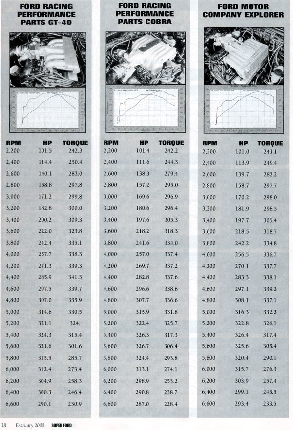

Here's some flow numbers of the GT40, Cobra, and Explorer intake manifold.
Before I had the pistons fly cut I would just get new ones with valve reliefs already in them, especially with any high performance hopes. I mean, you already have them out, subract the cost of a machine shop machining the pistons (and possibly weakening them) from the price of new and I doubt they are too far off.
Really, all things considered... the cheapest route would be to get this thing running and put out feelers for a low mile nice running Explorer 5.0 if you want to make it really RUN.
