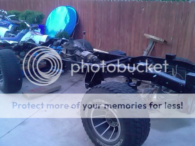

look i swapped an 88 bII body onto a chevy 3/4 ton frame. it was easy.......sticking with rbv components will be a walk in the park. if you don't hava body lift here's how i did it (by the way i bought this body from a junkyard for $200:
it was easy
and the body mounts are in different places from ranger to broncoII because the broncoII is an suv body (so the frame is sraighter under the back-seats) and also since a bII is much shorter in wheelbase the mounts are in different places. but that is easily fixed, grind off the rivets holding the body mounts to the frame. and then you can move them to the needed places and drill the holes where the rivets were and use grade 8, 1/2" bolts (just as strong, if not stronger than mild steel rivets) or you can weld them on, or if necessary build your own brackets to weld on like i did look and see i built pedestals on the rear to raise the frame up to meet the body, and i built brackets for the middle/front mounts too that i welded on:
Hey thanks! I think thats what I'll try and do. Find a cheap 89 body put it on there then put my 88 doghouse on it to make it look good.
