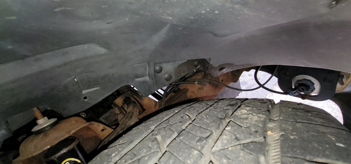

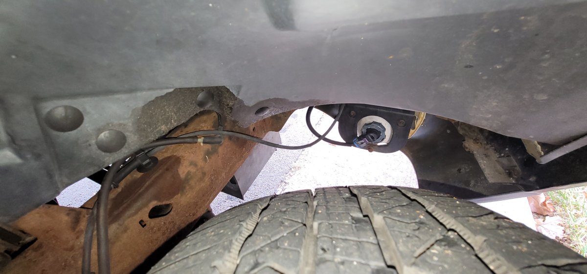

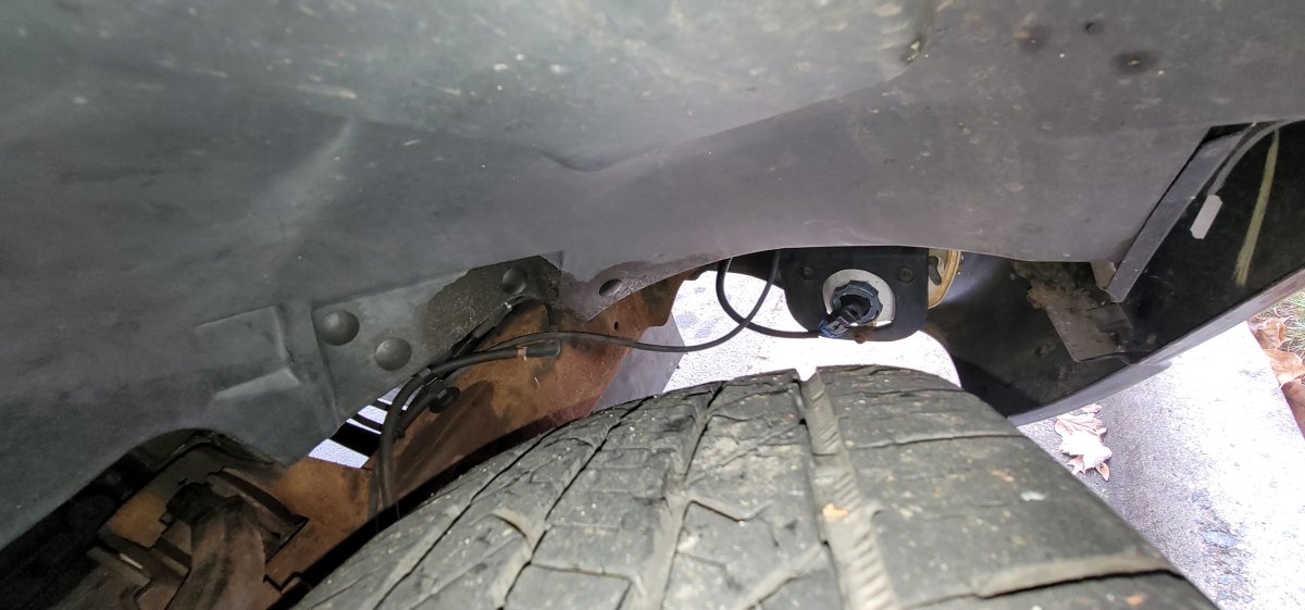

Weird wear in center of front tires only

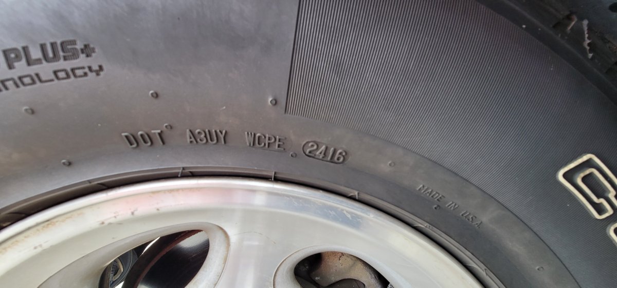

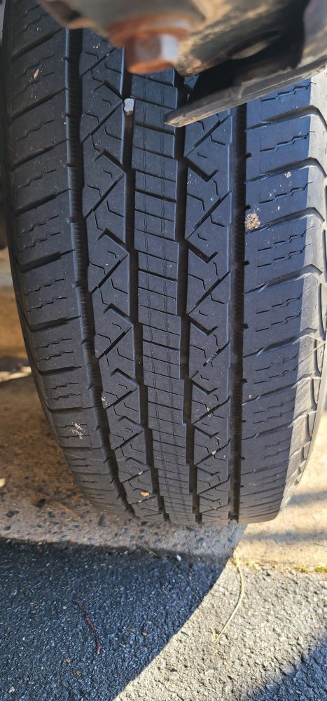

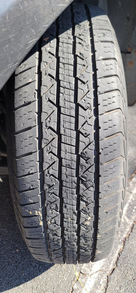

I sent the pics to a friend who's been in the tire industry for 35 yrs, this was his reply. Capture+_2024-11-07-14-35-35(1).png
That's an interesting "casting blame".... not being hostile, but it doesn't sound like the right answer to me. I've read the professional tire sites claim that as well, but I still don't buy it.
I grew up on a farm, and every vehicle we had drove dirt roads almost exclusively until I turned 14... I could name 6 fullsize ford trucks, 2 buicks, 1 jeep (wagoneer), 2 or 3 ford cars, and so many tractors I can't even name em all (almost all John Deere, but a few Newholland)... never have I seen anything even remotely like that from dirt roads, even during the winter when you are driving on frozen razor blades. When I turned 14, we switched schools to a place 30 miles away and the cars got 30% pave, 70% dirt - still none of that.
I've seen tractor tires throw chunks like that but they were 30 years old and sun rotted 365 days a year, they were just chunking out from old age. Most of that was outer edge, especially if you drove over a big rock.
The one time I have seen tires chewed up like that was brand new freshly rolled macadam - like following behind the steam roller fresh, across the whole tread though.
I sent the pics to a friend who's been in the tire industry for 35 yrs, this was his reply.View attachment 119943
That's really interesting. I can't remember driving on the dirt. Maybe when I first bought the truck. But not often and not fast.
Why front only?
I’d bet that the answer is not dirt or gravel roads since we have already established that dirt/gravel is not in your daily or even weekly travels. If I had to guess, it’s probably a poor quality rubber or defect compounded by turning your wheels on pavement without moving and possibly a little too much tire pressure. People have forgotten how to be analytical and ask relevant questions to establish an answer and have moved to just blaming something.
Sitting in one spot on pavement and turning your wheels puts stress on everything and you are concentrating all of the vehicle weight on your contact patch. This can easily put wear on tires, especially when it’s hot out and the pavement is hot because you can actually tear small stones up from the pavement at times. I was taught to try to do as much steering as possible while the vehicle is rolling. I often palm the wheel and usually can go from lock to lock in less than two feet rolling slowly. If you have the window open, radio off, and good enough hearing, you can often listen to your power steering pump. Listen to the sound it makes turning while still and turning while rolling. It will be noticeably louder turning while sitting still because it has to work harder.
Super common here, especially on 3/4 ton and heavier trucks. The gravel just chews the tread away.
"dirt roads" is kind of a blank term. Dirt itself doesn't really wear tires very fast but some people call gravel roads "dirt roads". Crushed limestone does chunk out tires. And lesser street tires gravel will puncture outright.
And grades of gravel vary wildly too, for awhile my county was getting a more yellow/orange limestone becuase it was cheaper. It also broke down much faster becauese it was softer and even stained white vehicles.

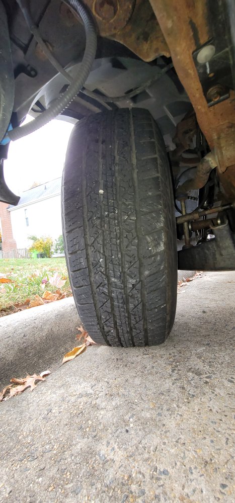

But here's another thought I'll throw out based on the wear. Could it be overinflation + worn/bad front bearings? Worn bearings can give some crazy wear, even if the truck isn't driven at highway speeds to make vibration noticeable. If not the bearings, check suspension bushings carefully too. Also, that frame is pretty rusty. Wouldn't hurt to check it while you're looking at the suspension.
Thanks for these thoughts.
I've never overinflated the tires. If anything I have not been great at keeping them at 30 psi. Very slow leaks that I should keep closer attention. But... life.
I will definitely check the bearings and bushings. I did a lot of engine work lately and had the front wheels off a few times and didn't notice bearing play or noise. But I wasn't looking for it either. So I'll check.
The bushings could definitely be original. 240,000 miles. So yep I'll look there.
I have a couple quarts of por-15 in the garage for the frame. Lots of surface rust but the underlying structure looks sound.
