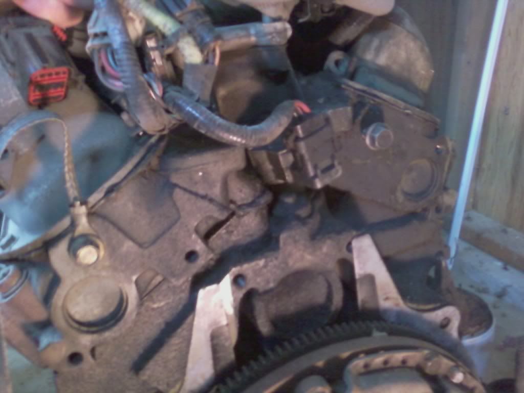

Here's a picture for you. that's a 1993 4.0 I have laying around. I've never seen a aluminum hose on the back of a 4.0. maybe you have something aftermarket. trace the hose and see where it goes
Hey Kylan, what is the thing plugged in just above the flywheel in the center?
yep cmp, only on california emissions models
