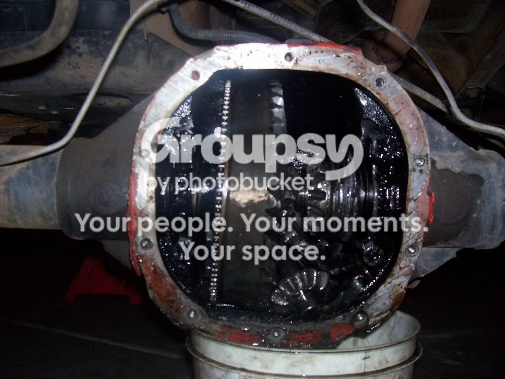

This was my Traclok Carrier
Needs an ARB
I was on 37s with 4.56s. Stock tired 4.0. I was going donw the road infront of my house when it gernaded and blew. Locked it up almost solid. I ended up building another housing for it with a BTF cover and Ruffstuff brackets. And, of course I welded the tubes to the cented section. I have spun a tube on an XJ and I will not do that again if I can help it.
yep you blew that up pretty good
dadgum!! Thats some pretty good carnage right there!
